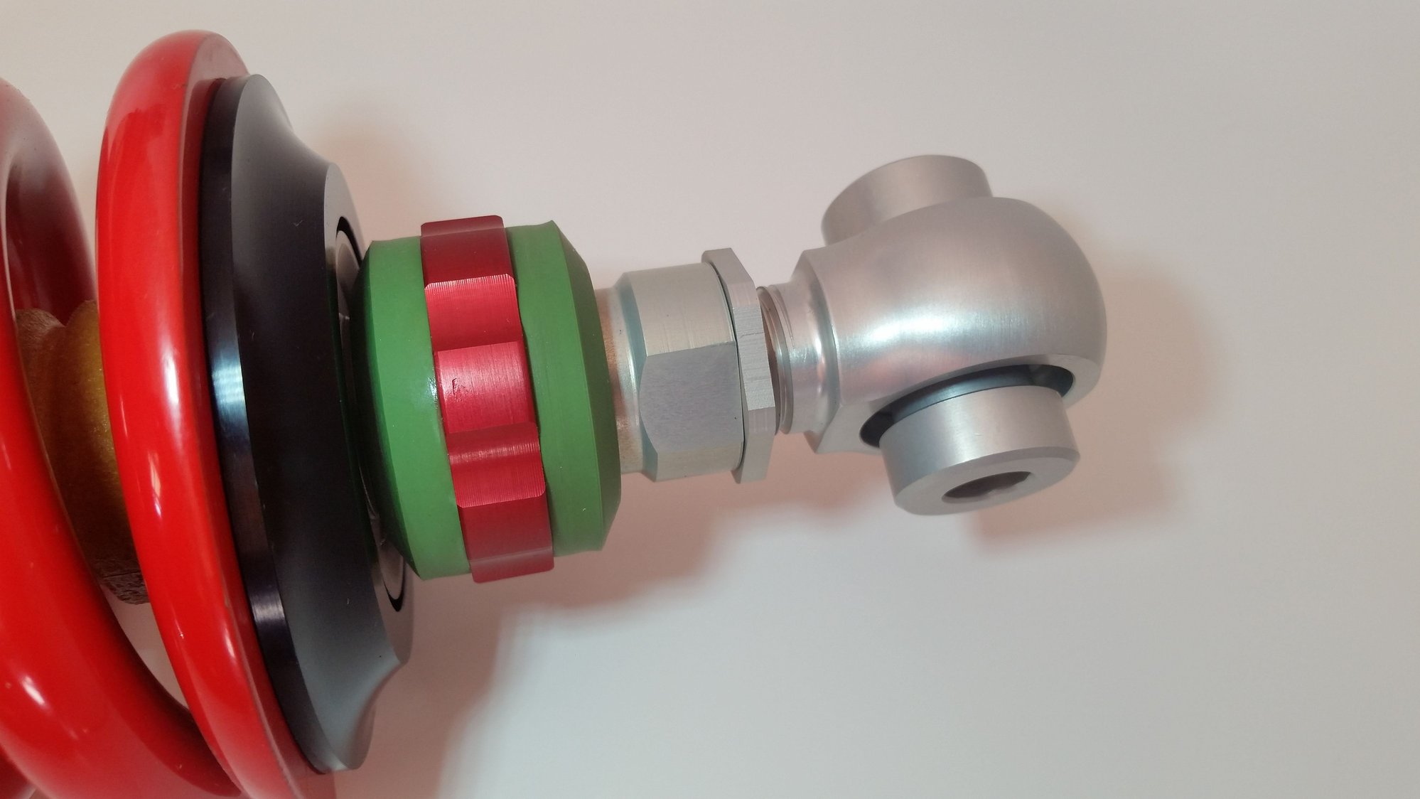

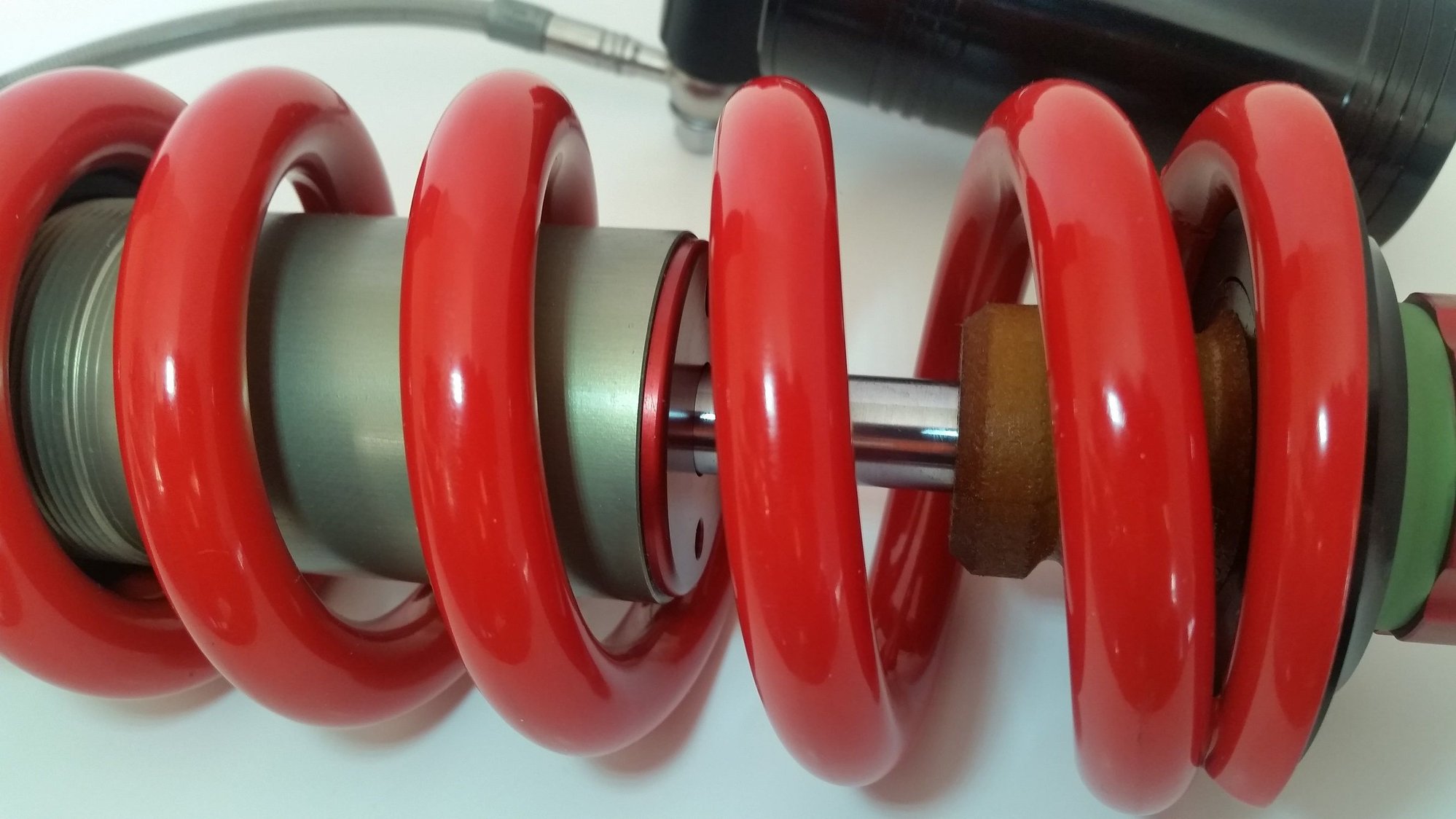

This is really exciting news for us here at DMr - last month we released to the public our new shock, coined BD40 Series.
A very brief back story: when I started this business over 19 years ago the dream was to build my own shock design. At the time getting ready to start a family, was still in my 20's, etc.......so things were different. I decided to start slowly and employ the crawl-walk-run philosophy. That worked great, except at the walk stage I became very busy and could just about keep up with workload. That was a real blessing and I'm still thankful to this day. However, success sometimes has a negative side, in this case it was distracting me from the original dream. I had been looking at the shock design on the computer screen for over 10 years but hadn't made it a reality.
Fast forward to 2017 when I made a conscious decision to transition our business and focus on our rear shock design. Then about 6 months later I moved the shop and that delayed things again. I pushed hard during 2018 and made it happen.
Here are some photos of the final result. Naturally, the VTR is one of the models we are offering this shock for. Shocks have spring preload, compression and rebound damping, and ride height adjustments. A high/low compression adjustment model is on the dyno being tested now and will be available very soon. The list price for the single compression adjustment version is [see website for pricing]. I'm offering them at an introductory price of [see website for pricing] but that won't last long so if anyone is interested please let me know right away.
While our website is being updated please shoot me an email for ordering information. jamie@daughertymotorsports.com I'd also like to hear your feedback on what you think!

Exciting! Shock is to be my next upgrade and this is certainly more appealing than a new Öhlins/nitron etc.
I understand if you prefer not to release this info, and please pardon my ignorance on the product - but would you be able to share more information on the hardware; what the shock is based on/manufacturer of components and other details? Also is this an item a local suspension shop would be able to rebuild in the future or does it contain properietary parts? (I’m located in Canada)
All components are my own design. Most of them machined right here in our Fort Wayne, Indiana shop.
Shock is completely rebuildable by any reputable shop. They could get the service items from us, but the seals are common sizes so they probably already have them.

I can only imagine that this unit will be exceptional value and like the one I got from you transform any bike it is fitted to.
Can you let me know what other models you will be manufacturing this model shock for so that I can let my mates know that they have a very viable alternative to Ohlins etc.

Jamie, Great job! For those of us not so technically versed, what will the High/Low compression adjustment do?
Right now we are offering them for the Yamaha R3, Kaw Ninja 650, Honda VFR750 & 800, VTR, CBR1100XX, CBR500 and CBR650 models. Soon I will be coming out with versions for the Yamaha FZ-07 and -09's.
Just around the corner I'll have a high/low compression adjustment option too. It's on the dyno now and once everything is sorted out I will be able to accept orders for them.
It offers separate adjustment for low shaft speeds and high shaft speeds. In other words, there are two compression adjustment screws. This typically only helps on the track where you are generating higher shaft velocities. For the street you would not really be able to make use of it. It's good for bling though!

Jamie, I was going to PM you but others may need this info as well. What's the suggested Rider sag for the rear?
Old Jan 26, 2020 | 04:43 PM
JamieDaugherty's Avatar
Joined: Aug 2005
Posts: 1,864
From: Fort Wayne, IN
Front = 25-35mm
Rear = 30-40mm
