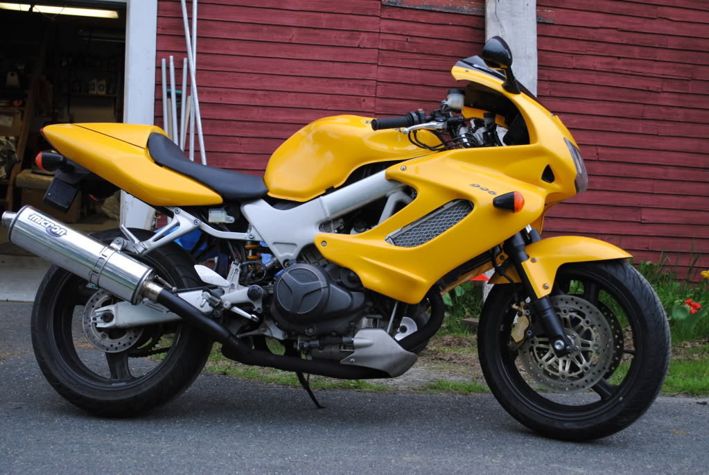

so as you can see my hawk with forks satin black and the exhaust is flat high temp black though had problem with SS mid pipes

this is also one that i did
did the wheels, forks, exhaust foot pegs/ and mounts driver and passenger engine covers center stand kickstand
i also painted that bike as well but just wanted to show you not to rule out Powder coating. these are all dont in a 1970s green household oven. you can fit a 17inch wheel in one but no bigger. i think it cost about 2-300 to get set up with east wood PCing equipment a stove and some basic colors
