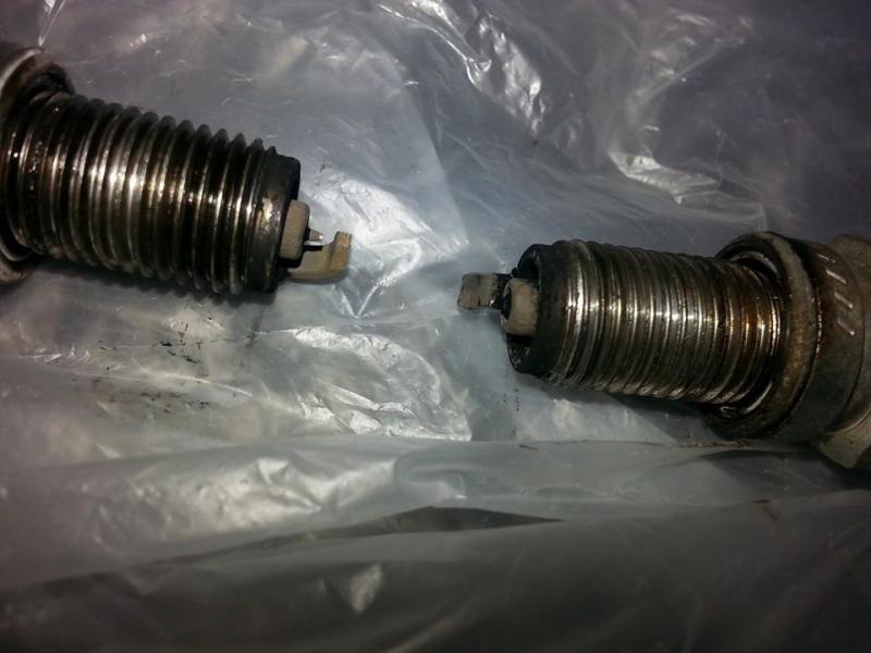

Doing some fine tuning. Decided to check the plugs at a low rpm condition. Was running at 2500rpm then left to idle for about 10 seconds.
Below is the plugs. Interesting that the front one is black and sooty and the rear is clean light brown. Fuels screws were set 2 out rear and 1.75 out front.
Thats a big difference. So have now set them at front 1.25 turns out and rear at 2.25 turns out. Will ride it to work tomorrow and see what it rides like but it looks like for my bike anyway I need to stagger my idle jetting. Maybe 48 rear and 45 front.
Before its brought up, no the tip of my front plug is not missing. It just matches the colour of the wood.
But in the morning I can pin it on the road leading into my work. So I will plug chop it so I can see whats happening under power.

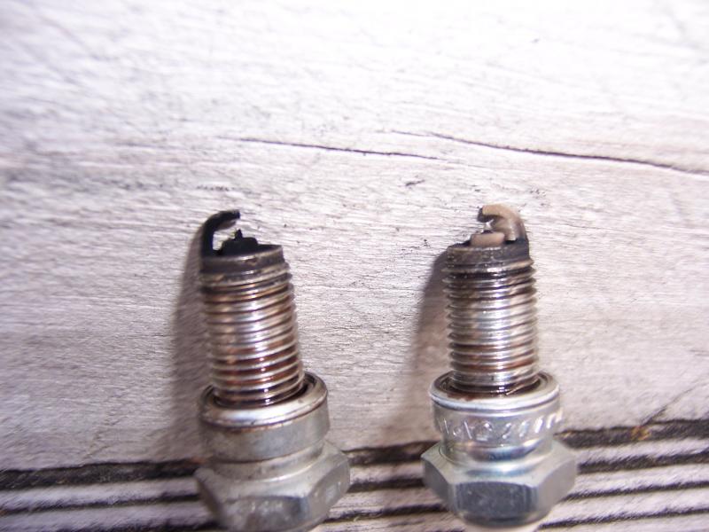

Power run plug chop. Pretty happy with that. Very close. Am thinking down a size on both mains. Was a short power run. Plug heat range looks good.
Attached Thumbnails Latest OCMD project: modded airbox lid-10649699_10203816946837310_1302933005103148107_n.jpg
