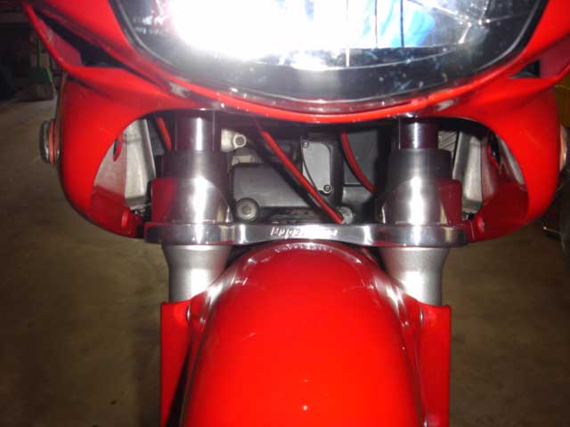

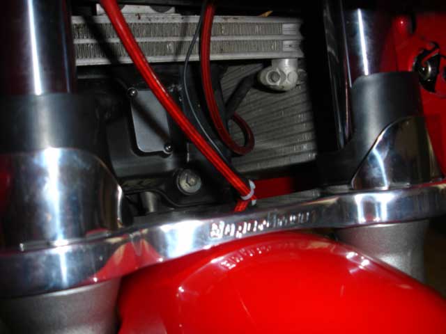

Here is what I did with the stock fork protectors. I took a piece of wood and a hammer and tapped the protectors off like Greg mentioned and then I got some carpet tape, two-sided adhesive, and cut four small strips around 1" in length. I attached the tape to the lower fork and pushed the protectors down and in place. When I put the brace on I got as close to the top of the fender without touching it and that left me about 1/8" to 3/16" to work with.
If this doesn't hold and if you have worked with carpet tape, it is extremely tacky, my next move will be to use a thin bead of clear silicone to attach the protectors.
Here are some pictures:

i justed used two little dab's of gasket maker RVT to hold the stockers on.
