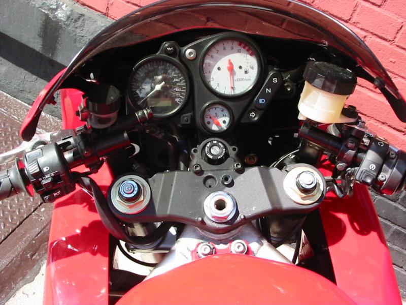

BTW, this is how it looks with the other option in triples... Never mind the dash... That's an optional extra...

Hey whats the story on that dash?? I know you have told it but it is nice. How do you find the spring rate on the CBR forks. I find it pretty stiffly sprung but the stock one was a slush bucket
Old Aug 27, 2010 | 02:19 AM
It's from an 06 CBR 1000RR and what you need to hook it up and "work" is just part of the front wiring harness for the CBR... Then wire it up, wire by wire (I have posted the info/colors somewhere here)... Add a speedohealer to get it to show right, and all of it except the temp gauge works flawlessly... You can get that ballpark right with a bolt in sensor from an aftermarket manufacturer (I'm 2-4 C high) or cut new threads on the CBR sensor... Which I'm about to do...
