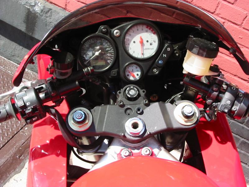

OK, search it is but this is the info I needed to do so. First I am going to try to turn the handlebars around to create more clearance. Here is a pic of where I am now
Woah, sorry... that may have hit another target than intended...
It was meant as a friendly poke at residentg.. Plus I was to lazy to do the search since I didn't need the info myself...
I belive my first reply gives a decent solution to the swap question if you end up needing that... Hopefully not though, a radial master feels quite different from a non-radial... I'd keep that if possible...

OK so I am gonna try the handlebar turnaround & then the stock master. From there I think a 954 or cbr600

this might sound dumb but you ever think of just moving the reservoir to the m/c and using a longer hose to connect them then you could move it farther inward to where the inner end of the clip-on is?
Old Jun 22, 2010 | 10:16 PM
Shockingly, (or not) I not only thought of this, but did it. I made the bracket that held the resevoir shorter to tighten it to the handlebar. But as it turns out, the res is not the limiting factor, its the actual brake lever & how far it protrudes forward from the bar itself. It is the radial design I know, but like I said, now that I went radial, I dont wanna go back. The saga continues
