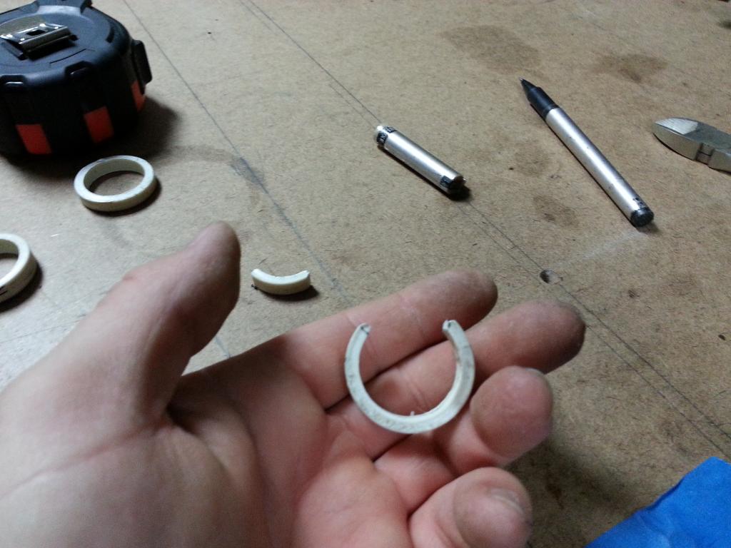

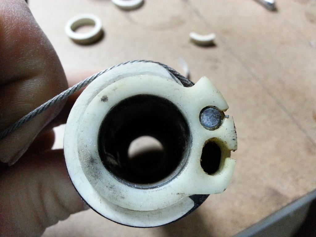

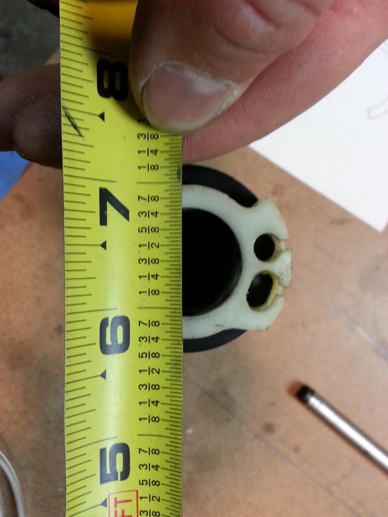

I had an extra Superhawk throttle tube and extra throttle cable, so I took a couple pictures for those that are still curious and haven't done this yet. In the pictures, I used 1" Schedule 40 PVC, however I don't recomend using this if you plan on drilling a hole in it to screw it down. The PVC slightly deforms, which makes the angle of the ramp change. I didn't notice this untill I put it on my extra throttle tube.
Get yourself a 1" Schedule 40 PVC coupler (has a 1 1/4" I.D.) like smokinjoe mentioned earlier he used. Cut it 1/4" long and then make the ramp.
