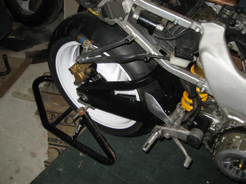

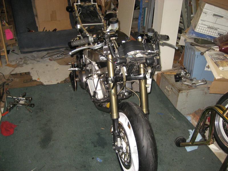

At least I'm back to making progress on getting this done. Got the swingarm back yesterday so I got to actually put something back together last night.

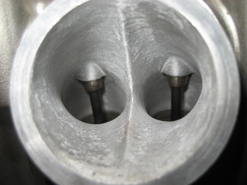

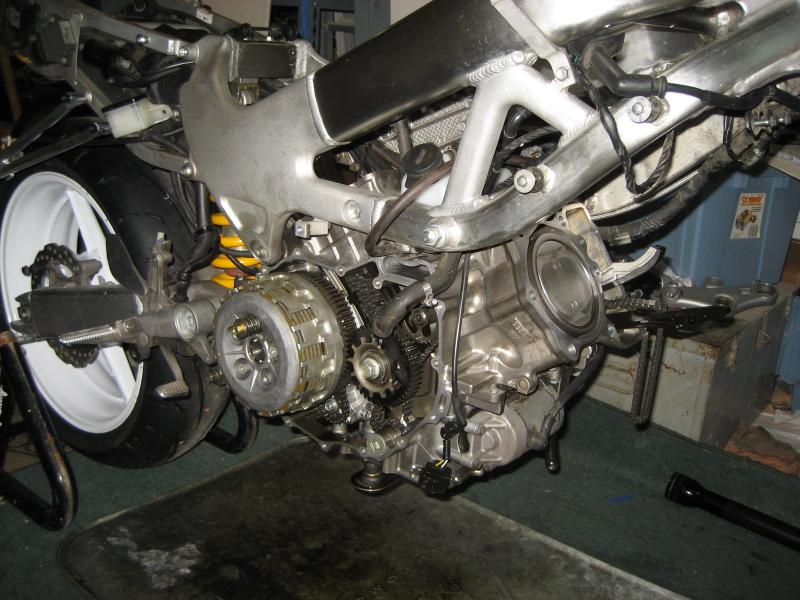

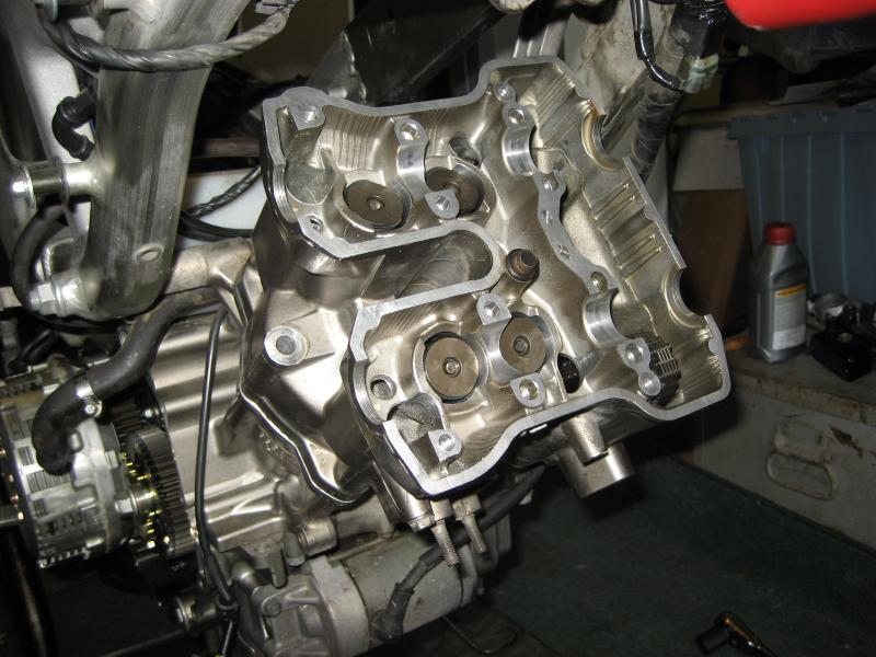

So after my little mishap I had to pull the heads to fix the valve cover bolt hole and while they were off did a bit of port clean up on them.
Then it was time to reintroduce them to their old friends....

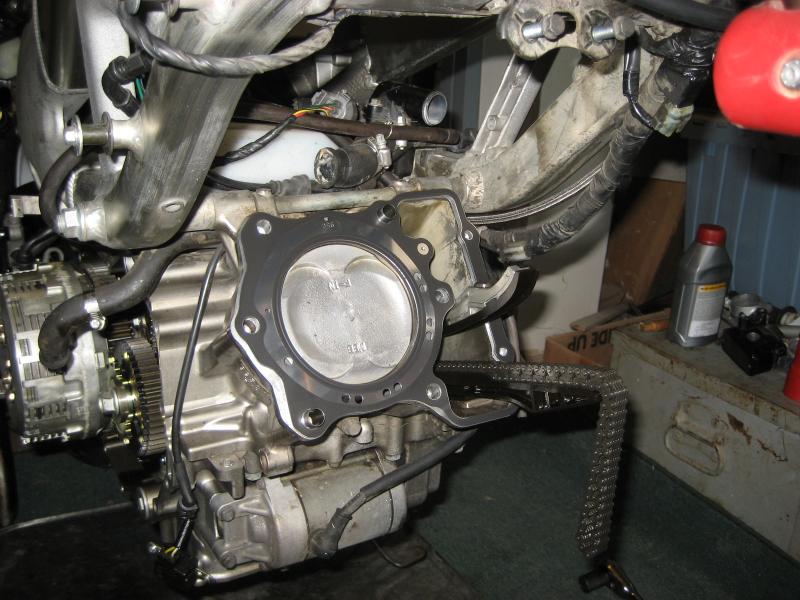

Add a head gasket....
Then add this big lump...

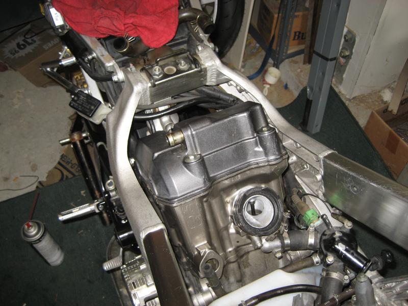

Then start bolting on bits until the parts pile starts to get small....
Front cyl complete....
Time to do it all over again for the rear cyl.

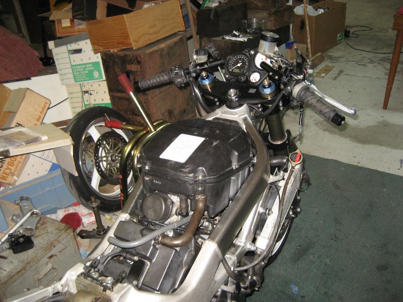

Front and rear done and buttoned up.

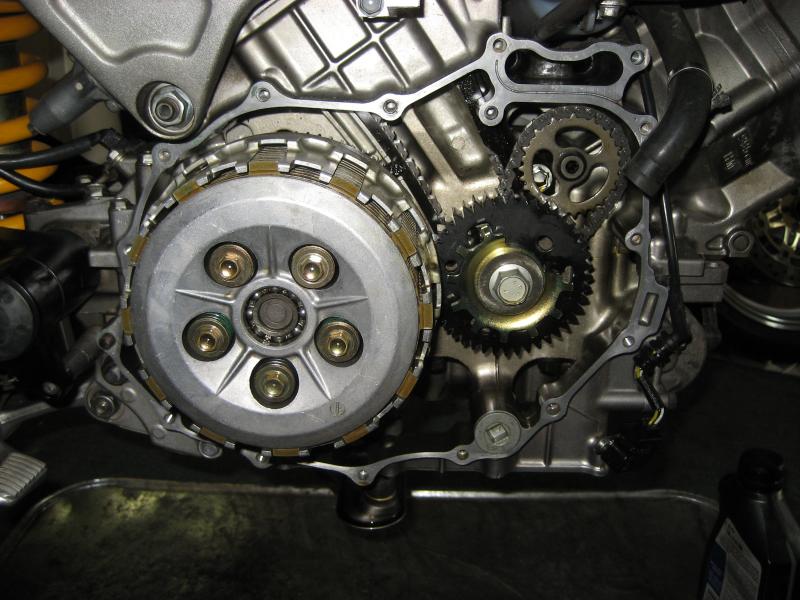

While the clutch cover was off I installed new clutch springs and a 4 degree advancer
The clutch cover can be a real bitch to reinstall, you do need at least 3 hands to get it done...

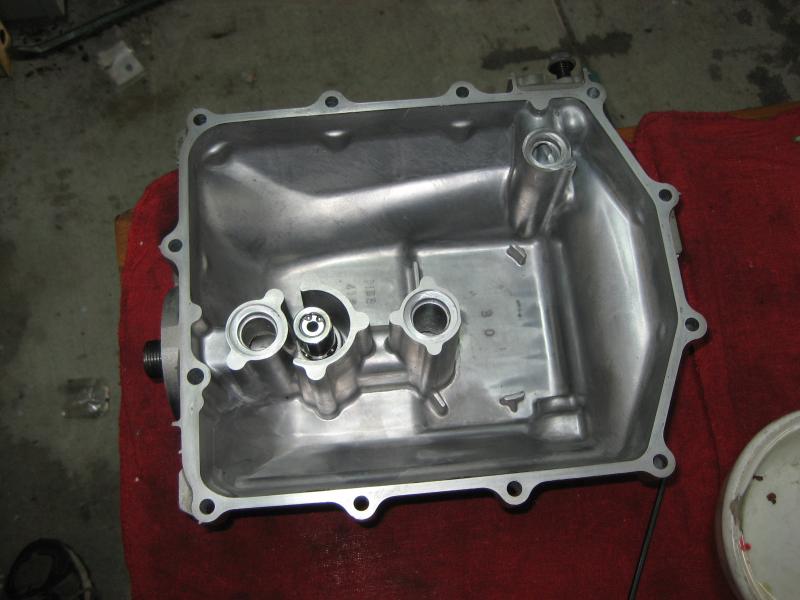

Oil pan prep...

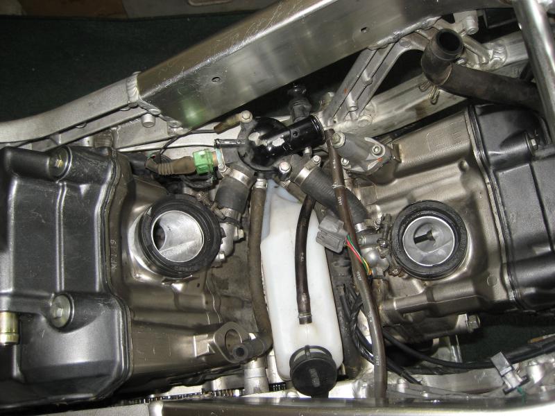

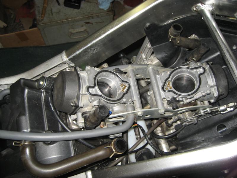

Then it's time to hang the super-sized carbs...
After the intake is buttoned up mount the rads and hoses

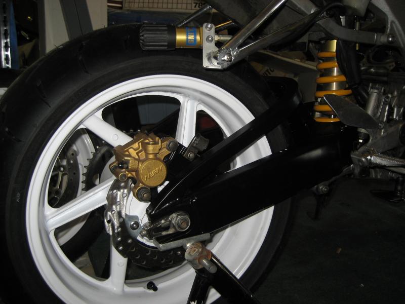

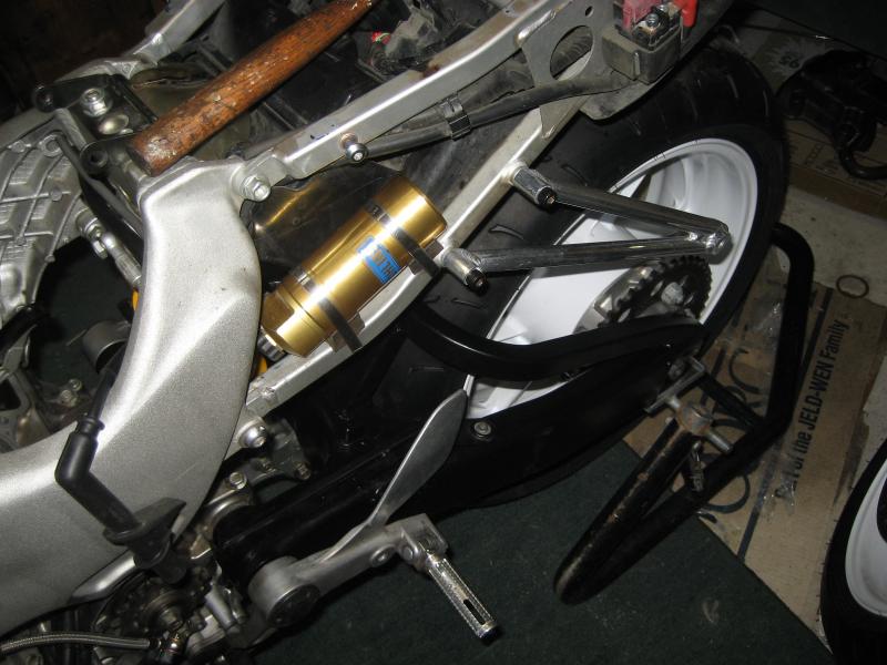

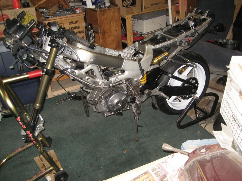

So today was fix the oil leak (stupid clutch cover..... ) and roll her outside to run her for a bit to get the thermostat to open and check the fan for operation. Now it's wait for the chain & sprockets and the rear brake line to show up next week. So it's time to get all the body work ready to hang....... Getting real close

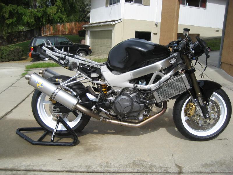

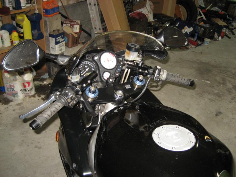

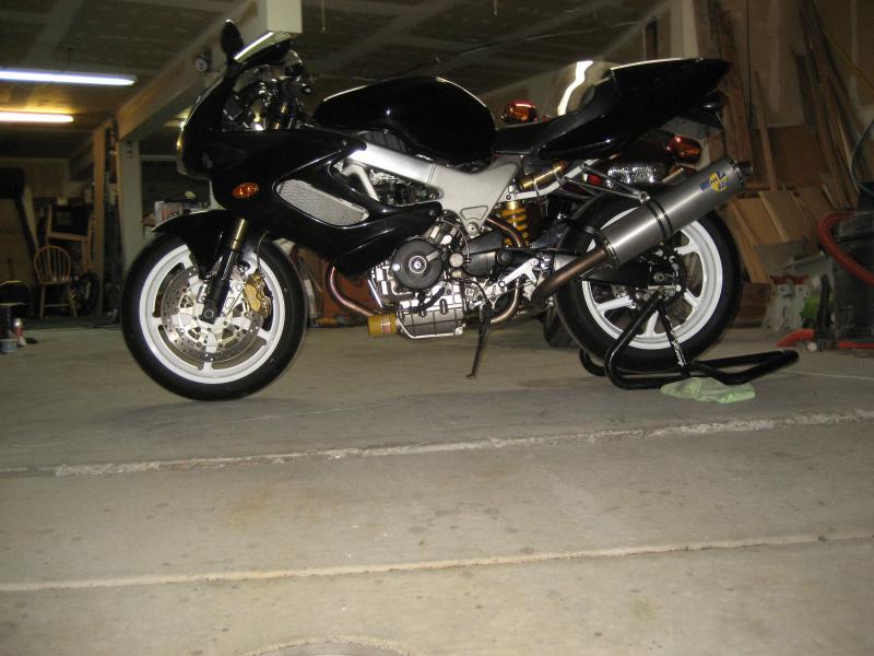

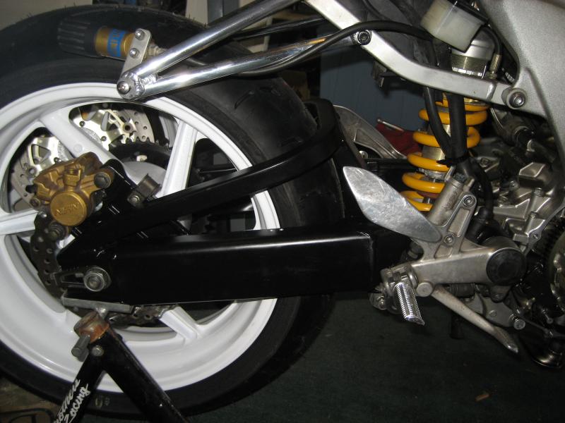

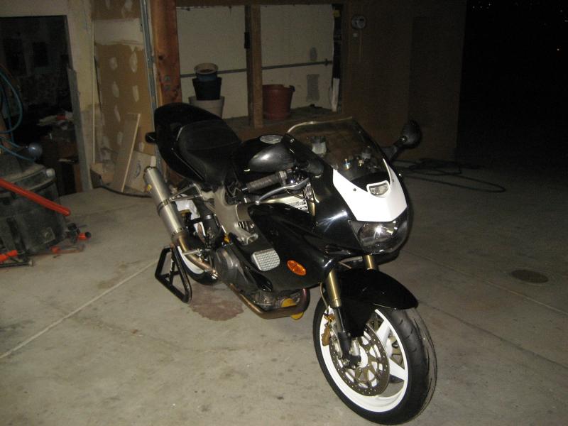

Well it's time to wrap this thread up. I still need the chain & sprockets and a rear brake line but both should show up this week.
So here it is, I do need to get a different lower triple and a few other little things but RC51 SP2 forks with Ohlins internals, Braced swingarm, Ohlins rear shock, SP2 front wheel, 900rr rear and a little of this & that

Finished product looks good. Congrats Mike. Now about that engine....

Congrats on the completion
Why do you need a different lower triple?
Old Mar 23, 2010 | 09:57 AM
  #84
My set up with the stock suspension (well the modified stock stuff...) was 10mm up in the triples and a .25" (6.35mm) spacer on the rear shock. While I liked how the bike handled I did drag the header from time to time.....
So I wanted to run the forks all the way down in the triples (for ground clearance) and get the geometry back by raising the rear.
Right now I have 2 issues. The first is the lower triple. With the 954 lower, I can not run the forks all the way down and still have full engagement on the lower triple. The lowest I can go is with the forks 10mm up (so I'm right about where I started in the front) and the shock I'm using doesn't have ride height adjustment.
To get where I want to be I need to change the lower triple to a SP1 so I can drop the forks down and then do a little math to figure out what I need in the rear and have a modified rear shock mount made......
I'll be done someday, really I will........
