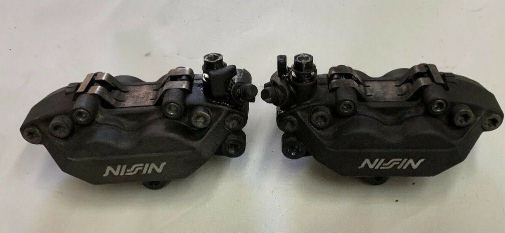

Hey all.. been a while since I posted here. I have been going thru the front brake mods here and trying sort out the information for a front bake modification.
I've settled on installing F4i calipers on front and using a VTR SP2 MC. Apart from modifying the calipers to fit the stock VTR100f forks is there anything I should know about putting together this setup from a technical stand point?
I just had the forks re-sprung with liner springs for my weight and revalved using a Andreani valve and piston kit, so it only stands to reason that I should upgrade the brakes, too. I considered the GSXR 6 pot calipers but like the idea of keeping the stock look. I've done everything I can to the stock setup and still find it lacking. I'm looking to get better stopping power and better feel with less lever travel. I like to ride with 1 or 2 fingers on the front brake lever so I want reliable response with minimal input but not all or nothing braking.
Is there anything else I should be taking into account?

You're well on your way to a good set-up. The final step is to get some good pads. Vesrah RJL are well respected pads that can be had for a reasonable sum. If you want to spend a bit more, get some Zcoo (can find them on eBay) and don't look back.

I noticed a large improvement with just the F4i calipers and my original MC. Pick up some stainless braided lines if you haven't already. I've had great experience with the EBC HH's but that's a whole different thread...

I tried the CBR600F4i calipers but prefer the CBR954 set-up which IMHO has better feel and plenty of power. Same pieces as the 600RR or SP2 in terms of sizing.

Sorry for hijack, but how do the vtr1000f, cbr600f4i, cbr954rr and sp1/2 callipers differ? Just from web surfing a bit it seems they are all Nissin, non-monoblock and apparently identical in appearance?
Are any of these calipers a straight bolt up? And for stupid example,,,,, how hard would it be to fit say,, yamaha blue/silver/gold spots?

Look at the chart above. The calipers have different sized pistons, which give different leverage ratios.
The OEM VTR calipers differ in appearance, but the others are the same except for color.

from what I've read, the calipers require a minor modification, (or a slight modification to one of the mounting points on the lowers of the forks. Check out the brake threads and you will get plenty of reading material.

The bolt spacing is the same but there is clearance issue between the lower mount on the fork leg and the caliper which needs a little massaging. I did that with a hand file (5 minutes per side) to the lower mount and left the calipers untouched. You can't even tell that I have done it as I left the outer face of the mount alone and just relieved the inner part. If you try and mate the parts together it becomes immediately obvious where the massaging is needed.

https://www.superhawkforum.com/forum...69/#post406734
This post shows the material needed to be removed from the caliper, others left the caliper alone and clearanced the fork..
I choose to remove a little material from both caliper and fork.

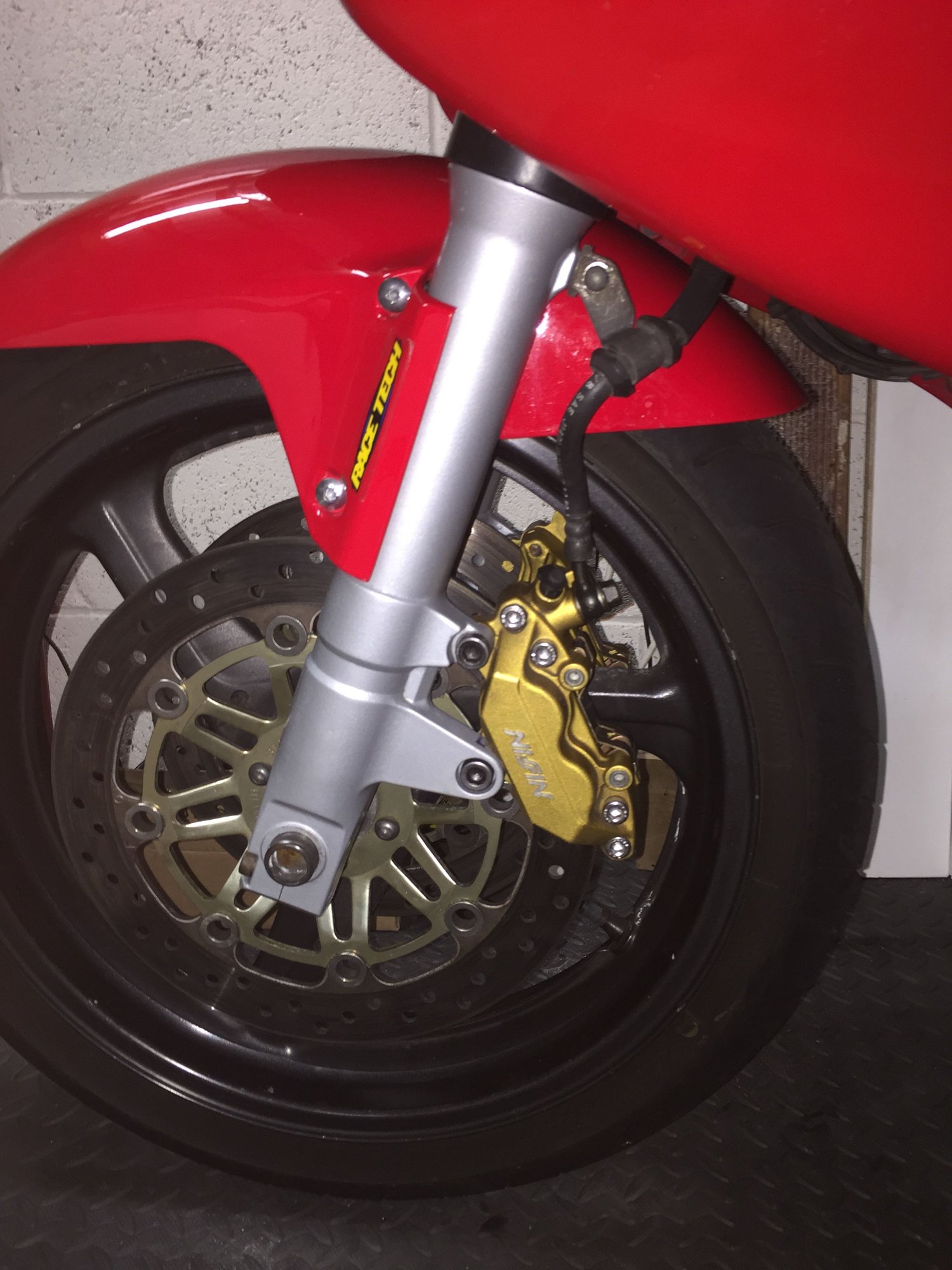

I am planning a brake tupe-up on my VTR 1000 F. With interest I have therefore studied the "ultimate brake chart". The advantage of the chart is that it summarizes the geometric facts of the different brake combos and, as an added value, gives some interpretation of the data, i.e. the hydraulic transmission factor and the braking power. However, particularly the column "Braking power" has to be interpreted with care. If you just look at the numbers, it looks as if the original VTR 1000 F has a higher braking power than the SC 44, the SC 50 and both RC51 (SP1 and SP2). This is, in my view, because column "braking power" does not take into account the quality of the hardware, i.e. rigidity of the caliper, the piston and, of course, the type and material of the brake pads. Therefore, it would be extremely helpful, if another column could be added to the chart, which gives an (objective or subjective) indication of the braking performance improvement of the different combos compared to the original VTR 1000 F combo.
Red Fox is offline
Old 04-06-2019, 07:15 AM
Join Date: Apr 2005
Location: Montreal
In principle, another key element missing is the leverage effect of the MC. As all the MCs listed are axial, I would assume their fulcrum measurement is likely identical, which eliminates variances. If one were to add radials, however, the fulcrum measurement would have to be taken into account. (ie. a 19x16 and 19x20 do NOT have the same leverage despite having identical piston sizes)
mikstr is offline
