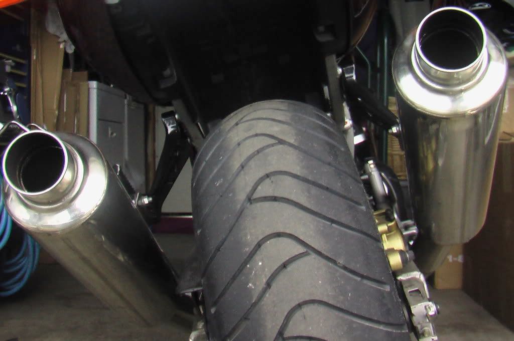

1999 Super Hawk Bafflectomy
I just picked up my 1999 Super Hawk off Craigslist, first order of business was a new rear tire followed by this bafflectomy I kept hearing about. I picked up a 2 1/8" Ace brand metal hole saw at Miner's Hardware, it sliced right through the baffle wall.
The sound was really incredible, not brassy but throaty, with a quiet rumble at idle; wife says she can hear me coming home from about 4 blocks away, I'll be putting around 3000rpm.
Interesting to note, the bike was purchased used with factory exhaust, but it had been jetted for an Erion system. After opening up the baffle wall and allowing a little more airflow I noticed less of the backfire pop during decceleration.
FYI.
I intend to remove the outer baffle completely and then primer and paint the interior of the can with some VHT FlameProof Hi-Temp paint, I understand it really helps disguise the "guts" inside the can, and also preserves it.

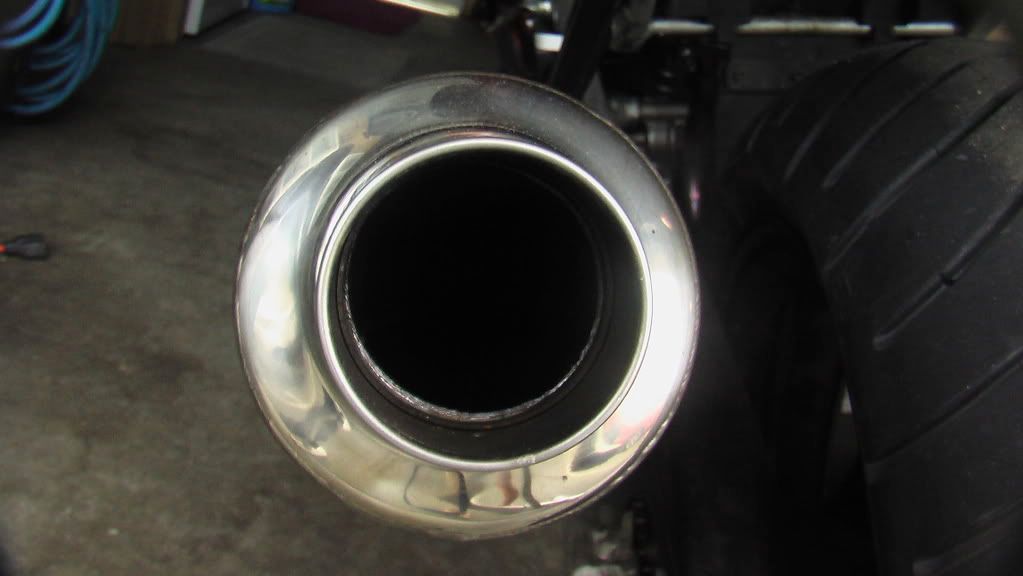

Bafflectomy Pictures
Here's a few pics post baffle removal. I used a 2 1/8" hole saw, it fit perfectly:
Both: http://i68.photobucket.com/albums/i4...r/IMGA0021.jpg
Close up: http://i68.photobucket.com/albums/i4...r/IMGA0017.jpg
Tools: http://i68.photobucket.com/albums/i4...r/IMGA0018.jpg
