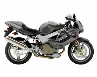

if you find rivits on your cans, i'm 120% positive that's not stock on any bike that i have ever seen. Please correct me if i'm wrong.
On stock SH cans you'd be able to drill from the back on the outside of the small exhaust tube but on the inside of the main chrome body shell.
Here is a pick with stock cans

Very cool, than my question is I found the posts about doing a baffle..., the exhaust that is on there is not very impressive, can I do the same thing to an aftermarket can?

The stock cans are three different lenght pipes making a labyrinth in a big outer pipe... That very effectively kills all wavelenght noise as it cannot escape the labyrinth without having been bounced around many times...
The good part is low noise and exact backpressure... The bad part is high backpressure and restricted airflow...
An aftermarket can is in 90% of the applications a perforated tube wrapped in dampening wool in an larger outer tube... This means a straight pipe through for the air to flow in... The sound goes out through the perforation and bounces on the outer pipe, passing through the wool and is dampened that way... Totaly different theory from stock...
The advantage is high airflow, low backpressure which is good for performance... The bad part, some of the frequencies go straight through instead of bouncing around... And it might make it harder to tune the bike exact as the backpressure is less exact at different revs than a baffle type exhaust...
I have not to date seen a stock exhaust that was riveted together... All I have seen is welded and contains nothing that you are supposed to be able to fix or meddle with yourself... So if your pipes have rivets it's almost certainly an aftermarket of some type... And if it has a big port with a long open tube visible it's not a baffle type... And then the above trick is useless...
