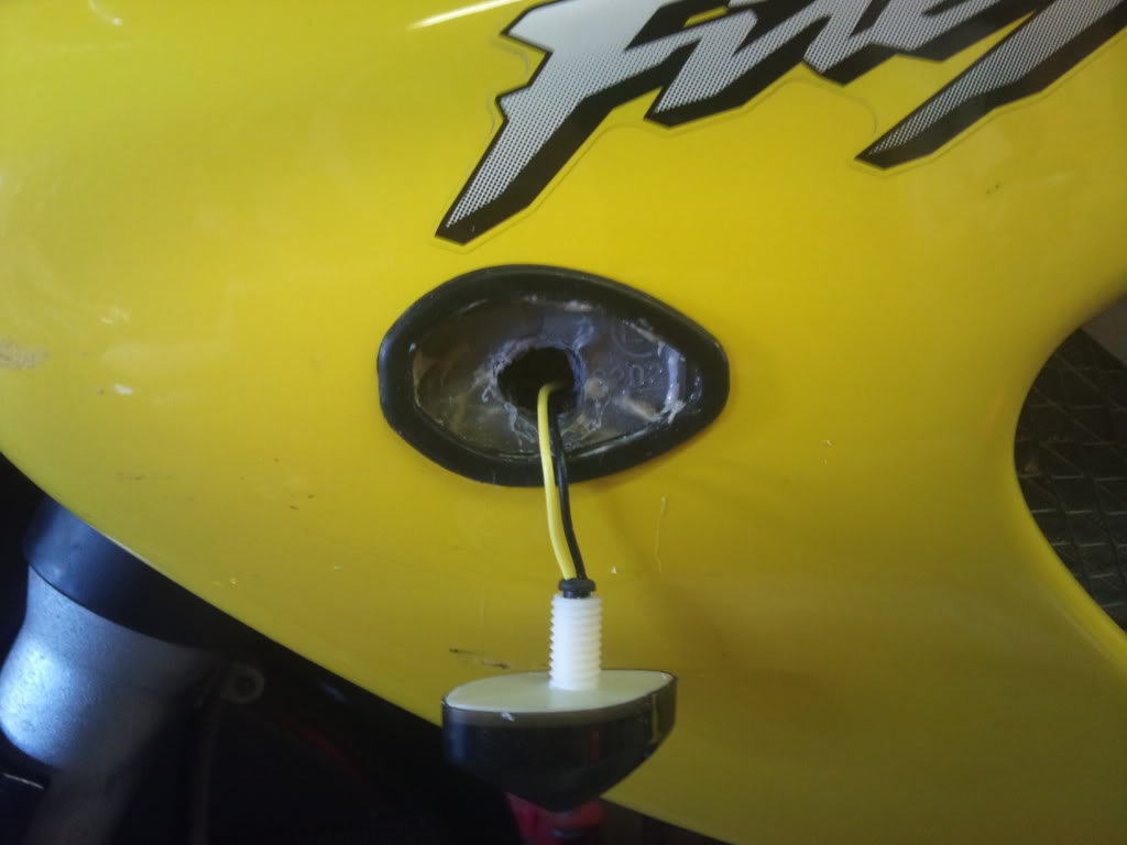

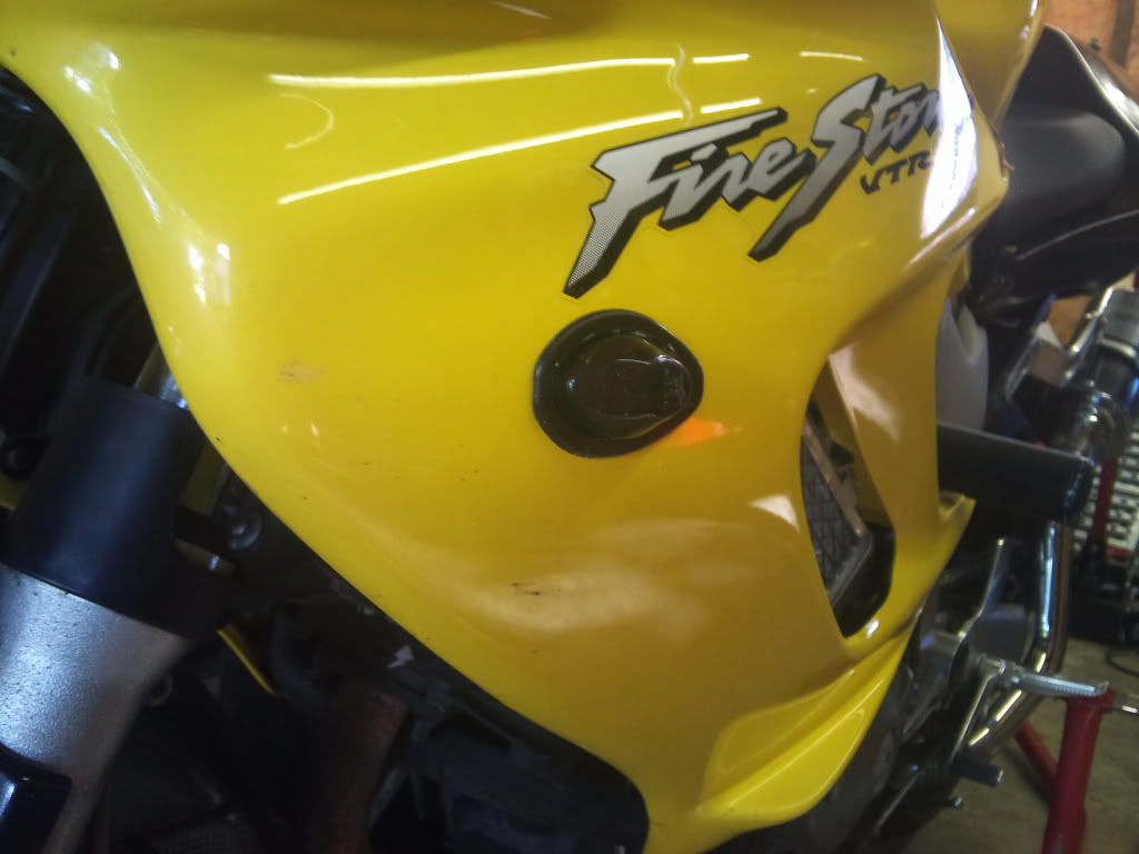

those look like the ones i have, i bought a set for a cbr 600, like 8541 said you need to make some plates, i used some pl premium and stuck them on like that and let them sit over night.
Old Oct 17, 2010 | 02:37 PM
uchi's Avatar
Posts: 1,978
From: thorold ontario

I went with a two wire led setup in mine. Smoked lens as you can see in the pic. I didn't want them on all the time. But I've got an hid retrofit aswell so I get noticed as it is :-)
