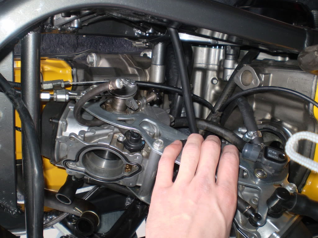

I think that's leftover from PAIR and should just be capped. At least it's capped on mine:

That's how it is now . This pic was from a long time ago when I was messing around with the carbs initially...
I forgot about doing that, though.
