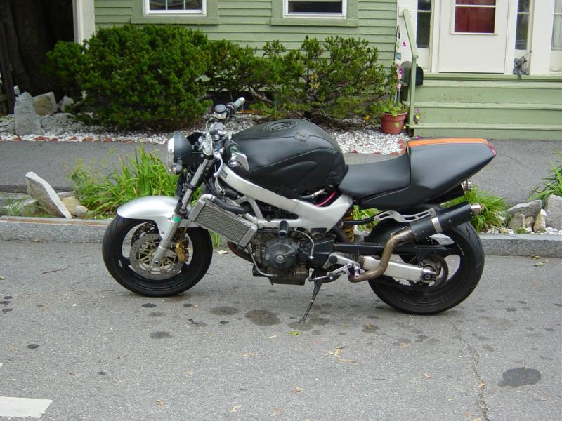

I’m resurrecting this thread because I just did the mod. I did two things differently than mdbuehler.
First, I had a shop cut a plate around the old petcock off of a junk VTR tank I had laying around and directly weld it over the VFR’s fuel pump hole. I could have dicked all year with that and it still wouldn’t work.
Then instead of building the air box down from the tank, I built it up from the filter. I just didn’t trust that I’d get the measurements correct.
So now I can go the herculean 160 miles from my home to my job in one tank – I go in one day a month now – but everything isn’t rosy. I do have a weird flat spot down low.
I initially thought this might be due to rust in the tank. I got the VFR tank for $5 then had to cream it and although I think I got everything, you never know. I am running filters right now, of course.
But I’m starting to suspect that either the insulating air box isn’t quite sealing OR I’m getting these weird effects because I installed a lid that didn’t have a snorkel. I had at one time four or five boxes and I didn’t want to trim out one of the good ones for this experiment. But it seems like folks have issues when they take the snorkles out and don't do anything else.
So I’m going to try the snorkel next week and see how it works. If it IS that, this is a silly easy mod costing around $200 from beginning to end, if you don’t mind a shop destroying your VTR tank. I love the bike about 30% more now.
Next is the front-end mod…

I’ll post tomorrow. It looks AMAZING, especially with the Bagster tank bra.
I didn’t take pictures of the masterpiece of an air box so you’ll have to use your imagination. Or wait until I reinstall the snorkel next week.

Here are some pictures. The gap between the tank and the seat doesn't bother me at all...
The oil spots aren't mine! Really!
CR

Weird. I was hosting on one of my sites at the size I usually post. When I tried to click to the HTML on the editor what I got wasn't good code. I just attached some pictures...
