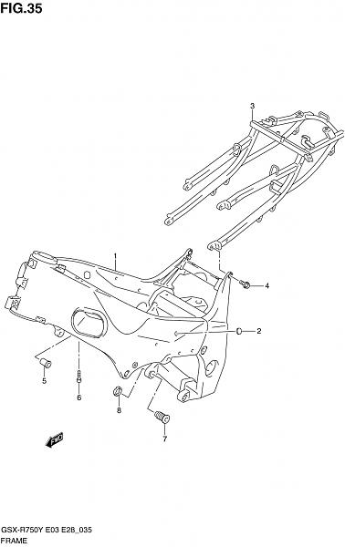

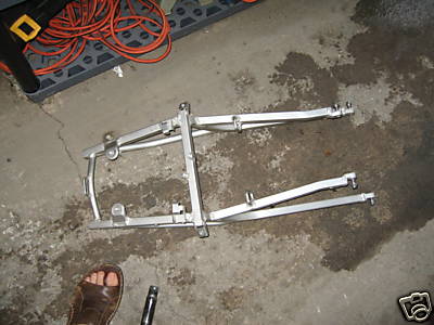

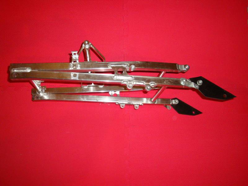

I know that the tail swapping issue has been adressed on several other threads, but i'm either a cosmetic genius or a complete retard. i've read through the threads on swapping the tails from a rc and cbr 1000, but has anyone thought of gsxr or r1 tails. the newer gsxr and r1 tails are all cast alum. but the 00-03 gsxr 600-750 subframes are steel (aka easily modified with a welder). plus, the mount points look similar, i'm guessing completely because i don't have the measurments on either sub frame..... has anyone ever tried it? or am i a cosmetic pioneer......

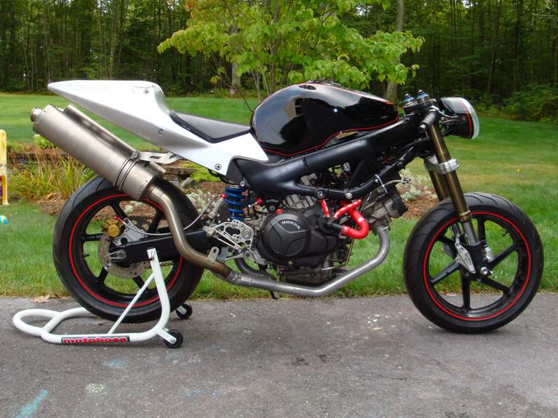

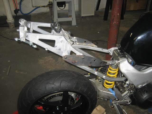

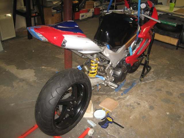

I'm putting a 2007 GSXR tail on my project HAWK right now... I'm just using the cast aluminum rear portion, bolted up to a chopped and welded front VTR subframe. I'll need to make a few fiberglass pieces to blend the side fairings into the frame, but it's looking pretty good right now.
If I get a chance, I'll take a photo or two.

Here's a few shots of where I'm at.... it's not as easy as I'd thought it would be, but I'm not in a rush so I do a bit of work each week if i can find the time.
J.

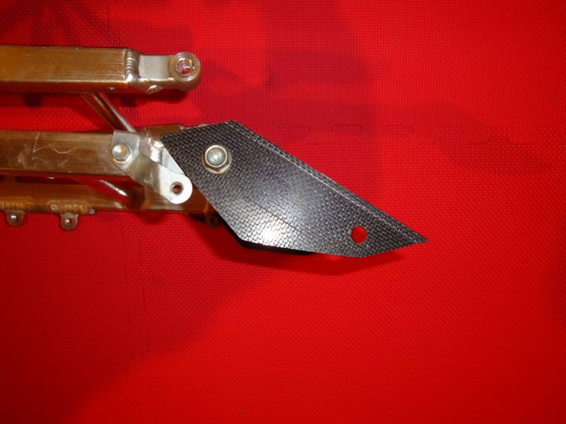

I was working on an RC51 tail swap. I simply made some Carbon fiber brackets to mount up a stock RC51 subframe. Worked like a charm. BTW... the subframe and brackets are available if anyone wants them.

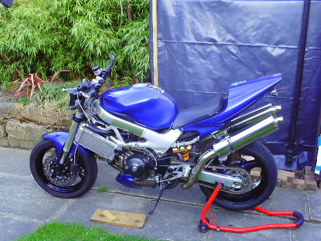

this is mine with a early r1 seat

That's looks real nice Fishface.... I love that the exhaust and tail have the same angle.
One question.. how's the seating position? It looks a little slanted forward... I only ask becuase my GSXR tail mod is tilted forward a bit as well, just wondering if I'm asking for trouble?

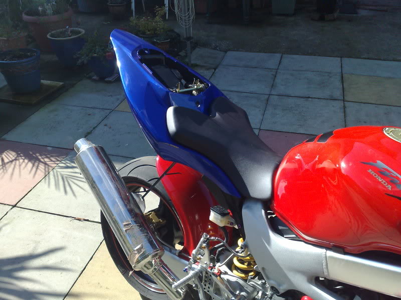

R1 seat conversion(new pics 05/10/08)
