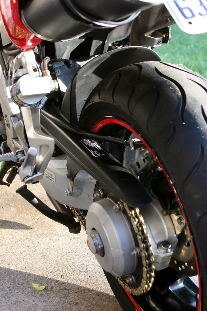

I modded a cb919 unit. It was pretty close right out of the box and only needed minor brackets/new holes kind of modding.
I don't have any real good shots of it loaded in my photobucket account.
This is the same fender modded even further to fit my VFR with single side swingarm but you can see how it, especially the chain guard part, still looks "factory". After taking this pic, I moved it back more to "hug" the wheel better. Still need to paint that extension bracket in front of the sprocket but really want to include it in a batch of small parts for powder coating.
