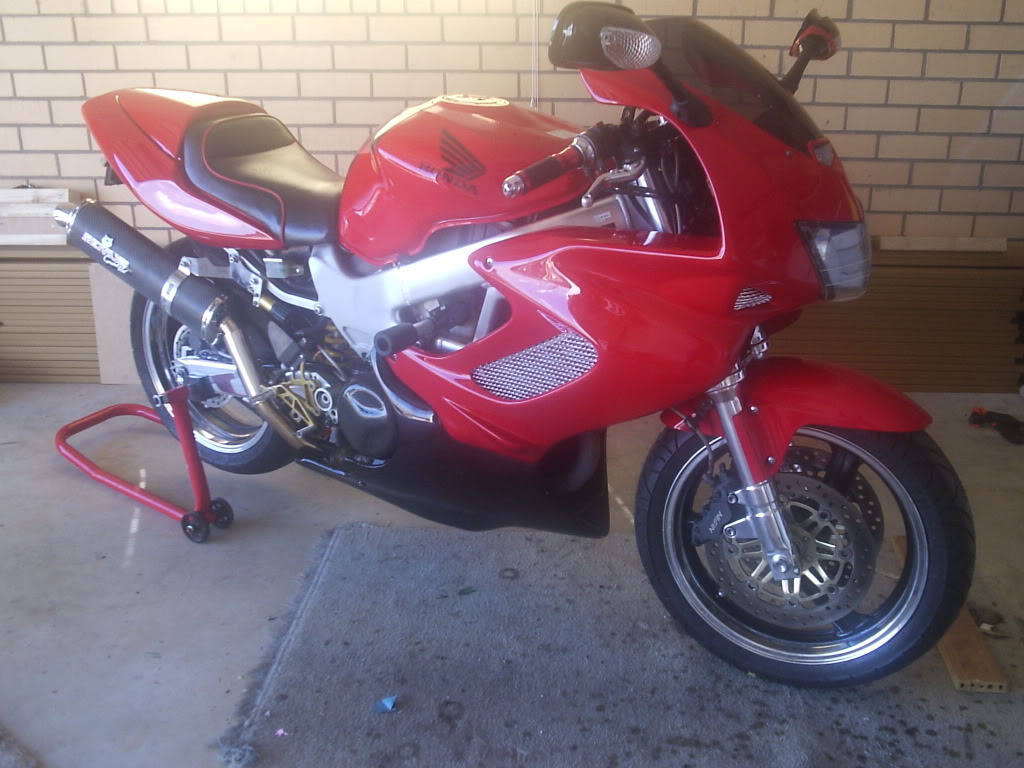

Had these ones but found they vibrated a bit.
Also they have plastic stems
Went for gixxer mirrors,longer, metal stems,$60 del,but a pain to install

Old Jan 12, 2012 | 04:16 PM
Posts: 2,223
Plz more info on Suzi model, fitment difficulties & pics
Whose sidecover covers, rear sets, sliders, lower, levers & pipes (Devil?)?
I see an Ohlins shock, Corbin, Ventura headlight cover & Superbrace fork brace...
Very nice fast red one too...

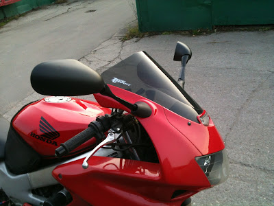

Fazer mirrors mod:
more pictures http://grommitsgarage.blogspot.ru/2012/11/fazer-mirrors-on-superhawk.html

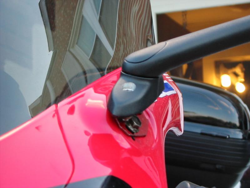

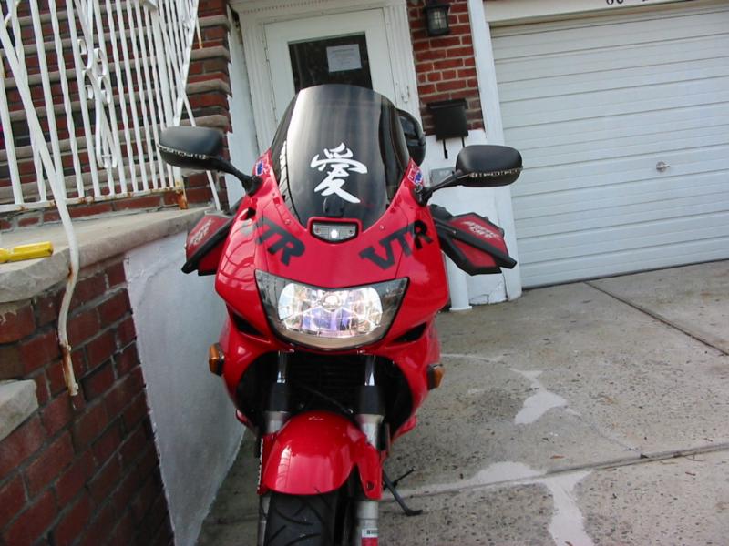

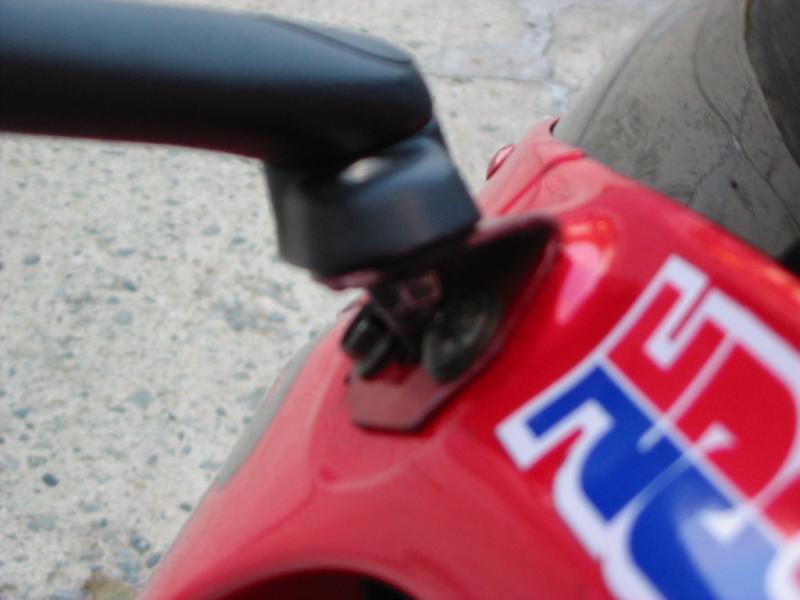

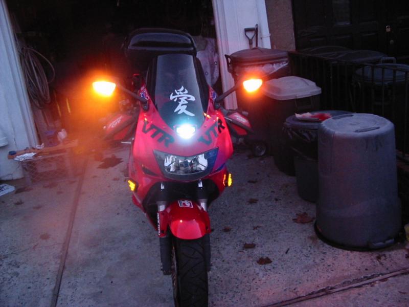

I made my own brackets for my awesome gsxr mirrors. BUT you can use pep boys stick on LED strips to do it on any mirror if you want to avoid hard work. I have a thread on how to make em running lights too.
Attached Thumbnails Mirror Recommendations?-2012phncard-046.jpg   Mirror Recommendations?-2012phncard-052.jpg   Mirror Recommendations?-2012phncard-047.jpg   Mirror Recommendations?-eclipsebags-018.jpg

I did the Frazer mirror mod, which BTW is a good upgrade, and used this method to mount them At Grommit's garage: Fazer mirrors on Superhawk
No, they don't have integrated turns, but I mentioned it because I used the mounting brackets that came with the Frazer mirrors to mount the GSXR mirrors I now have on the bike. The Frazer brackets and GSXR mirrors (after the GSXR brackets are removed) require some grinding (I used a bench grinder and a file) to get the angles right. It was a lot simpler than custom fab'ing new brackets. Matching the angles is a bit tedious but well worth it. I was able to re-use the SH rubber boots, though the fit isn't perfect it's close enough. Used the two to three wire fix to enable both running lights and turns. There may be a write-up on this forum, but I used this one Convert 2 wire signals to 3 Wire Inputs - CBR Forum - Enthusiast forums for Honda CBR Owners
