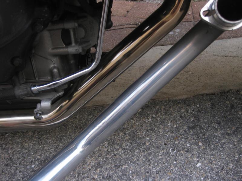

Bead blasting isn't going to make them shine, and if the stains aren't coming off you're just not polishing them correctly/enough(meaning you need to start with something coarser). If you wet sand them correctly (yes it's a bit of work) they'll shine like mirrors. They'll also turn gold as soon as they get hot. Still looks awesome in my opinion, but they'll require periodic polishing to stay super shiny. Yes it'll be easier because once sanded and polished they'll be smoother than they probably were new (this definitely applies to the stock header). And being that not all parts of the header are accessible when it's mounted it's going to be a general pita if you're wanting them to be shiny all the time and you ride your bike on a regular basis. The newest Jet Hot, etc coatings are pretty shiny and would probably be your best bet as far as appearance and ease of maintenance. I don't think they look QUITE as good as polished but that's just my opinion and again the ease of maintenance will probably outweigh that.
Old May 16, 2017 | 05:13 PM
Posts: 4,517
Here's an old pic I took of a pair of Two Bros headers I had. The one on the bike I polished, and the other is Jet Hot coated. Both are stainless like I'm assuming your Akrapovic is (I've never seen a full ti exhaust for a Superhawk from Akrapovic).

I stopped sanding when it didn't appear that I was gaining ground on the stains. Maybe I gave up too soon. The bead blast was to see how deep the stains were. Plan was to follow up with sanding and polish if the blasting worked.
I have access to an industrial grade buffer/polisher so that part of the equation is covered if I go that route. I like the patina that polished stainless has after a few heating cycles and would put up with the eventual dulling, but don't know if the stains will show through once dull if I can't get them out more than I have.
The idea of having an easy to maintain and attractive finish that would hide the stains was the motivation to go with a coating. That way it's done once and forever. I really hate doing things twice, more than throwing money at something that I already spent a lot on.
