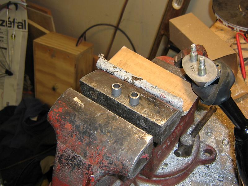

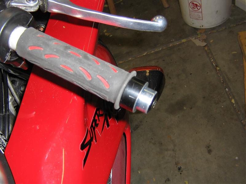

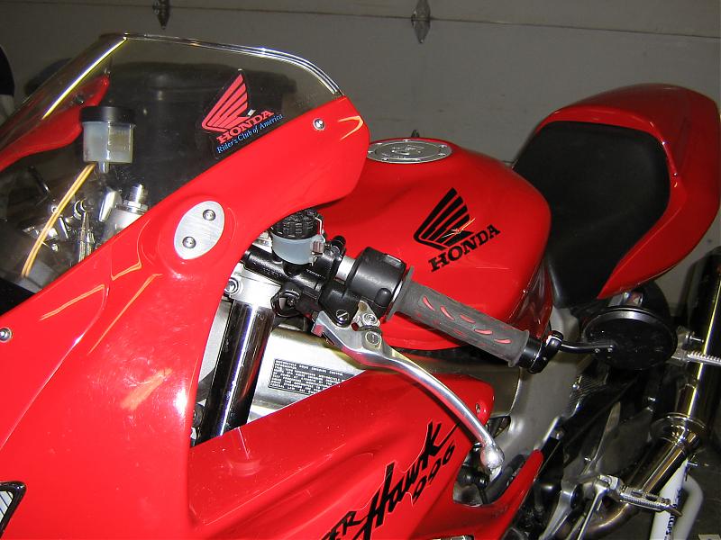

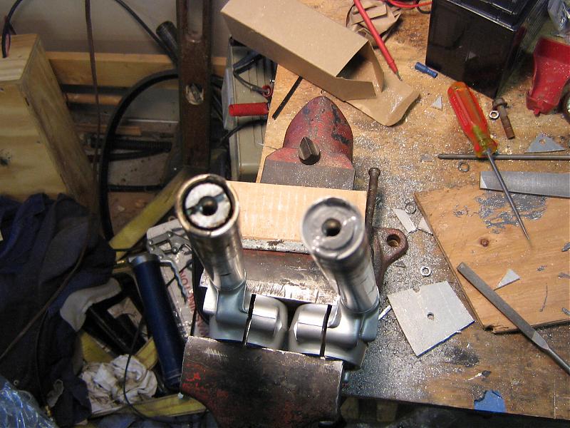

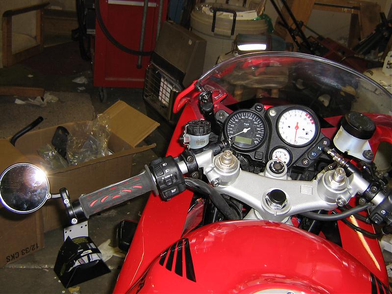

bar-end mirror mod
I had some extras that came with my bike, among them a pair of CRG bar-end mirrors and a spare set of stock handlebars and end weights. I had the ends of the the weights turned down to 7/8" to accept the mirrors, only to find that the inner part of the bar turns, presumably to have the internal weighted rubber cancel some vibration, and you have to hold the weights as you tighten them against engagement dogs on each. Clever design, but attaching mirrors to something that turns in the handlebar is impractical without further modification. My solution to this (and to alot of other things over the years) was JB Weld - I clamped the bars in a vice with the ends up and drizzled some JB in there and allowed it to cure under a heat lamp. The epoxy traveled pretty far down inside the bar before it set up, allowing for an additional application, this time filling the space between the inner and outer parts of the bar right to the end. I then got some 3mm aluminum scrap and got to "fabercatin" some block off plates, loosely the size of the rubber pads that were under the stock mirrors but are now under the plates. The mounting studs of the stock mirrors are 20mm in length, with a 9mm collar at the base which I approximated with some 3/8" steel spacers from the True Value, hacksawed and Dremeled to 9mm's. Using 20mm stainless steel button head allan bolts everything just sort of fell back together, using the stock acorn nuts. It's sanded aluminum now, but the local chopper shop said they would powder coat the plates and bolts heads black for me for $20 bucks next time they have their oven fired up. I think it cleans up the lines of the motorcycle nicely, and once they are black will look pretty good.
