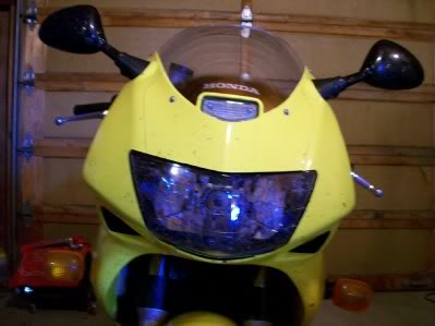

Sorry guys..still having trouble posting pics on these bars..maybe tonight. I have some good shots that show the different height and angles..had to loosen some hoses and wires..re-route somethings but went quite well. Glued some rubber on the turn stops for the bottom triple clamp to restrict turning radius so that wouldn't kiss the tank..all clear with fairing as well..Pics will show it well. They look classy. The bars are solid aluminum...not aware of ay vibration issues..rode 200 miles..felt good.. Makes the bike even lighter handling...

Here are the pictures of the tomaselli clip ons

Thanks guys for helping sort that out. My apology for being so helpless with computer stuff. I hope the shots show the difference. About 3 in. back..2 in. up..wider and a very different angle. I undid the front brake hose mounting and the clutch hose mounting..gained some extra space..moved the front brake lines on both sides..mounted inside bracket not out..slipped about an inch of hose higher..loosened some wires...glued 1/4 rubber blocks unto triple clamp turn stops...can't lock steering and forced increase in turning radius. no interference with fairing...changed angle of front brake reservoir..But the comfort and handling..amazing..If you type in Tomaselli Clip-0ns it will bring you to a site where you can get them...I paid $150 Canadian..make sure you get right fork diameter..I think it's 41 mm.
