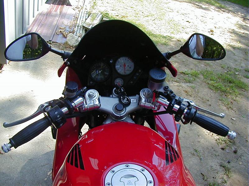

For you fellow SH riders out there that are looking for a more comfortable riding position I have found an economical solution. 41mm Tommaselli adjustable clip ons. I found them at Cosmopolitan Motors in Hatfiled, PA. They also list them sometimes on E Bay. I paid $99.95 plus $10 shipping. The delivered promptly. These bars move your hands up and back at least 2 inches. I was able to reroute lines etc. and this installation required no parts other than the bars. The bars are quality Italian aluminum castings and the hardware is high grade. This probably the best mod that I have made to my SH.

Did U have to trim the fairing or have tank interference issues?

INSTALLATION ISSUES
No fairing trimming or tank problems. I glued some small spacers on both steering stops to slightly reduce the lock to lock travel.

Old Sep 10, 2007 | 04:26 PM
It doesn't look like the bar ends fits properly. Can you comment? Also is the geometry adjustable for ride height? It would be nice to change from track settings to street settings.

Bar ends
The bar ends still need some work. I am using aftermarket ones. The holes in the end of the bar are not very deep so I need to modify the ends to accomodate the shallow depth. If fact I just got back from a 75 mile ride and almost lost one of the ends. You could adjust the position for track days quite easily.

put some pics up so others might benefit since these are probably the most inexpensive and maybe the best looking clipons available. Maybe from your pics, questions regarding cable length and others could be resolved.
Also, if this vendor is interested in selling these, he might be able to provide a site or link where they can be viewed and described, etc, so that it's not so questionable.
