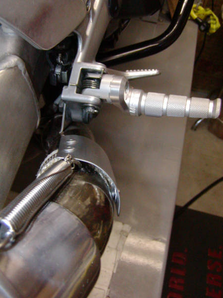

I've had the MFW Vario adjustable pegs since at least 2008 with no issues (and I far outweigh you and stand on the pegs all the time). I made my own heel guards as I wear size 11+ boots. I shortened the thread brake actuator rod eliminating the lock nut but safety wiring the link, and extended the brake toe portion as the 1-inch extender is about 8 mm wide and moves out your boot on both pegs that amount.
Attached Thumbnails Chi-Knee FOOt peg! An in depth look:-img_0004.jpg   Chi-Knee FOOt peg! An in depth look:-img_0015.jpg   Chi-Knee FOOt peg! An in depth look:-lt-side-ctr.jpg   Chi-Knee FOOt peg! An in depth look:-rt-side-ftpg-2.jpg

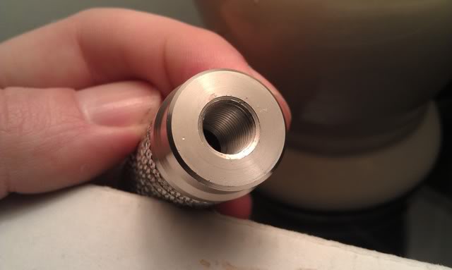

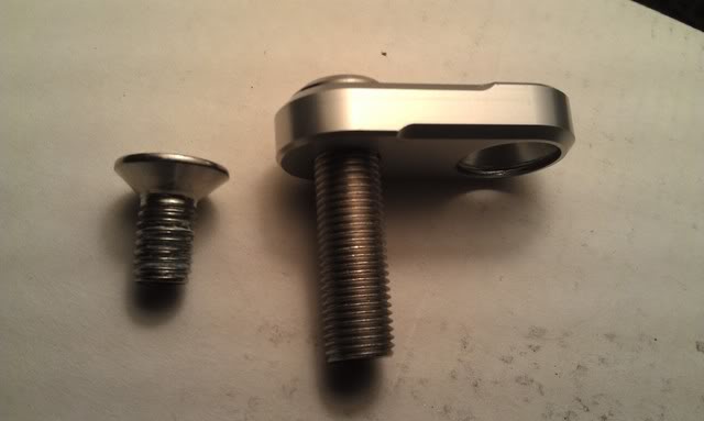

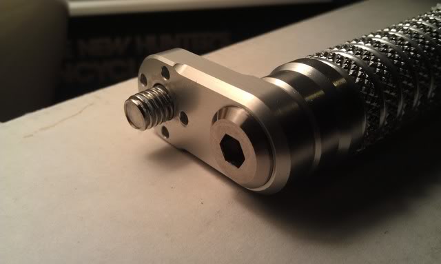

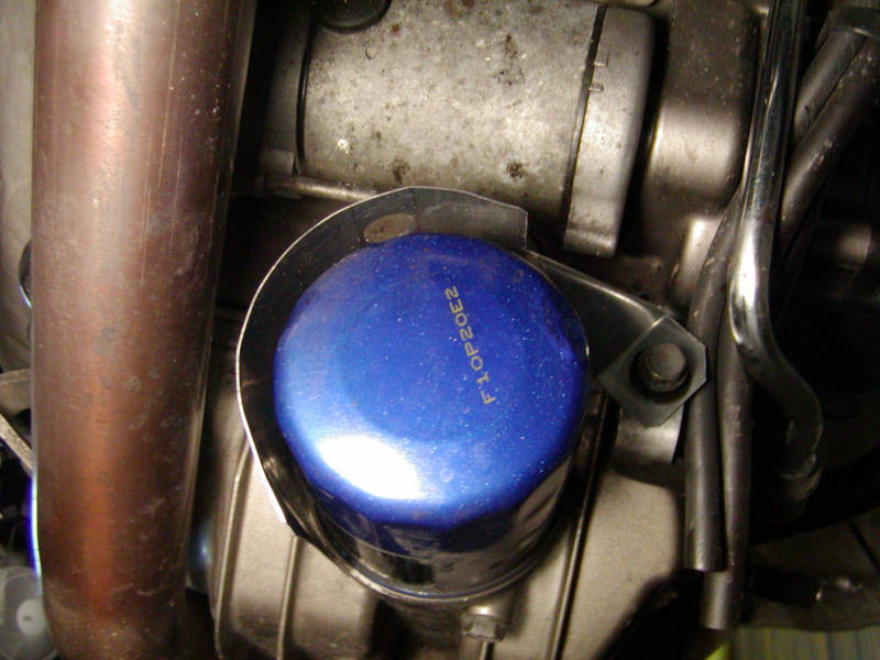

Skokievtr thats my next thing...fashion some sort of heel guard...Because that was a big problem BEFORE this and now even worse. Could you do some close up pics? More angles?

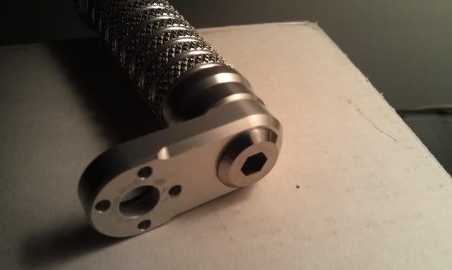

But anyways, as promised are the updated photos:
The inside diameter was widened by 0.075"...aka not much but just enough:

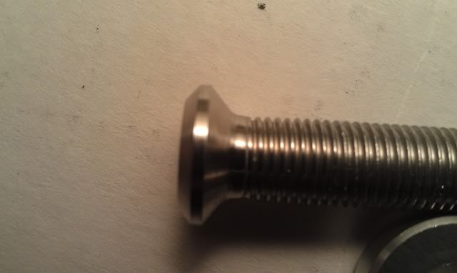

The foot peg bevel eliminated for a more solid contact:
A closeup of the machine work on the screw itself:

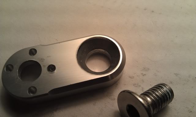

And assembled..partly LOL:
I hope this setup works, I imagine it will be more than adequate. What I'm worried about now it the pivot joint itself failing at the point with the (now) least amount of thread. Daytona Bike Week will tell I suppose. But here's hopin! Cheers guys thanks for all the input!
And of course I'll do ANOTHER follow up after my return In late March, tell you guys how they held up.

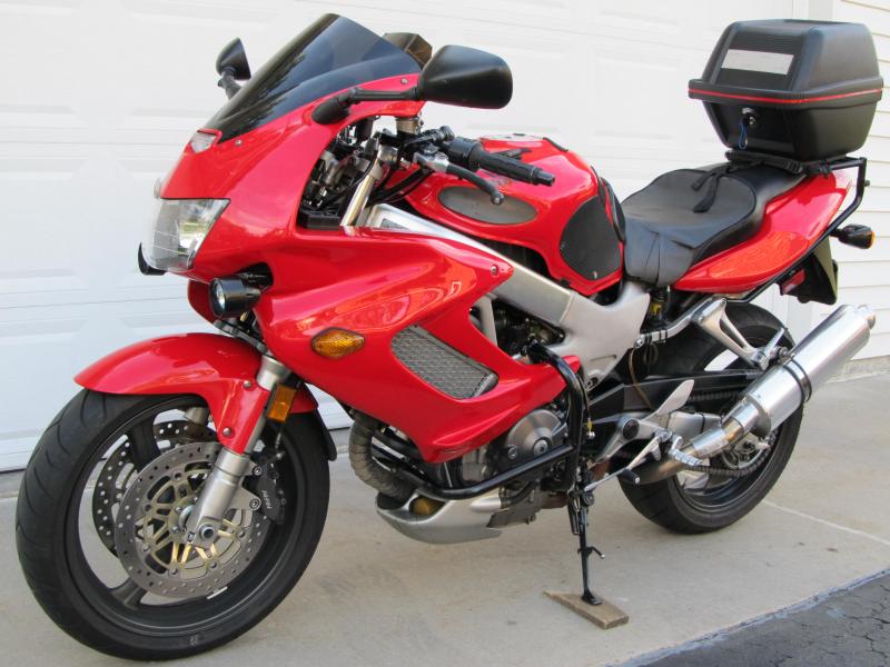

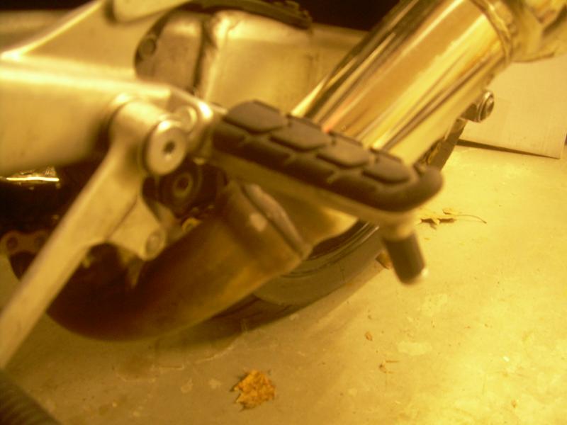

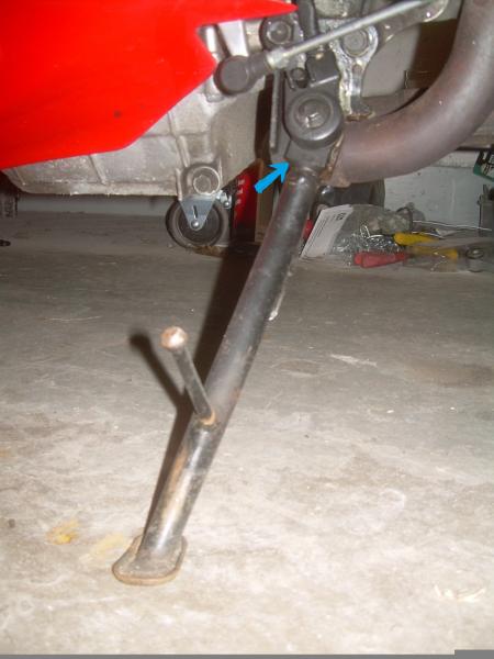

I see from the pictures you have a little problem with the kick stand
There is a simple solution relatively easy and cheap.
Get your self a CBR1000RR kick stand mounted instead, just the arm, works really well, it's one inch longer, flat wider base, tubular (which means not flexible as the stock) and lighter, you just have to shave a little material from the front stopper to get the correct position.
Sorry for the Bandit400man, just wanted to help

Hey, Bandit400.. Just got those peg sets in this morning.. When I came in from work.. Changed my shoes an went to Lowe's... 8m X1.25 X50m... Yeah I get back-get all the photos,put together, installed.. And get to the forum-To show off "THE FIX".. and well GRAND... second fiddle again..
Yeap I will have to ponder the $115.00 for the german produces- to the mere $35.00 that way spent..on the japan stuff..

Sorry forgot to mention that fix, When I got the 50mm screws, I also matched the set-pin with 8 roll pins.
4 roll-pin per side in 4 points, so you can still 360 position the pegs...
A spot of blue -Lok-tite on all threads.

Word man that's what I was thinkin...where'd you find roll pins that fit? Or do you have access to a machine shop an had em made? That's what I wanted to do, but their tiny an they already helped me out this month lol don't wanna push my luck

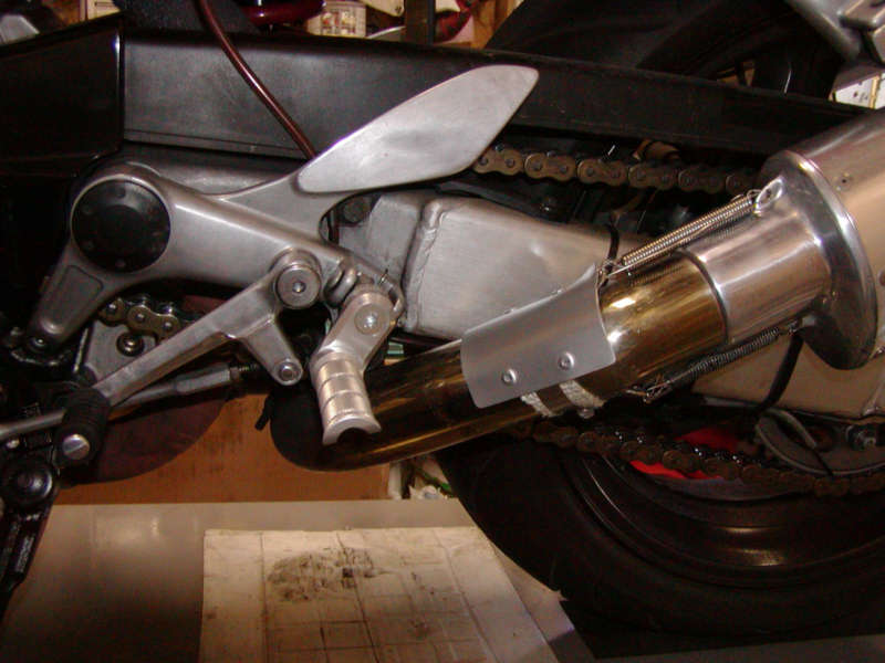

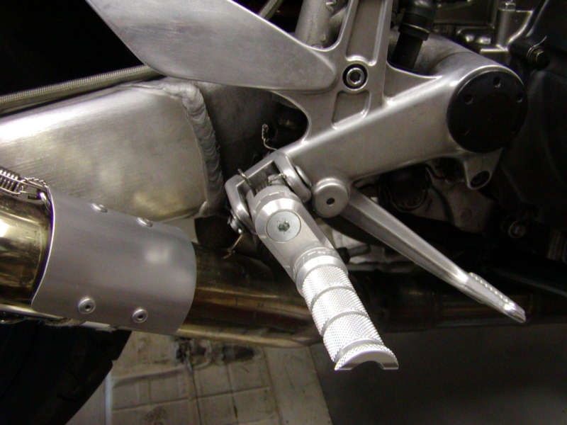

Very simple fab. .040" AL6061T6 cut, formed, edge & surface polished to shape; drill 4 holes & pop-rivet 2 .028" AL6061T6 top-hat brackets; & attach with SS hose clamps with HT wrap between pipe. Pics below of other simple things I've made (oil filter heat shield & oil cooler rock guard)
Originally Posted by NHSH
I see from the pictures you have a little problem with the kick stand There is a simple solution relatively easy and cheap.
Get your self a CBR1000RR kick stand mounted instead, just the arm, works really well, it's one inch longer, flat wider base, tubular (which means not flexible as the stock) and lighter, you just have to shave a little material from the front stopper to get the correct position. Sorry for the Bandit400man, just wanted to help
Block of wood only used to bring VTR up closer to vertical for photos but I appreciate the input. What year CBR1000RR and which "front stopper" do you mean, on the bracket bolted to the engine or on the arm itself?
Attached Thumbnails Chi-Knee FOOt peg! An in depth look:-rt-side-ftpg-5.jpg   Chi-Knee FOOt peg! An in depth look:-vtr-oil-filter-ht-shld-w-o-chin-cowl-2.jpg   Chi-Knee FOOt peg! An in depth look:-vtr-oil-filter-ht-shld-w-chin-cowl-1.jpg   Chi-Knee FOOt peg! An in depth look:-oc-guard-instld-1.jpg   Chi-Knee FOOt peg! An in depth look:-oc-guard-fab-1.jpg
I suppose I should take some photos, I will try to take some tonight and post again, you need to shave a little material at the point of contact between the arm and bracket in the down position, if this making sense... I shaved from the actual arm just to keep the option of going back to the stock kick stand, but after using the CBR kick stand, I would never go back to the stock!!
the year models that works for sure are 04 to 07 like the following: 06 07 CBR 1000 RR CBR1000 CBR1000RR Kickstand Sidestand Kick Stand Side | eBay
not sure about other years...
BTW, this particular price is a bit high, I got it for $19 on ebay including the whole assembly bracket and switch that you don't really need.

Here is a picture of the set up of kick stand, not the best quality photo though, sorry for that, I marked with a light blue arrow the location you need to cut. I also attached a photo of the foot pegs I use now and they work really well for me, can't remember from what bike they came off, I think it was from F4I
Attached Thumbnails Chi-Knee FOOt peg! An in depth look:-dscn9540.jpg   Chi-Knee FOOt peg! An in depth look:-dscn9545.jpg

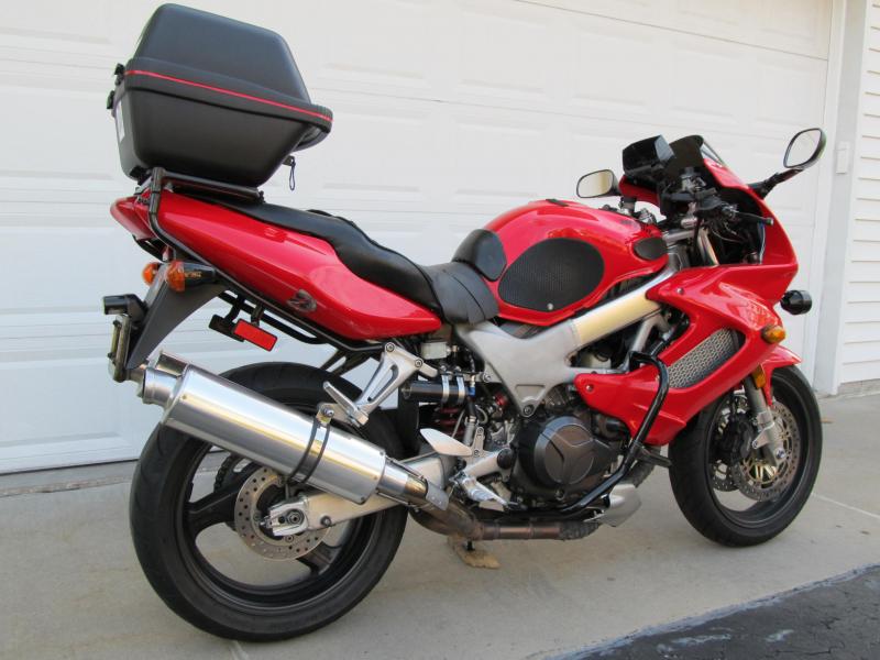

And skokievtr how did you mount those extra lights I see? Custom bracket or did the lights themselves come with a mounting bracket that could be manipulated into place? Always wanted additional lighting, but was at a loss for how to proceed...I notice when I lean into a curve in the dark I cant see squat ahead of me cause my beam leans too LOL
I assume those aux lights solve that problem?
Twin 50w halogens are quite small & light that really light up the road out 125 feet or so. My attached design is representative of what I fabricated & installed. Power is through my own harness with relay (switched from the left clip-on) direct from the battery (fed direct from a Kawi mosfet VR-R) via 10 gauge wire to an auxiliary power buss with 14 gauge wire to the lights.
Attached Thumbnails Chi-Knee FOOt peg! An in depth look:-vtr-dl-instl-1c.jpg   Chi-Knee FOOt peg! An in depth look:-vtr-dl-instl-2c.jpg

Hmmm...10awg seems overkill LOL but cool man! It doesn't affect air flow/cooling over the radiators? From what I've read those air dams are functional to flow over the side-mount radiators...but I suppose its trivial, really.
10 is not too big to the buss, heck we use 8 when possible from the battery. Remember, DC requires bigger gauges for less amperage loss the farther you run.
The scoops & ducts do NOTHING. The rads cool from inside-out, high pressure to low pressure. Check which way the fan blows and where the heat goes. The ducts are there for looks...

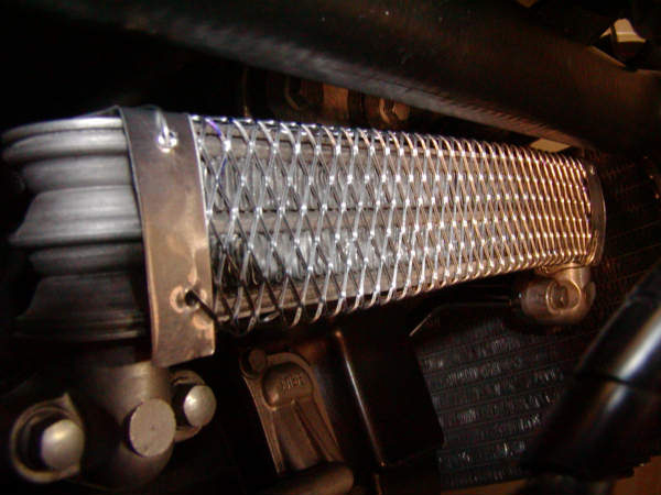

I ran without them for years as the early ones rattled. Then was given a set and reinstalled them with no difference in engine temp either way.
Bandit, how did these work for you? I found this thread while searching for a method to give me a little more room for my legs on my bike.
As a mechanical engineer the failure of the footpeg that you have shown has me a little concerned. You are right that the weak link is now the other fastener with the small amount of thread engagement. I would be surprised if that joint doesn't fail like the other.
