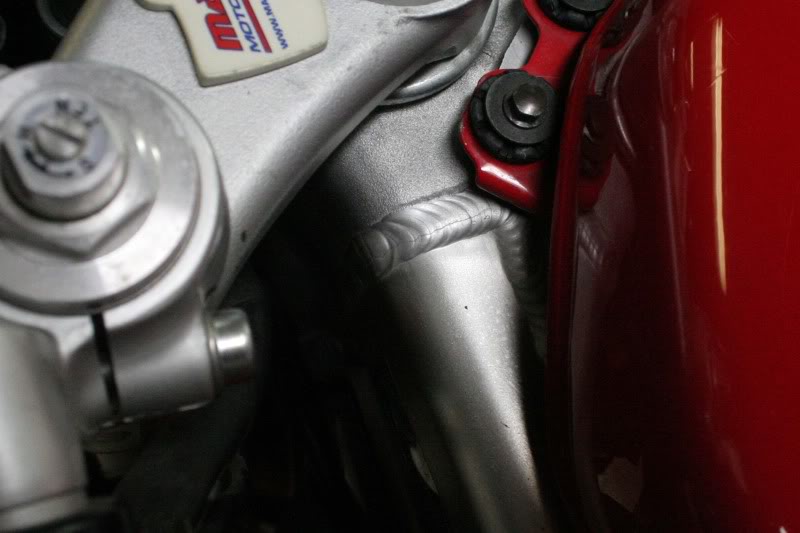

Honestly, I don't mean to jinx ya, but I've got $100 that says the steering neck snaps off after the first big jump. The longer forks will have so much more leverage on the neck, plus the VTR neck is notoriously weak (at least from what I've seen). There is one for sale here that has a crack in the neck weld...

And there was an '04 that I bought earlier this year that had a crack in the same spot.
A quick search will show that the majority of motards have a down tube running from the bottom of the neck, under the engine connecting to the frame.... the one's that don't are designed for the strees. If you think the engine is strong enough, think again... There was a post not too long ago about a cracked case where the swing arm meets the case. I know the damage I have shown is from accidents... but whats the difference between that and pushing a VTR frame beyond it's design limits?

Thinking you might want to address this. I'm sure it makes sense to you.
Take it into a good alum welder. Tell him what the issue is and the strength you need. You could come up with some measurements and templates for braces/reinforcements. I'm sure you'll then be removing the frame to have it done. Fun stuff but not too bad. Legos right?
Thanks for sharing that inderocker, huge deal, potential Hawk breaker really.

I can see the neck being reinforced but I'm at a loss with the engine/swingarm deal....
Hafta get really creative.....

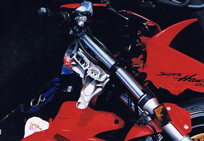

So any progress with this? And since you guys mentioned cracked frames I decided to post up a better picture of one.
Old Jan 19, 2010 | 10:53 AM
  #112
That hurts just to look at.......
Old Jan 19, 2010 | 11:00 AM
  #113
Actually it hurt alot more than that

That pic is pure chaos HA!
It took a second to figure out what angle and what part of the bike we are looking at.
