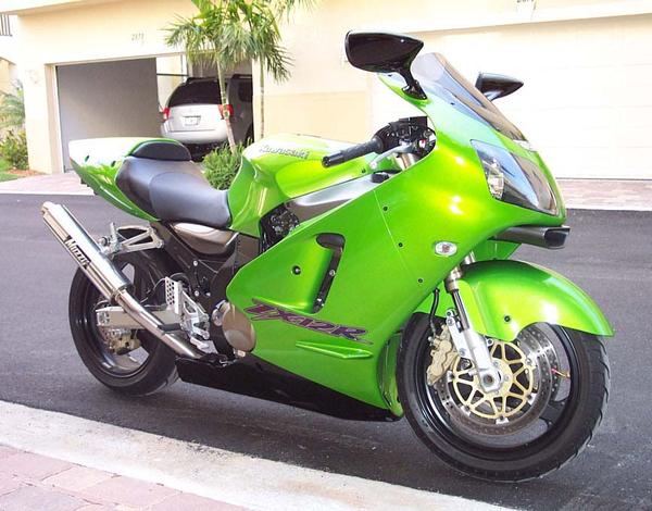

Is that the same green as my old ZX12? (I miss that bike sniff sniff)

Old Oct 31, 2009 | 07:07 PM
Just_Nick's Avatar
Who are you?
Posts: 731
From: Las Vegas, NV
Looks like it.
