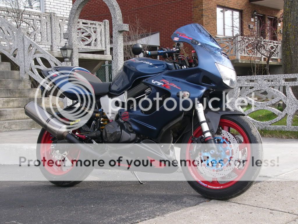

Mori lower on, behold......

Old May 6, 2011 | 02:54 PM
That's not a motorcycle it's a freaking show piece!
Mikstr, when you r ready send me that lower and I'll have have a mold made so we can reproduce it

Old May 23, 2011 | 07:43 AM
  #47
Another (little) carbon fix.....
Just picked up a couple carbon reservoir brackets. I had been eyeing these before but they were ridiculously expensive ($150). Now they are heavily discounted so the time was right for another carbon fix...
I hope this gets me in for VTR of the Month......
