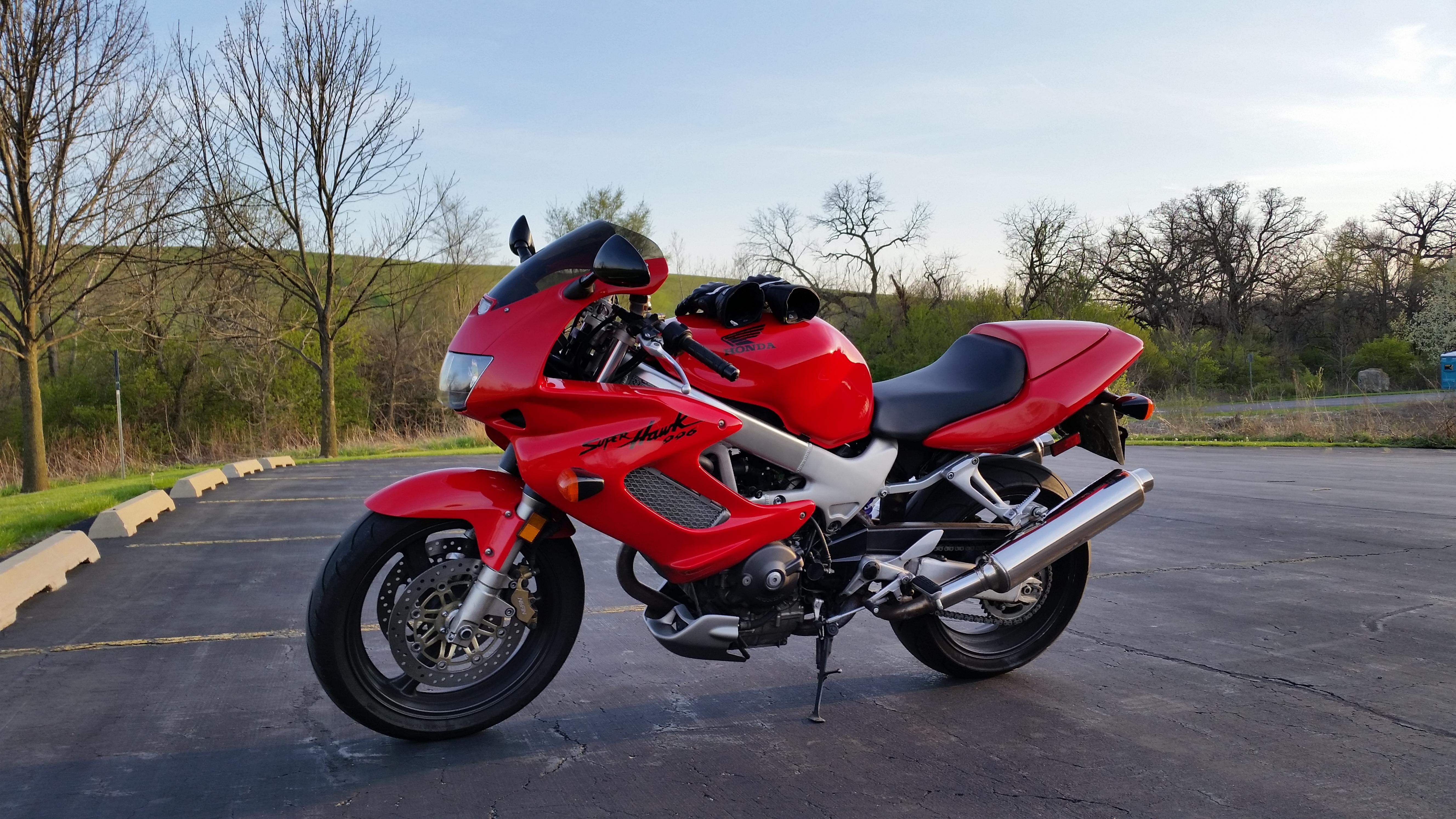

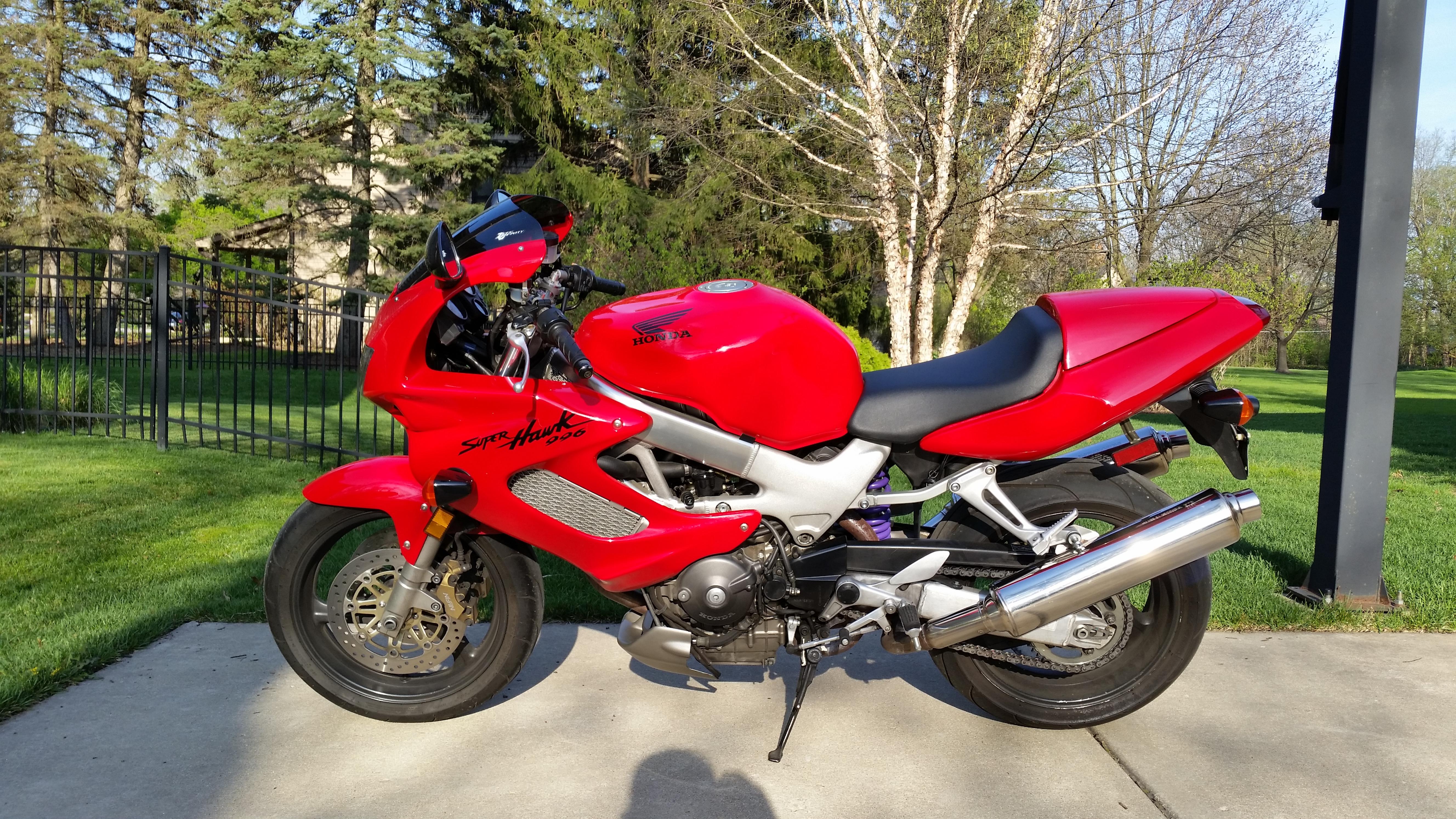

Hey there everyone I just purchased a 1998 VTR1000 and wanted to say hello. I was able to find a borderline stock (except for the suspension) example with 15,000 miles on it and jumped at the chance to buy it. I test rode an SV1000 but didn't like the one I was riding and am glad I waited for this one. I am exploring the bits and pieces that need to be replaced (rectifier/regulator, CCT etc.) and would love any tips and suggestions to keep this bike running long term. I love the looks and ride of the bike and am planning on keeping it for a very long time .
I was wondering if any of you had an opinion about swapping a stock CCT for another brand/newer automatic CCT rather than a manual one?
I am located in Chicago IL btw.
Attached Thumbnails New to Forum with a Red '98-20160423_184846.jpg   New to Forum with a Red '98-20160423_174043.jpg
