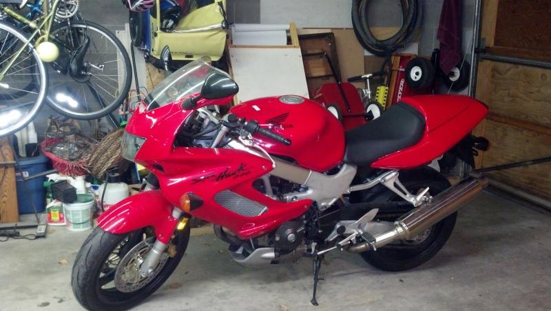

Picture of new bike - 98 SHawk
Here's a pic of my new mount....currently straight up stock, other than a K&H air filter...considering a Sargeant seat, Jardine pipes this summer

Welcome and clean ride you got there! Sargent seat is a great product and well worth it!
