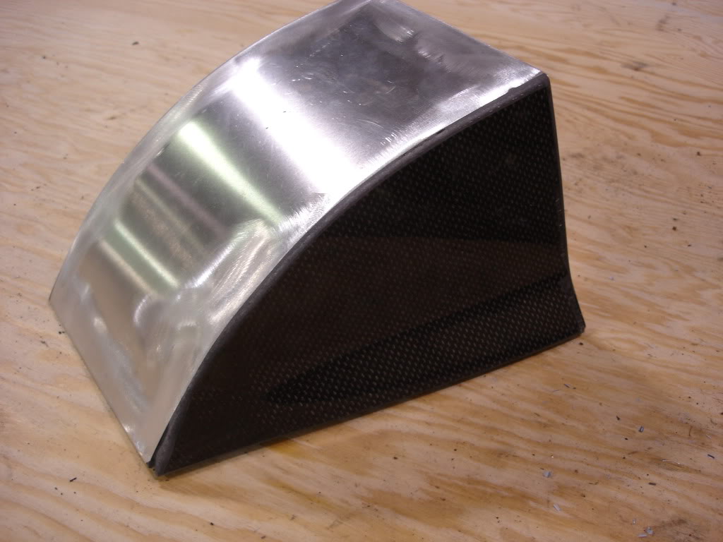

Originally Posted by theofam
Can't wait to watch another one of your builds! Your sis is a lucky gal.
I've never worked with carbon fiber, but if it adheres to steel, I'd lay it in the knee dents to tie in with the cowl. That would look schweet!
I can adhere carbon to just about anything. I will need to make it thinner though the hood I am taking it from has it glued to an 1/8 thick piece of fiberglass that I would somehow need to remove in order for it to be put in the knee dents in the tank.
I think we all love watching these builds. He somehow makes more progress in a week than I do in a year I've worked with fiberglass a bunch and once had the opportunity to help a friend lay some carbon fiber for a custom canopy he was building for a racing airplane. We basically did it just like fiberglass-the cloth, the resin...

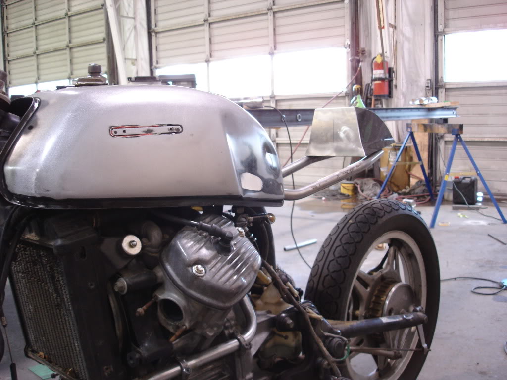

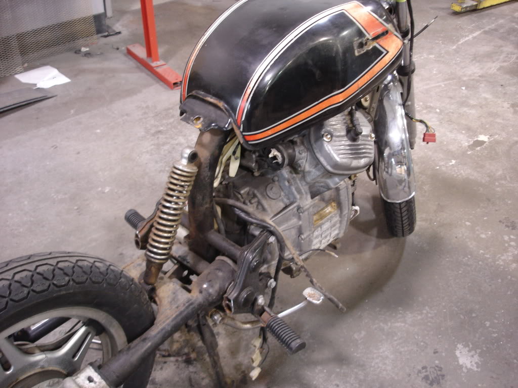

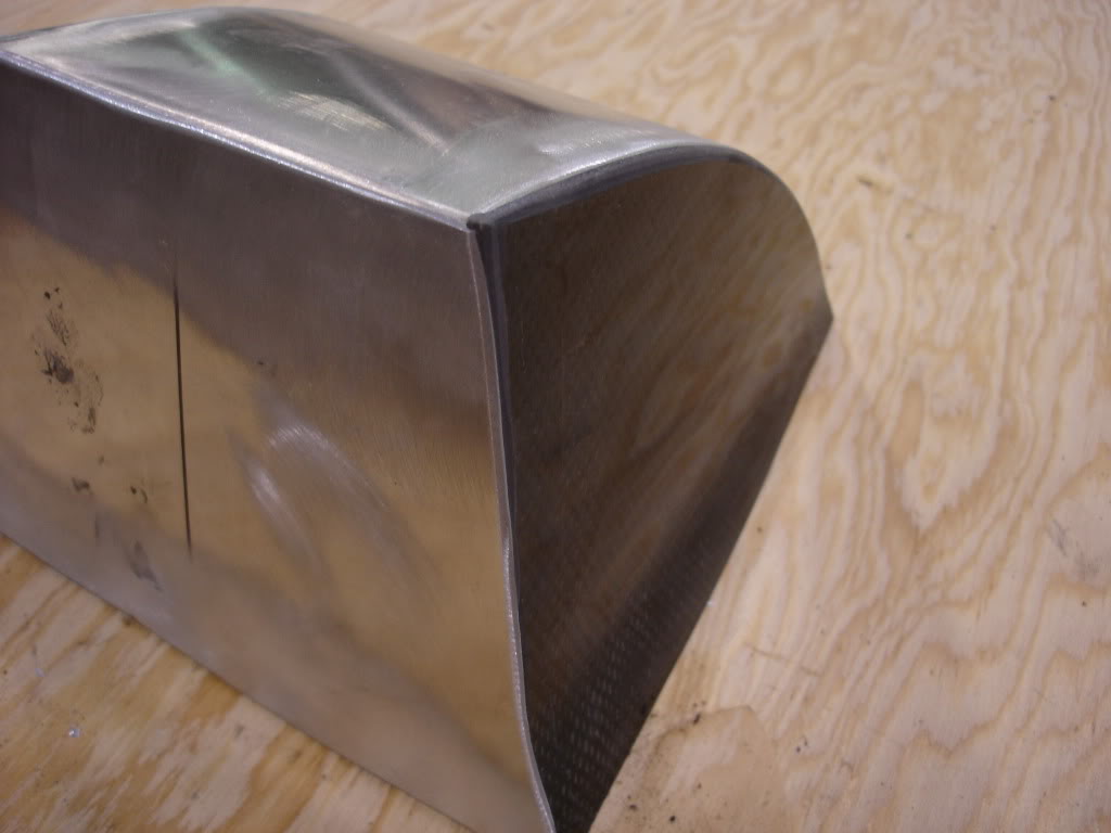

Alright folks. First business, I am trying to decide if I should paint over the carbon fiber or tie it in with the tank, or just leave a carbon fiber number showing? Second I am trying to decide dual or single exhaust and what material. If I keep the carbon fiber sided cowl how should I tie it in with the tank should I do the knee cut outs or should I make custom emblems? I probably do not have enough carbo fiber to make cans too so should I find aluminum cans?
Lots of q's here are a few pics.

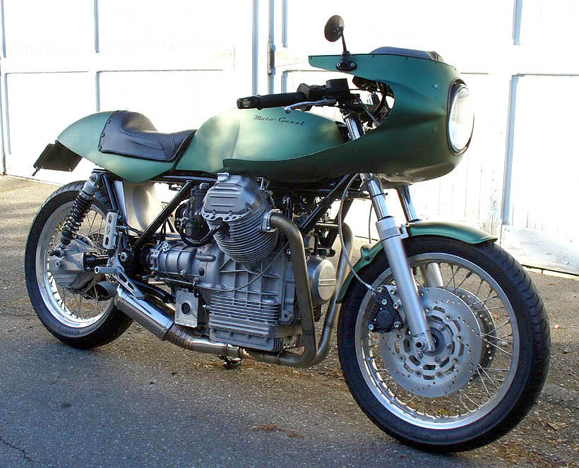

This is what I am thinking for the headers, I don't like the end though.

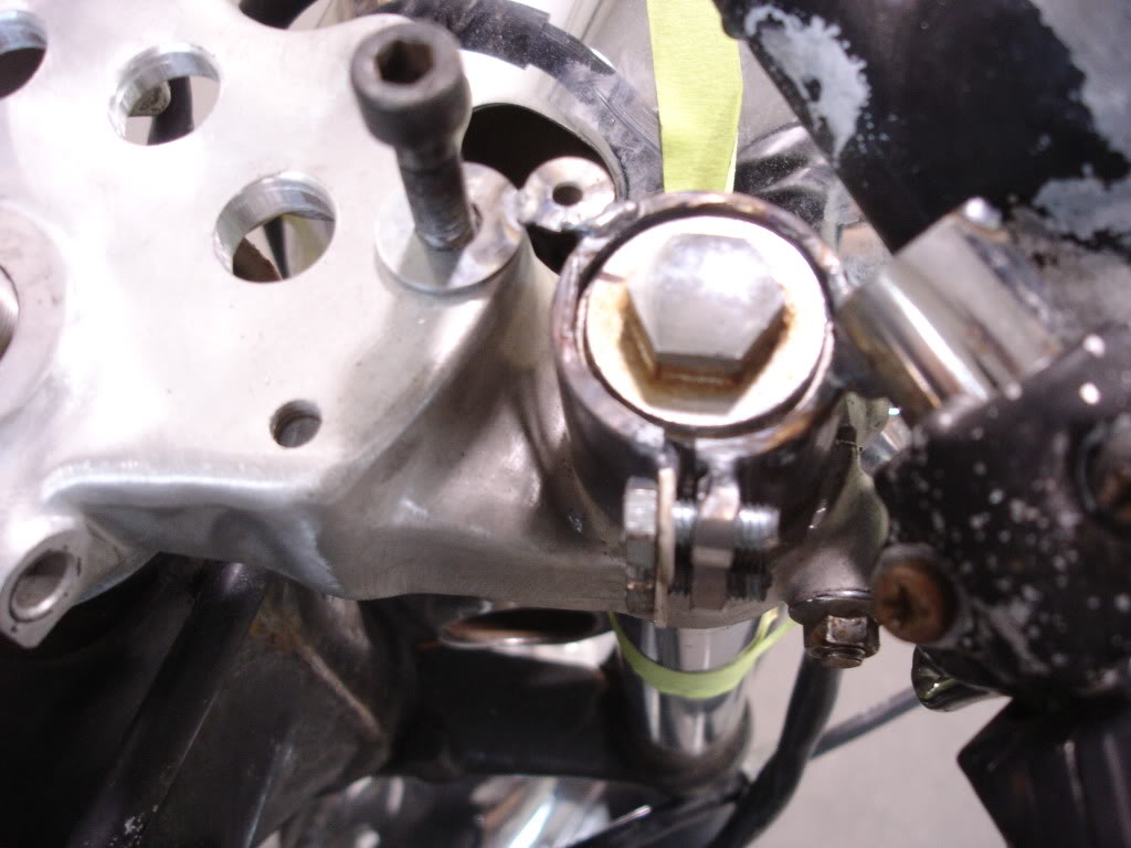

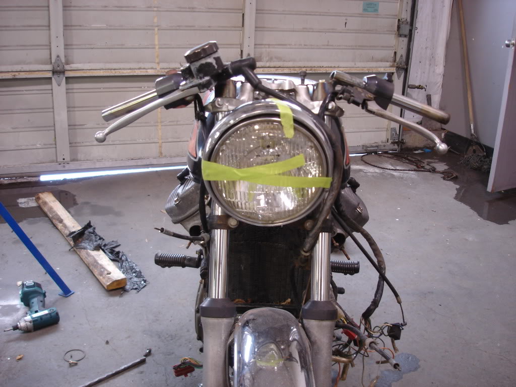

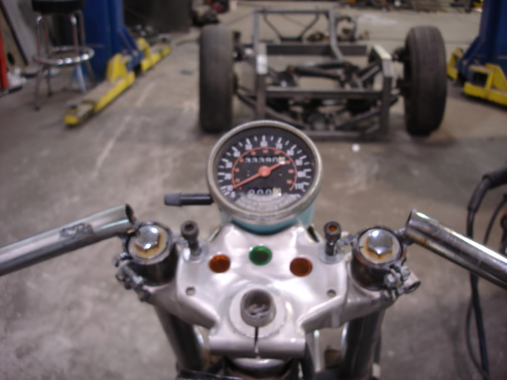

Clip on's and controls are starting to come together.

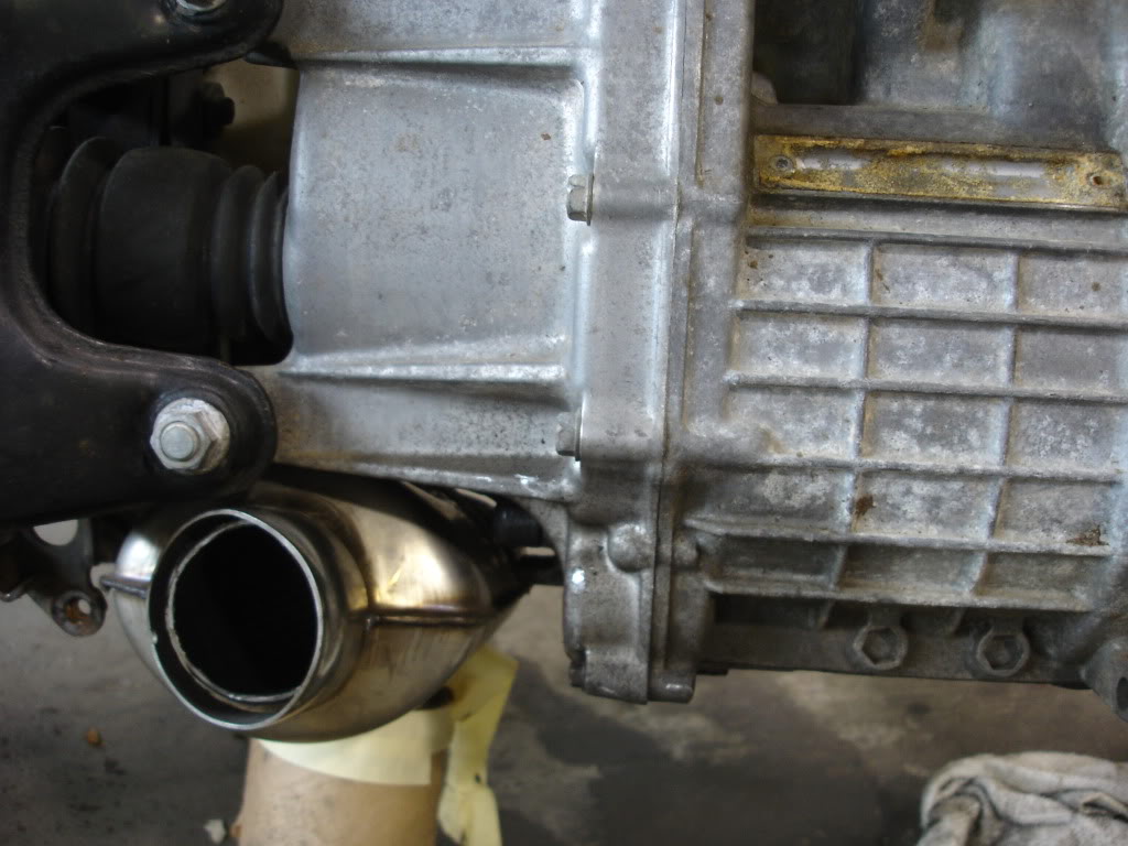

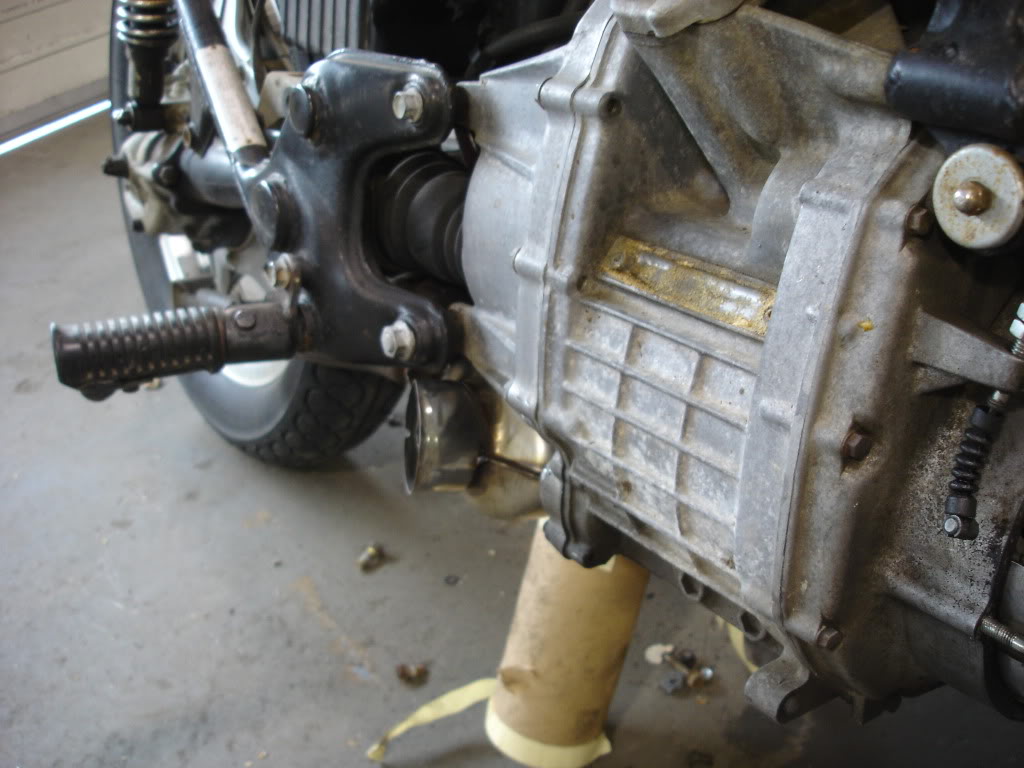

exhaust ideas
I have a audi resonator, I have used before and they sound awesome, So I am considering doing a side exit under engine exhaust. It keeps the weight really low. Like this.
Old Apr 6, 2010 | 03:37 PM
  #43
Just don't set it up to melt your Sister's boot.. Otherwise, looks good.

yes, a crossover would be a 2 into 1 into 2. As for the stepped headers, it would be smaller to larger (rather than the other way). Typically you would have to figure out some formula for the length using the engine speed, exhaust timing, etc etc. You could just figure out the length from the ex valve to the cross over and divide by three. It would be cool?!

Old Apr 6, 2010 | 06:37 PM
  #46
Looking at that photo showing the right footpeg, it's like I thought I remembered. You can just loosen the bolt and rotate the pegs backwards to get about an inch of rearset. That's how mine was set up when I bought it from the Honda tech.
He had that bike set up so nice, that I even had a couple of riders, at different times, ask me how I liked my Guzzi. They didn't notice the word "HONDA" on the sides of the tank.

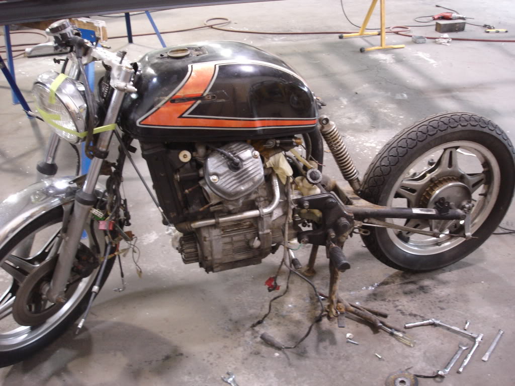

Old Apr 7, 2010 | 09:16 AM
  #50
Little_Horse's Avatar
2nd mouse gets the cheese
Posts: 1,697
From: Beaverton, OR
well she weighs less now

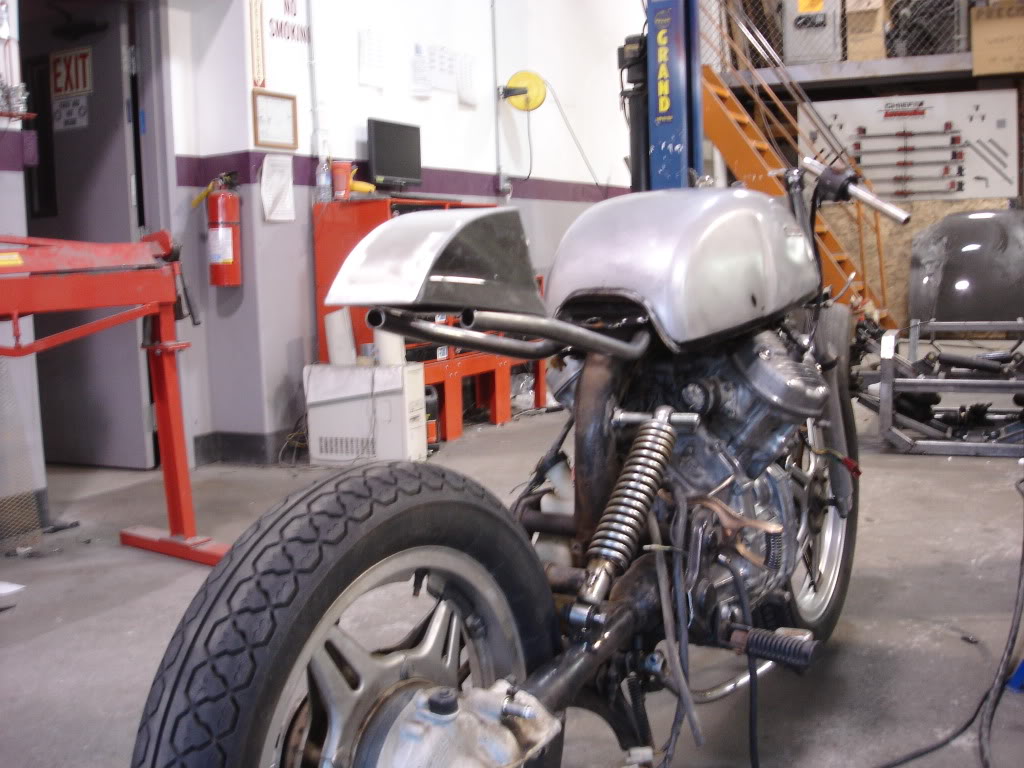

Tasty shots for the weekend
Nothing new until Tues or later. I know these shots will only leave you wanting more, I know this because I still want more and I am here. Peace!
