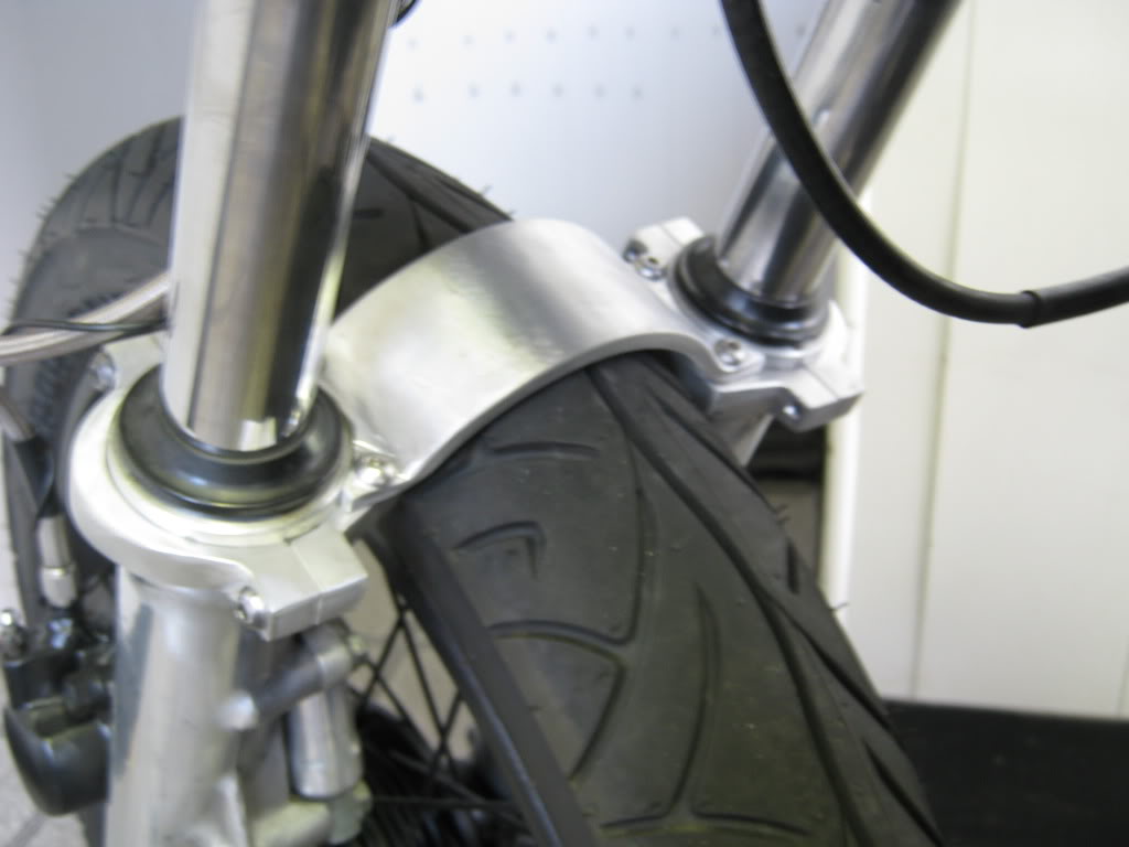

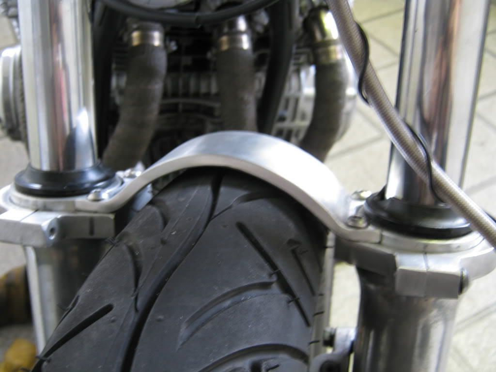

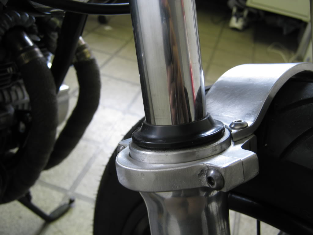

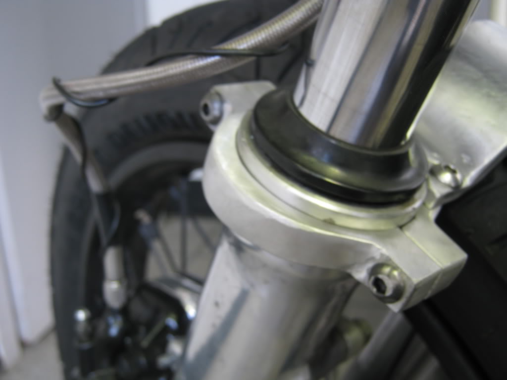

Fork Brace
So it was a real pain to build with the tools I have. a mill would have made this job a breeze. Anyways it turned out nicely I think, a little sanding and polish and it would look perfect. It really strengthened the forks, now I can't get them to twist like I could before.

dam, you're good. looks nice except for the absence of protectors....I know, you'll never need them cause you'll always be ahead of everyone. hahaha
