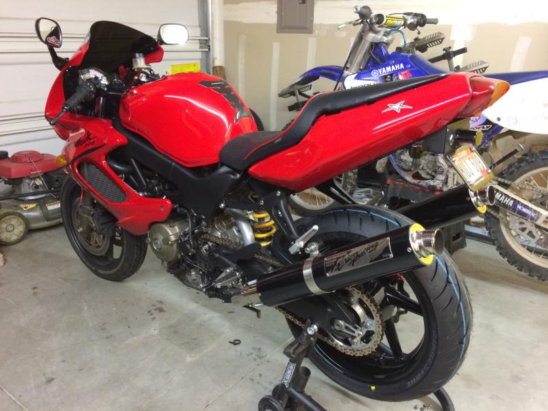

The journey is over... I got everything done this morning, and started the bike up... After figuring out which way was "ON" on the petcock, it started right up
I still have a few things to work out.
1-I think the new steering head bearings are loose. I may have to track down the castle nut tool and torque it properly
2-I need to tidy up the wiring on the bars
3-I need to make sure i have the HRC coolant bottle plumbed properly... Right now i have the radiator overflow tube routed through the cap and down to the bottom of the bottle. The other hole in the HRC coolant bottle is open to the air.
I think i'll get insurance back on it this Friday and test ride it
James

Pics
Old Feb 28, 2015 | 11:40 AM
  #127
thedeatons's Avatar
Joined: Feb 2013
Posts: 1,510
Another pic

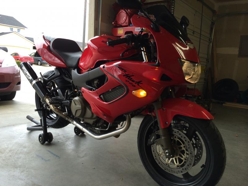

Old Feb 28, 2015 | 11:41 AM
  #128
thedeatons's Avatar
Joined: Feb 2013
Posts: 1,510
Last one

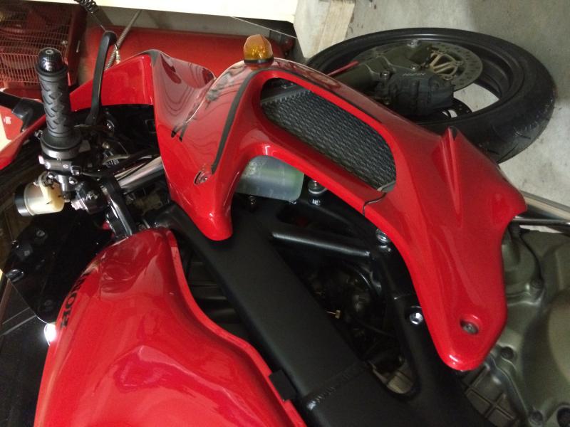

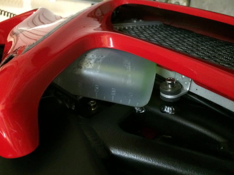

Coolant bottle 1
Old Mar 1, 2015 | 07:51 PM
  #144
thedeatons's Avatar
Joined: Feb 2013
Posts: 1,510
#2 pic
Old Mar 1, 2015 | 07:53 PM
  #145
thedeatons's Avatar
Joined: Feb 2013
Posts: 1,510
Let it be known that i'm not really happy with this location. Reason: the bottle moves a bit. There is nothing securing it in its position.
I really want to create a bracket for it, but i need to find the best place.
I really feel like my bike looks so "finished" everywhere, i just dont want a clear bottle with green liquid sticking out like a sore thumb... I'm still thinking on this one...
James
Old Mar 1, 2015 | 07:57 PM
  #146
Posts: 2,098
Paint it black or plastidip it leaving a "window" to read the level.
Old Mar 1, 2015 | 08:17 PM
  #147
thedeatons's Avatar
Joined: Feb 2013
Posts: 1,510
Lol... I thought about that
I'd like a bracket that goes behind the fairing bracket, and has a hole big enough for the bottle's mouth to go through, then the cap can screw on the top to keep the bottle in place...
James
