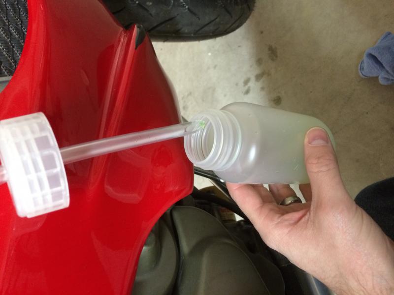

The hose from the radiator is fed right to the bottom, the overflow/ drain hose is up high so it doesn't siphon.
Sorry for the confusion.
Old Mar 5, 2015 | 04:57 PM
  #152
thedeatons's Avatar
Joined: Feb 2013
Posts: 1,510
This hose is fed from the top of the radiator neck, right below the radiator cap, coming out of the little nipple. I fed it to the bottom of the bottle, with a slash cut at the end of the tubing. Is this correct? The top of the cap has a vent hole in it, which just vents to open air.
Old Mar 5, 2015 | 05:25 PM
  #153
Posts: 2,098
Seems OK to me, except what happens if the bottle fills up? Don't you have an overflow line so it doesn't get all over whatever is under the bottle?
Old Mar 5, 2015 | 05:54 PM
  #154
thedeatons's Avatar
Joined: Feb 2013
Posts: 1,510
Yes, i need to install an overflow hose
I checked the coolant level tonight while on the sidestand, and topped it off. Took about an ounce.
I'll give more details as i change the overflow a bit...
James
Old Mar 6, 2015 | 02:19 AM
  #155
The vent hole is what I used for the overflow hose.
I used clear plastic tubing and ran it inside the frame down to the left hand front of the engine where all the other drain hoses go.
Don't push it all the way to the bottom of the bottle or it will act as a siphon.
When I first fitted it I put it right to the bottom and it drained the coolant.
Place it up high to allow for the fact that the cooling system may expel some coolant into the bottle during operation.
That way it won't siphon.
Works for me.
Fit an overflow line James and all will be well.

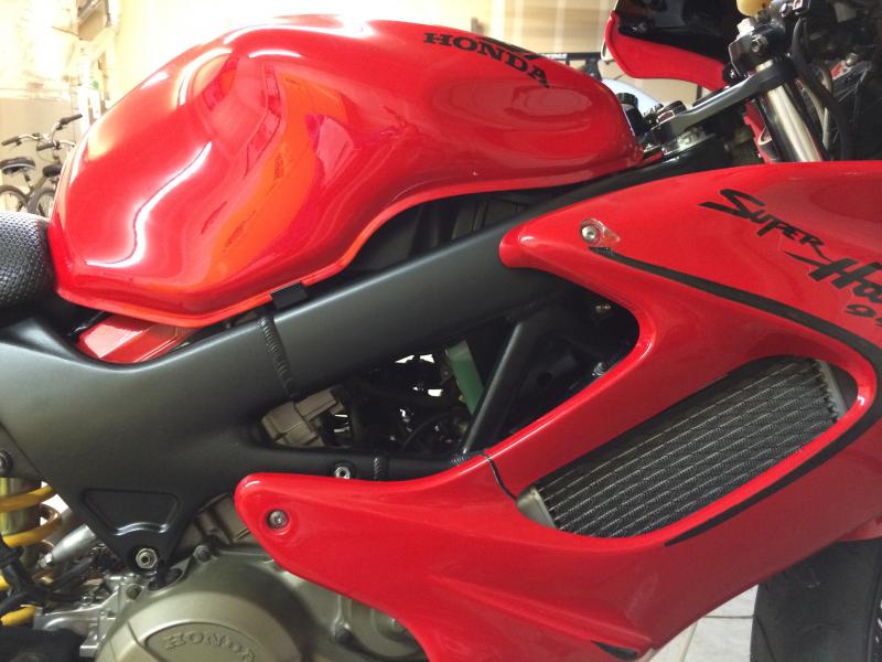

Old Mar 6, 2015 | 08:11 PM
  #156
thedeatons's Avatar
Joined: Feb 2013
Posts: 1,510
Okie dokie... Here is where i'm at... The HRC bottle is great, and gave me great insight, but i'm not gonna use it. (Anyone looking for one?)
I ended up ordering a 4oz rectangular wide mouth Nalgene bottle, and fabbing up a super-ugly (temporary) aluminum bracket...
I mounted the bracket to the bottom of the airbox using the exidting threaded hole and phillips screw (remnants from the PAIR removal).
The Nalgene bottle is tilted to match the angle of the air intake shroud edge.
Here is a picture, which is most likely better than any words I could use.
James

Old Mar 6, 2015 | 10:40 PM
  #158
Nice work man. In my opinion, that's what the factory installation should have looked like.
Old Mar 6, 2015 | 11:20 PM
  #159
Much better than the way you had the HRC.
That's why mine is in the tail.
Love the red Rocker Covers.
James,
You have certainly upped the ante with this build.
Congrats, your bike is cool. You must be very happy.
I am still working on the thermo by the way!
Why not put it in the bike of the month?
It certainly is an inspiration for me.

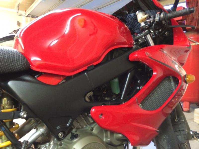

Old Mar 20, 2015 | 07:09 PM
  #162
thedeatons's Avatar
Joined: Feb 2013
Posts: 1,510

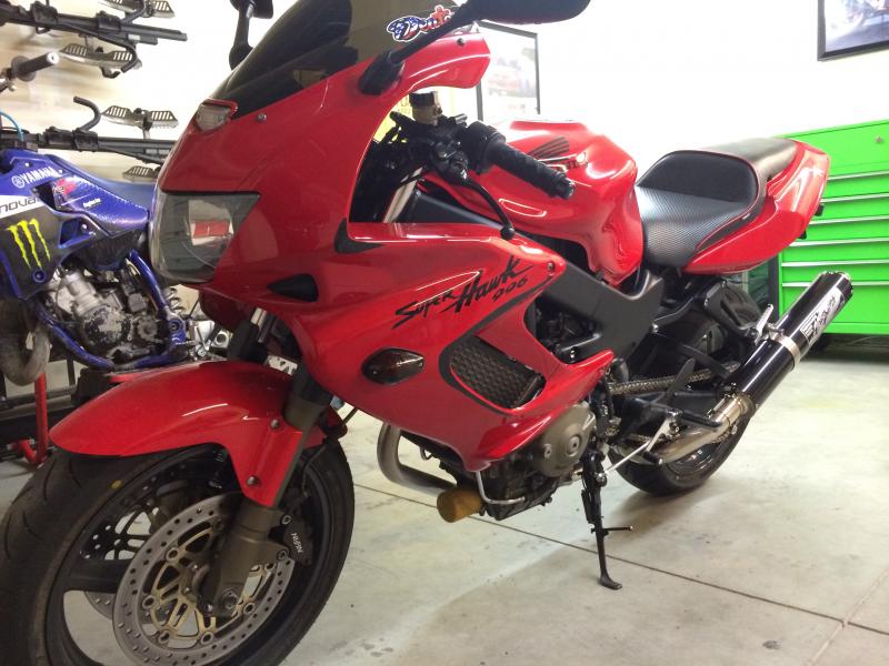

Installed Lockhart Phillips Flush Mount III smoked single filament turn signals today on the front... I didn't particularly like the orange lenses, and Lockhart gave me a great deal on these.
I was originally going to install something much smaller, but when the orange lensed signals were installed before they left screw marks in the fairing, so I had to keep that covered up.... So I ended up with the same thing in smoke, minus the running light, which I didn't like either.
I suppose now I have an extra wire left over for a charging cable lol.
James

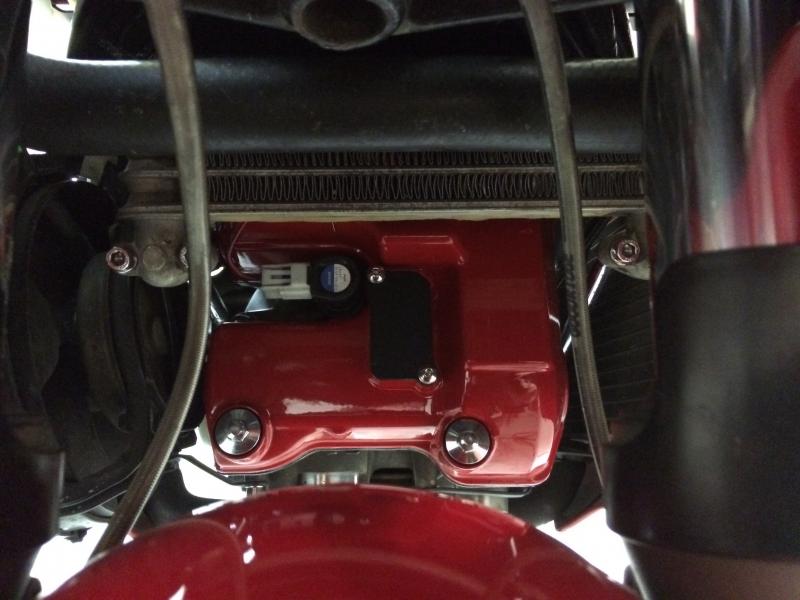

Old Apr 23, 2015 | 07:51 PM
  #170
thedeatons's Avatar
Joined: Feb 2013
Posts: 1,510
Since the last post i have done the following:
Resynced the carbs
Rerouted the choke cable
Installed a new air filter
Set my rear brake light switch so it doesn't come on when i trail brake in corners
Tightened the steering head bearings (again)
Ground the nubs off the clip on handlebars (now i can really adjust them however I want)
Gone through a tank of gas mixed with Seafoam
Rerouted a couple hoses and wires so they aren't laying on the red cam covers
Hoping to ride it more late this weekend and next week... Interested to see how the new air filter affects cold startup...

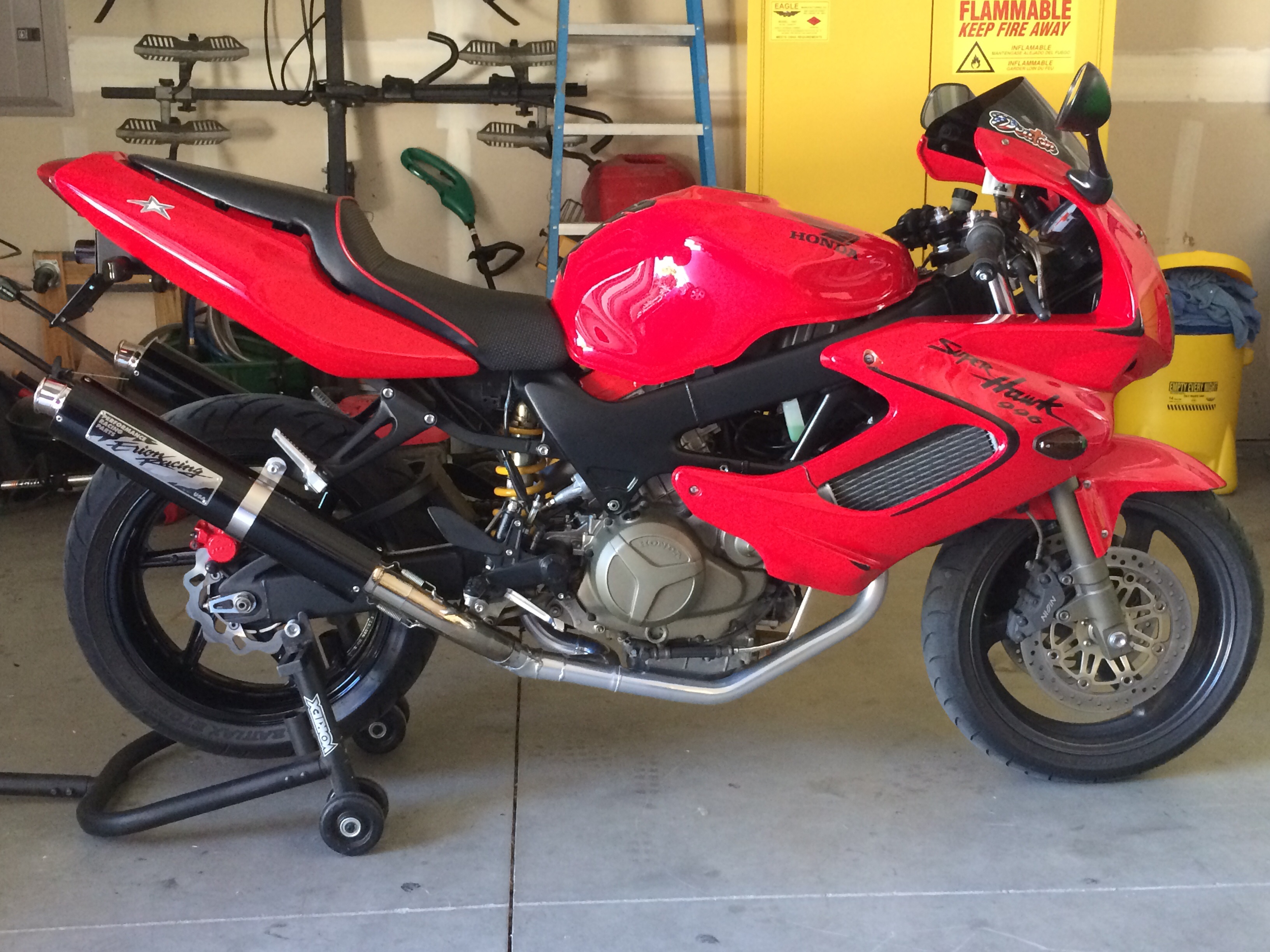

Old Jun 23, 2015 | 07:37 PM
  #171
thedeatons's Avatar
Joined: Feb 2013
Posts: 1,510
Just to keep my build thread moving a bit... Here is the winter 2015 powdercoating list (black):
Alternator cover
Clutch cover
Water pump cover
Starter casing
Kickstand
Suspension dogbones
Suspension knuckle
Shock spring
Coolant bottle bracket
Twist throttle housing
Oil pan
Lower cowl bracket
Gas cap
James

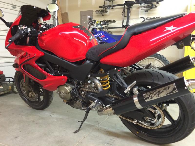

Old Sep 5, 2015 | 01:05 PM
  #180
thedeatons's Avatar
Joined: Feb 2013
Posts: 1,510
Just finished installing my 1.25" Woodcraft return spring! Also took a moment to install a new rear brake master cylinder rubber boot.
I removed the jam nut when installing the cup and spring so i could get more clearance to run the brake pedal even lower. I like running it low so I don't accidentally stab it. When I use it for trail braking it is low so i only apply a little bit of force, and now the return spring definitely improves the feel!
James
