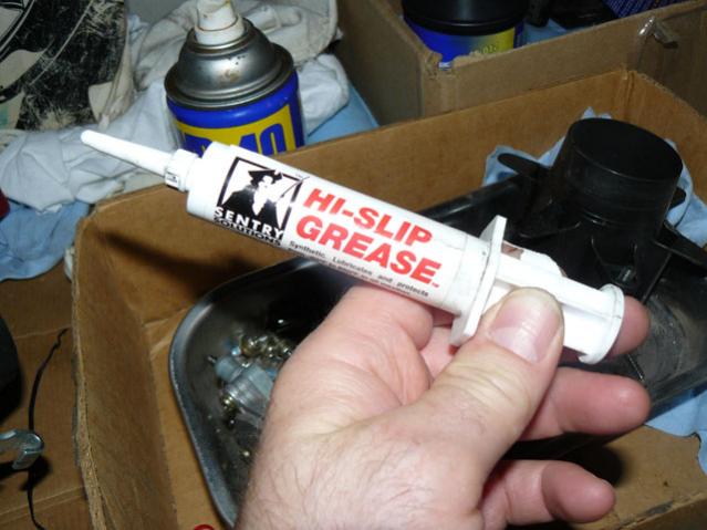

i didn't fare so well with that fork-slider nut, but hey. i'm really proud of my home-made streering stem socket. and that hard-to-find molybdenum disulfide grease... complements of you friendly neighborhood gunshop.
Attached Thumbnails Motor/Frame Locking Nuts Removal Tools-socket.jpg   Motor/Frame Locking Nuts Removal Tools-mds.jpg
