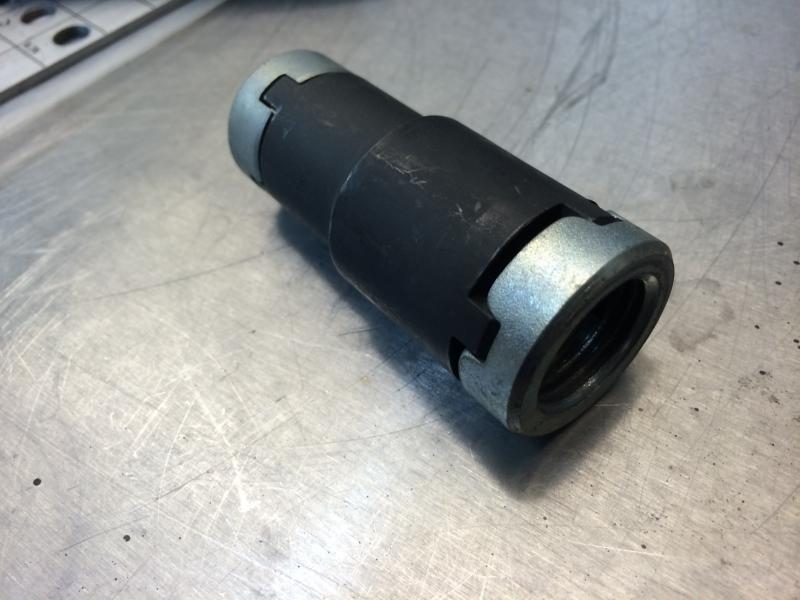

Castle Nut Tool for the frame
Rather than buying the pricy Honda tools, I did some measuring and compared some old threads and found the frame castle nuts measured 20mm, and 24mm.
A google search turned up a double sided tool, which i found on Ebay for $9.95 shipped. The tool arrived today, and i used it with a 1/2" ratchet and extension to remove the three frame castle nuts!
James

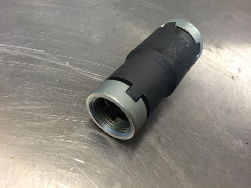

Picture 2

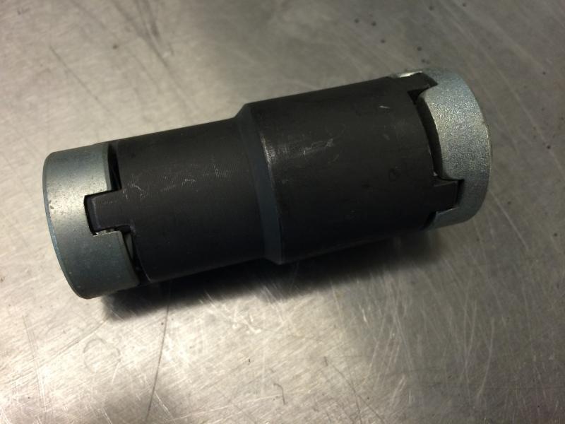

Picture 3

Old Dec 3, 2014 | 08:47 PM
Hey deat, can you post a link to the fleabay description/auction where you found this or tell the wording you used to find it? Great and smart discovery. Wish I thought of it.
Old Dec 3, 2014 | 09:08 PM
thedeatons's Avatar
Joined: Feb 2013
Posts: 1,510
I think i googled searched "30mm 24mm castle tool" or something like that. Sometimes the more vague you are, the more you find.
James

Old Dec 4, 2014 | 06:21 AM
James
Well done.... and nice find.
I have then tooling and machines to make that, but no way is it worth the time spent vs the $14 shipped I found thanks to you.
Not the $9 deal you got (that seller had only the one) but still $14 saving me 3 hours of time on the lathe and mil... Oh ya.
