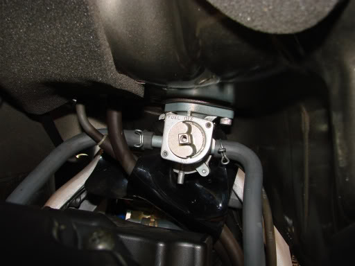

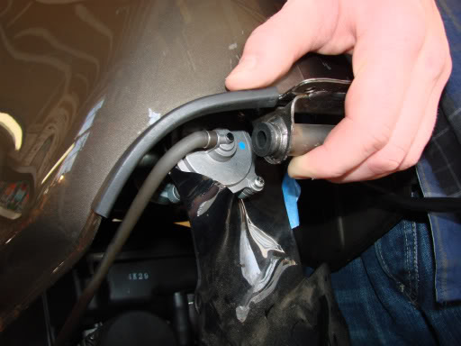

Originally Posted by residentg
Photos of the fuel valve before taking off the tank. Note the hoses, and in particular that NO hose is attached to the bottom post. This is the correct hose configuration. The valve is in the ON position.
Front
Rear
Re-posting this thread for all you newbies! I just completed re-painting my tank and fairing, and thought I was a smart *** so I labeled all the hoses and connections. Put every thing back together after a long day and decided to crank her up! She ran for a minute than died. So I thought, must have gotten some water in the tank, let me run and fill a gas can to perk her up with some new fuel. Hit the starter again, and she just moaned and died. So at this point, I'm cussing and finally thinking, let me go to the good old PVLIR thread and check my connections. DAMN, vacuum hose up front, and wrong hose in back port. Saved again by this wonderful thread. If you are having engine stutter, backfires, she won't crank, etc. Check out this thread!

This post just saved me! I have spent the last ten days trying to get mt bike to run and stumbled upon this thread. I moved the vacuum hose from the bottom to the rear and it fires right up! I still need to do some tuning, but at least it runs now. The moderators should consider making this a sticky.
Front
Attachment 27568
Rear
Attachment 27569
11 years later and you just brought my bike back with this simple picture. Thank you!
