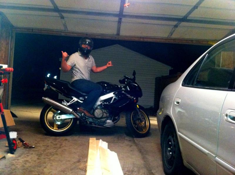

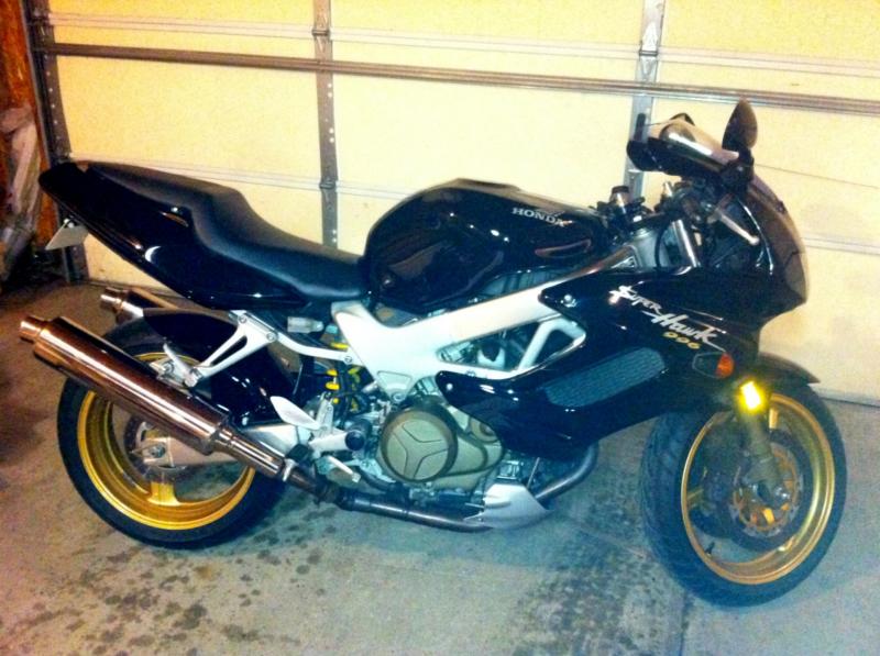

I've got the first 100 miles on my new guy. Yeah I know I definitely overpaid for it. I merely justify it to myself by telling myself that $500 or more I overpaid is going to be distributed over at least the two years that I'll own it.... No buyer's remorse so far. I've actually had my heart set on exactly a 2004 superhawk in black with gold wheels since I started riding that year. The salesman also knew I drove 6 hours to get there and he also saw me pull up with a trailer in tow. As promised, here are some pics. The salesman did throw in some flush mount signals to "sweeten" the deal heh
Attached Thumbnails What to look out for if buying used '04 SH?-photo3_1.jpg   What to look out for if buying used '04 SH?-photo2_1.jpg

It's a good looking bike, and if it's exactly what you have been lusting over, a few extra hundred ain't nothin!
