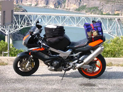

Old Feb 23, 2008 | 07:27 AM
superbling's Avatar
Posts: 2,553
From: South Texas
I made superbling in to a sport-tourer (larger tank, higher bars, lower pegs, bigger screen, better seat, etc):
that truly rivaled my VFR's but most folks would rather just opt and get the VFR instead.
