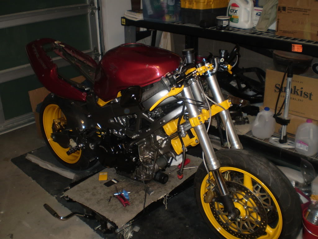

A little bit more fun tonight:
Is it just the perspective, or is your left brake line too short?
Can't wait to see the final results!
Just perspective I think- I'm sure it's just coming right at the camera b/c the right and left lines have about the same amount of "slack"
got the side covers on... they look way less black in real life... that's what she said...

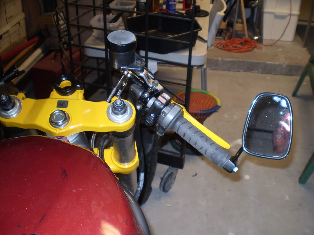

Got the subframe stripped today and was antsy to see what I had left so threw some stuff on. Man, the proportions change a lot with a tank and tail. I kinda liked it so bare, but also like having a gas tank... And one of my points was to keep the ability to carry a passenger...
Put on some end mirrors- definitely give a good rear view, still trying to decide if I like the width/looks.

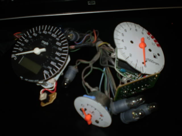

But I do have some ideas for the gauges. Took them out of the housing that was uncovered and spread out to fit under the nice stock fairing. Hoping to make a custom housing with the same electronics so I don't have to deal with aftermarket/gauges from different bikes, etc. In my world I'm avoiding work by doing this because thinking about dealing with the electronics... I'm just messing with the housing...
Out:
Thinking about sticking tweety's gear indicator in there... it would be cool... the only reason not to would be because I already have too much info for a naked bike anyway. Hell, I may do away with the tach...

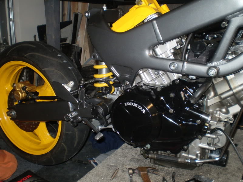

Waiting for parts, figuring out a bunch of odds and ends with electronics, but got a little bit of hands on stuff done. I had cleaned the rust off of my exhaust and hit it with a light coat of flameproof paint awhile back and finally got around to wrapping it. Used a 50' x 1" black roll and it was about 2 feet short... go figure.
One more item of bu'ness down, less parts on the shelf than on my bike now so really starting to feel like this is gonna happen!

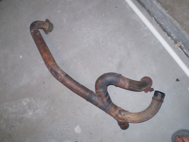

50' is unreal.................but you did an incredibly neat, OCD wrap-job. If you add that pic to your resume, you're sure to get that gift-wrapping job at the local department store. I'm sending you my pipes. Nice job on the build!

Originally Posted by nath981
50' is unreal.................but you did an incredibly neat, OCD wrap-job!
My friend told me he would do it better because he used to wrap hockey sticks or something like that, so I had to prove him wrong! It helped to have two of us- him feeding the wrap through the water bucket and me focusing on getting the tight 1/4 inch overlap.

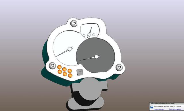

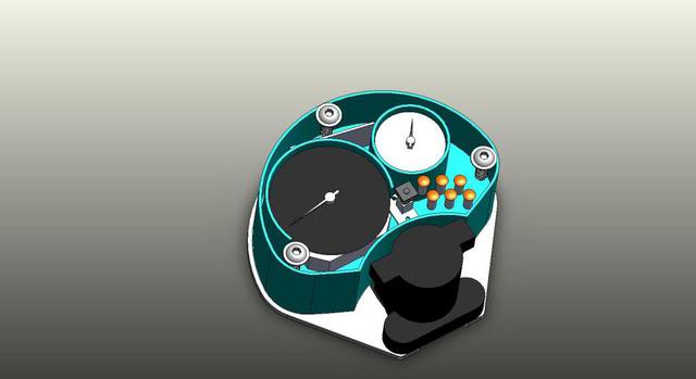

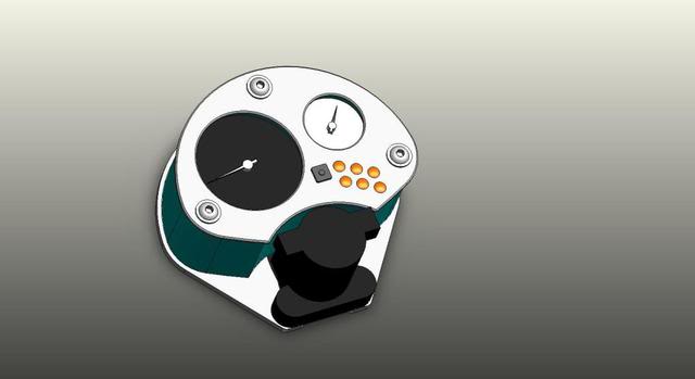

I think I have my final layout/mount for the gauges... Mounting to the two bolts under the key switch. They're a little close together for comfort and the lever arm on this thing will be a little long, but I have a feeling if I'm careful and rubber mount the whole setup it won't be too bad. I am planning on water jet cutting the top and bottom pieces out of aluminum (white parts) and either machine out of ABS or FDM print the middle plastic piece (teal part)... We'll see how pricing ends up on these.
The internals aren't structurally friendly yet, but everything fits inside and it should fit between my brake/clutch lines.
looks pretty wild, except that I use the tach more than the speedo, so you'll need to add it when you make mine. haha
Old Dec 14, 2010 | 08:57 AM
  #112
I went back and forth on this SO many times! It would be nice (if not necessary) to have a tach when tuning or for analyzing the bike on rides. I'm sure all of the people who like to really get into the performance of their bike out there will be disgusted by my lack of respect towards the tach!
I almost went with the tach instead, but... This is going to be a pure street bike and I have a feeling I may have to pass and inspection or two (still can't find the title to the frame when I bought it) and that would be pretty tough to do w/out a speedometer I also find that I use the mileage gauge that is attached to the speedo for overall miles as well as trip miles and didn't want to part with it. I think the guy that is going to help me synch my carbs has one of those instruments that attaches to the spark plug wires to tell what the RPM's are. Either way, my Shadow doesn't have one so I know there are ways around it!
Haha- actually, temp is most important in my mind b/c of the custom radiator system- I want to keep that part monitored!
I really wanted to try making gauges (it'll probably be the only thing I didn't use for inspiration or outright copy from someone else haha) and like the idea of smaller, more basic ones for the naked look so think that I have as close to that as I can get without upsetting the usefulness of the bike yet. If I find it won't work I'll get some CBR gauges or a Trail Tech or something.

yeah, you need the speedo/odo for sure, that's why I said "add it" in lieu of one or the other. Maybe you can put the tach and speedo together and the temp guage in a separate location?
in terms of the naked bike concept, to me it's kinda function over form, asymmetric, not predictable, but makin it look cool as you can.

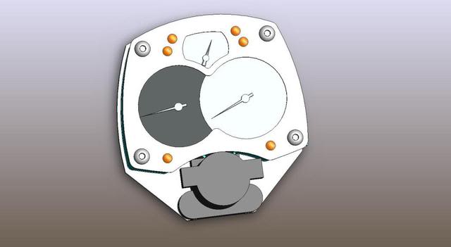

I win! I saw someone mention cutting their gauge faces... didn't take me 30 seconds to realize I could overlap mine... the overlap causes the needles to offset so they don't collide, the new layout actually takes up a little LESS width (I was running close to my brake cables), speedo still reads up to 120mph... Now I can have my cake and eat it too!
It's not asymmetric- I actually tried doing that b/c I agree that the asymmetry looks cooler, but this was the most compact that I could get it. Ok nath, you can rest easy now!

that'll work. Depending on the rigidity of the framing material, you may be able to reduce the width from the edge of the circle to the outer edge, and/or move the tach down and outward, the speedo up and outward, and the temp to the right and down.
the overlap looks trick though if that has to be!

Actually if you swap them over, with the tach needle not going full circle it's going to be even easier to make it fit...

Ok, I hate to say it , but you guys are both on to something here...
It's pretty finniky because I have all of the instruments underneath the faces to deal with too (It's not just as simple as placing the faces wherever I want, there are some physical restrictions)

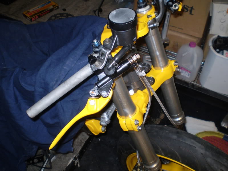

Anyway, the symmetry was bothering me for some reason the more I thought about it, then Tweety pointed out the big open space on the Tach just waiting to have a gauge overlap it... We are way over 10 hours now, but I am happy with the result! Sent the center out today to get a quote on machining the middle part out of ABS... I think I can waterjet cut the aluminum faceplate and backplate for pretty cheap so not worried there...

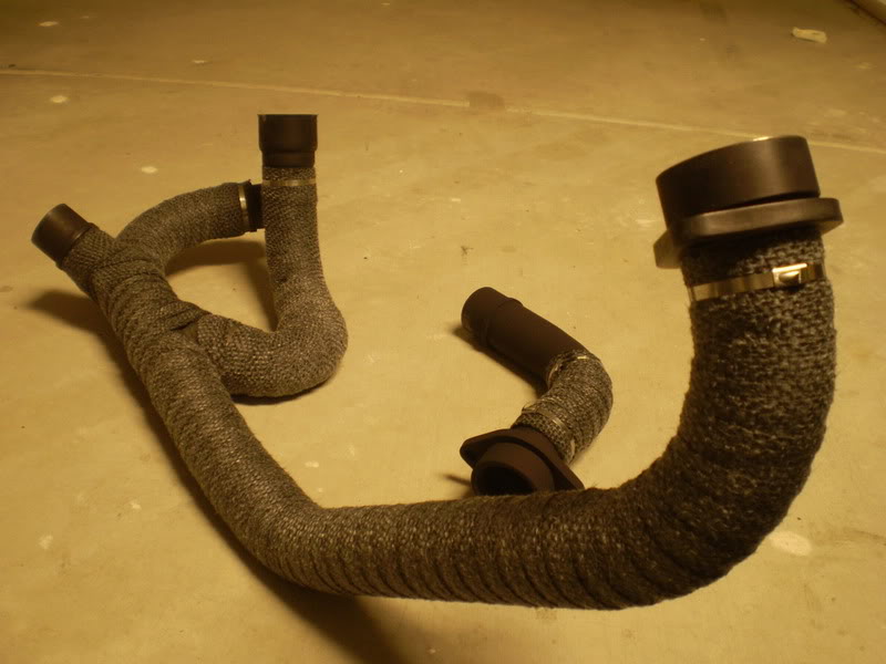

I had my header wrapped for a while just like your with the darker colored stuff.
The first time just left it bare. It faded quickly and road debris really took a toll on the underside. It didn't last long.
The second time I covered the entire thing with 3 or 4 coats of that high temp ceramic paint (black). It looked sharp and the paint gave it a nice tough shell. It lasted quite a while. Would probably still be there if I didn't manage to scrape it off on a right hander.
My advise...paint it. Then maybe top the whole thing off with high temp silicone spray, if you can find any.

+1 Yeah, it would be a travesty to have this beautiful wrap-job erode prematurely.
There are many options for high temp paints and other coatings that may protect and extend the service life of pipe wrap.
For example, this stainless steel paint is good for 1200 degrees:

I've already hit it with exhaust wrap silicon spray- makes it look waaaay dark and nice:
