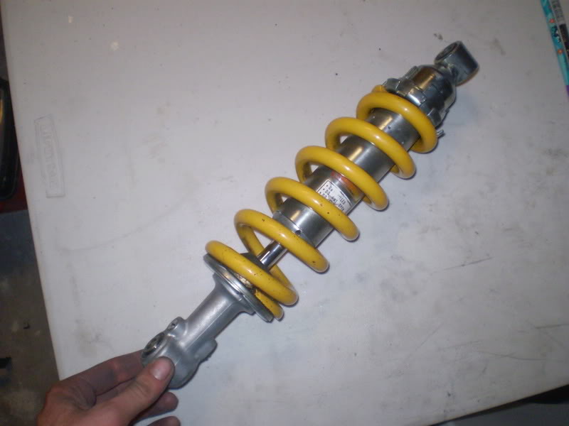

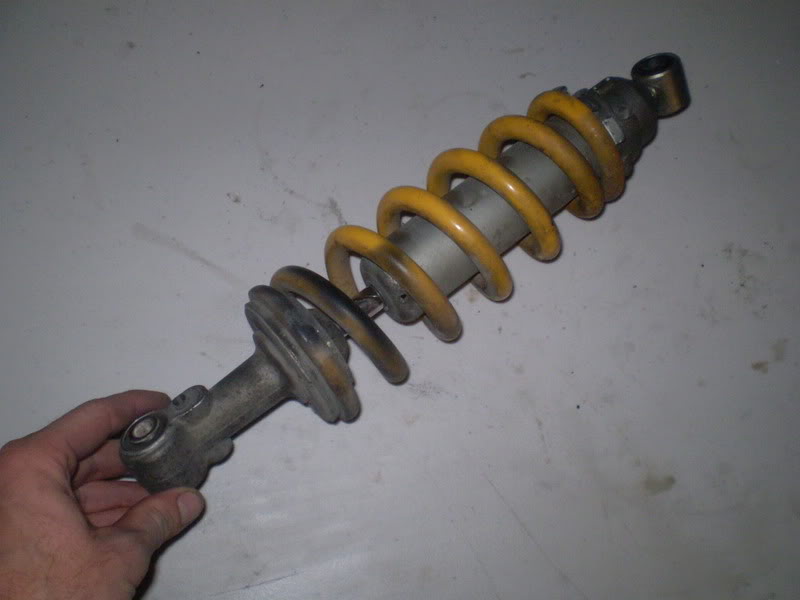

Shock/spring= disengaged and in my hands. Heard some rattling so turned it upside down and shook some boulder sized rocks out. Hmmm. I also bought the wrong size socket to get the swingarm pivot bolt off so that'll have to wait another day or two. Probably using the wrong terminology but whatev, as long as my head organizes it so that I can understand it again later. I did get my new wheel/rotors in so am that much closer to a cbr 929rr front end now!
Check it! 929rr vs VTR:

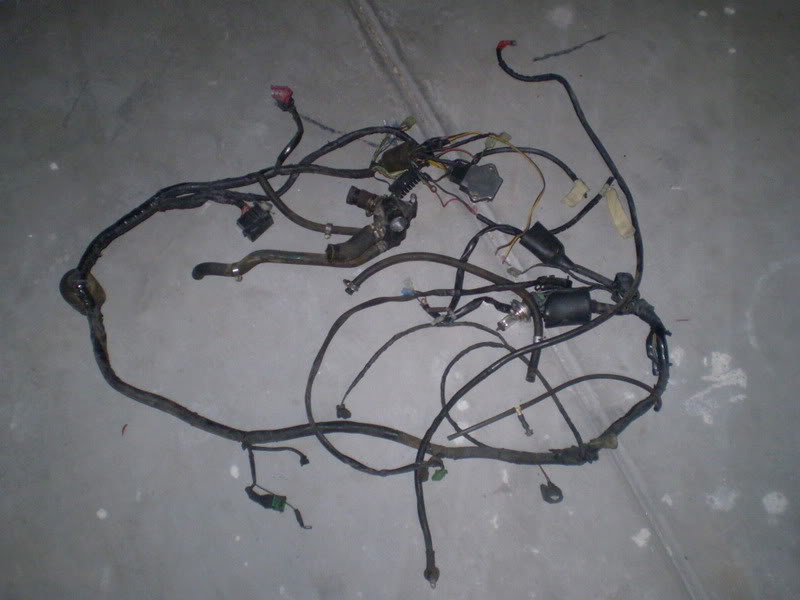

More stuff that is probably only interesting to me, but in these days of twitter and facebook, I post to the public my personal activities in place of actual human interaction:

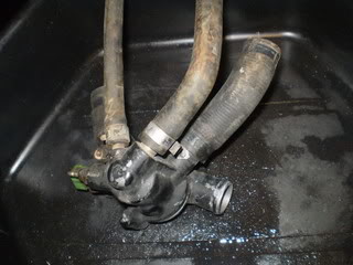

De-wired the nervous system. This stuff all just looks really messy to me. Is there any criteria for inspecting/cleaning the wires? A lot of the tape has black overspray from some paint job in the past, and that bugs me. I plan on removing it all and replacing it with basic electrician's tape, unless this is a bad idea?
Thanks for the advice on making a castle socket! Worked out great and save bunches. I finished the one for the frame nuts, now just have to make one for the downtube one.

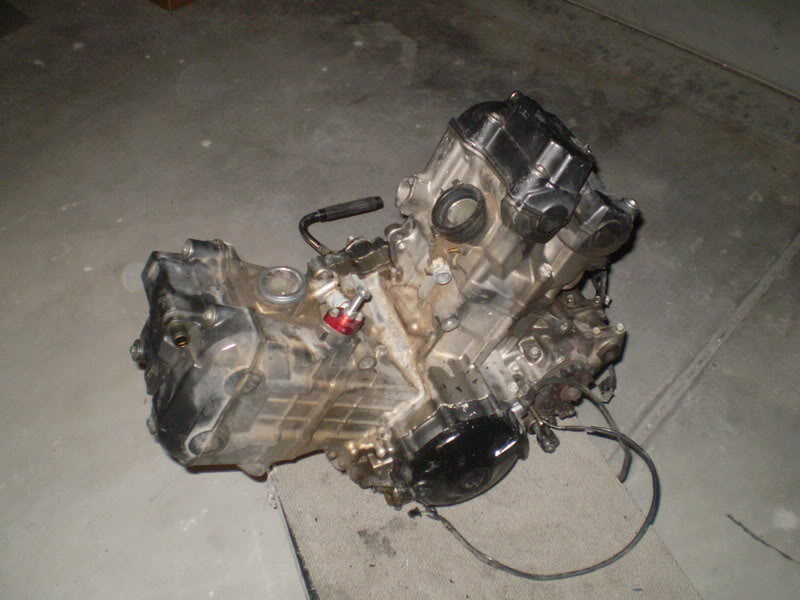

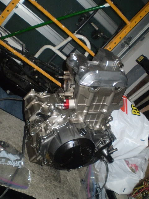

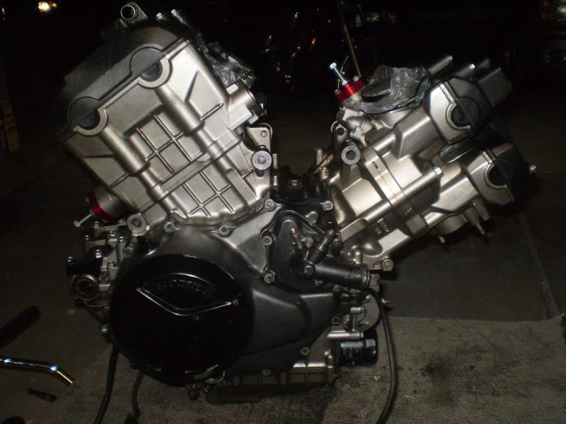

Bam! Engine! The beating heart of this somewhat neglected but full of character machine. Well, here's where I'm going to start needing advice... for those who want to give it. I'm planning on cleaning and putting together everything slowly. I'm already curious about several things such as: can I replace the hoses with general ones that are the same size in hardware stores? or is it best to order OEM.
What do I do with this while it's out? Suggestions? I'm looking for anything that will help longevity and performance, in that order...
And the reason this whole project started:
Now, I gotta re-organize all of my stuff and start making a list of things I need from the dealer. Sure is cool seeing that huge motor all packed up inside of things. Way different from a car, with most of the same pieces. Just all between the legs. Still fascinating me...

Well since it already has APES the major longevity worry is taken care of. The R/R you should replace too, but otherwise feed them gas and change their oil regularly and you should be good. (well regular maint too, drive chain, valve check etc but those are standard for a motorcycle)

Got the R1 r/r sitting on the shelf waiting to be put on! Valve check.... I'll have to look that one up.

More stuff that is probably only interesting to me, but in these days of twitter and facebook, I post to the public my personal activities in place of actual human interaction...
That my friend, if ******* hilarious LOL! Glad to see you dive in head first, good job. In terms of mechanic work bikes are so much nicer to work on than cars. There's no crawling around on the ground under a dirty *** car. No contorting your body to get to a fraggle-assed part. Most of the time bikes don't leak oil so you're dealing with clean, well designed aluminum parts. Really rather relaxing if you ask me.
-Don't fool with auto store hoses, thats way more trouble than it's worth. Hook up with someone parting a bike if you need specific bits like that.
-There's been good advice for the longevity part, and I can't imagine you have the funds to go very far with the performance part. Order a jet kit and a good airfilter if it doesn't have that stuff already already. I think the bike already had a good pair of mufflers, if not you can find a good pair in the classifieds. Scumbag has some really nice carbon kevlar mufflers that look great for cheap.
-Personally, I wouldn't mess with the wiring. That electrical tape isn't very reliable or long lasting, if you insist on replacing it look on eBay motors or here for a cheap new harness.
-Other than that, go to the auto parts store, get a bucket, and fill it with different styles of brushes, then get some degreaser like kerosene or mineral spirits or simple green and clean the crap off of everything. That alone makes a huge difference, and just cleaning things with mineral spirits will get most of that overspray off too.

Yeah, not really looking to do much with performance. At this point the bike has more in it than I can use anyway, so just want to keep it thumping for awhile. I tried mineral spirits- cleaned most of the dirt/grease/grime/tarnish off the engine, but the overspray is still pretty apparent. Simple green is simply amazing too. Is it worth trying to use turpentine or should I focus on other parts of the bike?
I do plan on going through the manual and checking what I can- all this valve check talk and such will be addressed if it's easy enough b/c it would be nice to know that I did something other than remove .25 lbs of grime.

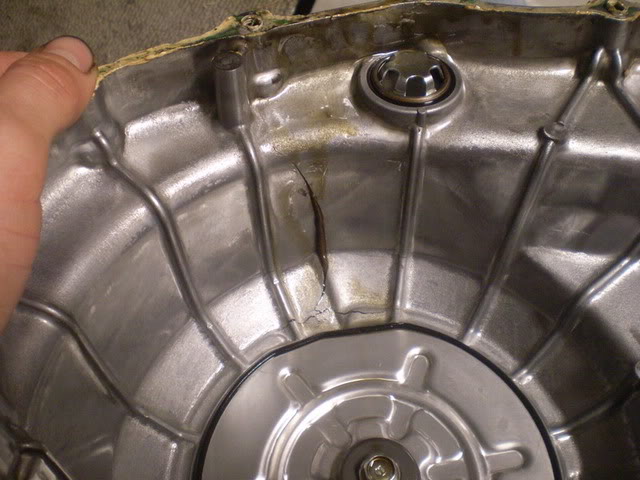

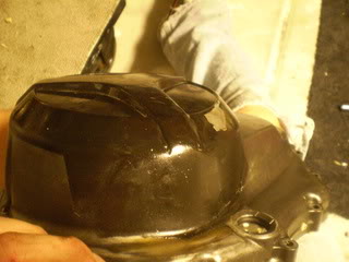

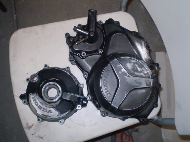

If your clutch cover is painted black and bubbling, a-like so:
Then the inside may look something like this:
I bought my motorcycle very custom. I will definitely be on the lookout on my next purchase. Maybe I can send all of these pics to the PO and show him what his ride really was like... I have a feeling he didn't know from talking to him b/c all he said he'd done is change the oil regularly and put coolant in it every once in awhile (this last part now sounds strange to me, but at the time I just wanted a Superhawk!)

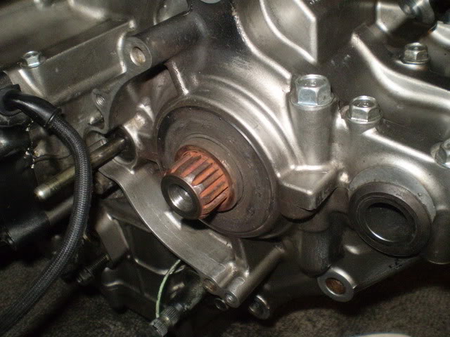

Should I worry about this rust?

Big discovery today for me was that the alternator ALSO is in the same oil bath that pretty much the whole bike is in. That oil ... it is just passed around everywhere. I only somewhat recently learned that the clutch was "wet" and now this? I only a basic understanding of electrical stuff, and for some was weirded out by having electrical magnetic hoochie wah current passing through oil. Makes sense I guess... just have to get used to the idea.

I stripped these things with the intention to re-paint them and I think I just discovered awesome mode! Is there any reason I can't keep them shiny, being aluminum and all? Plus I should go faster cause they're lighter, right? And probably cool down quicker... Definitely a performance thing and not aesthetic at all...

the rust... get some moly grease and load the spline up. It will prevent this in the future.

autoteach- thanks for the tip on the rust. and I finally read your whole list of mods- made my night, those last two did!

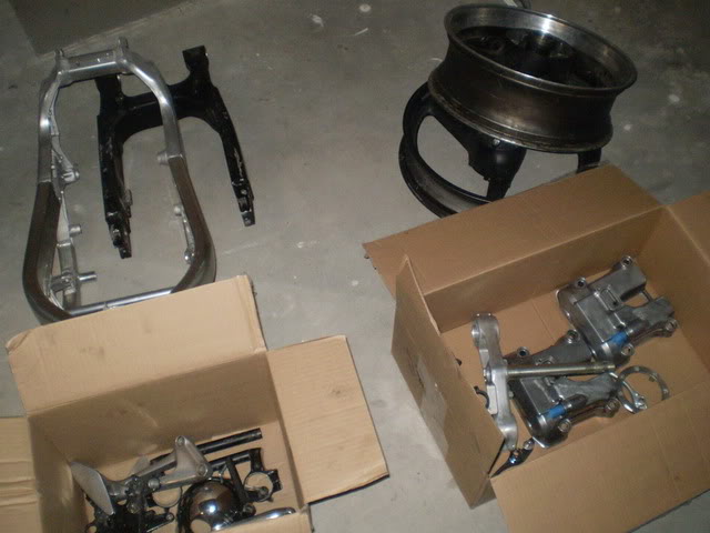

More small pieces are coming apart, been doing stuff like this:
after:

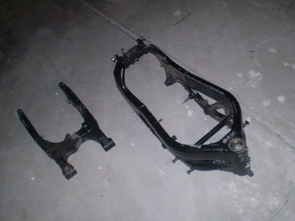

And organizing a plan of attack. After sanding part of the frame to prep for powdercoat, I'm liking the idea of polishing it and just PCing the wheels. Anything is possible, I suppose...

For the engine housing I'm just using simple green and nylon brushes/cotton rags. All those corroded aluminum bits: WD-40 seems to be working best in combo with steel brushes. My current theory is that it'll keep them more resistant to tarnishing and easier to clean off in the future.
Oh, and the covers I stripped with aircraft paint remover... that stuff is nuts.

Actually I bought it at ACE hardware for about 12 bucks... shelf was just lined up from mild to toxic. Mineral Spirits, then Turpentine, then Aircraft Paint remover, then a box DVD set of Sex and the City.

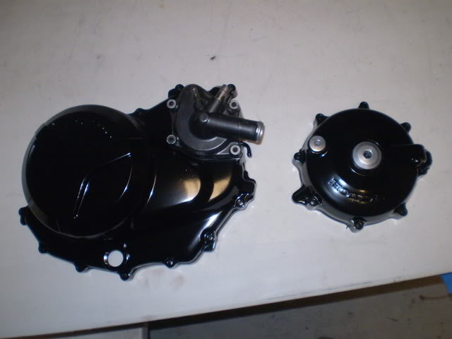

Then cleaned and painted my side covers- I went with a orangish yellow (more yellow than anything) as a highlight color and a dark grey for the frame and main color for my powdercoated parts. Hoping that the standard black components and some of this will make the bike darker so that the yellow pops out.
The black is hard to see in the pictures, but much cleaner than the previous owner had them.
I'm hoping to get the exhaust wrapped in the next couple of days and will be that much closer to bolting everything back together when the parts come in!
