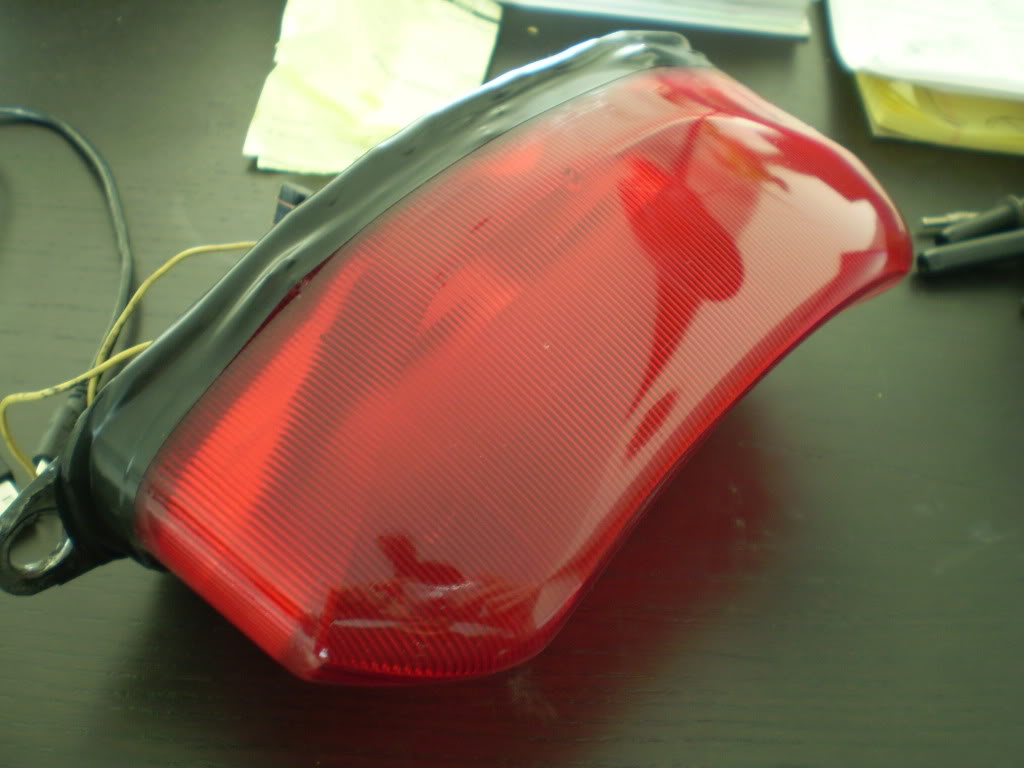

So, another round of color testing. I'm getting close I think. I'm sure now it would be worth the effort to color match the powdercoating on the frame. Add some sort of graphics on top, throw in some of that cool tech spec grippy stuff and cut out holes for venting to the radiator and it should look grood.

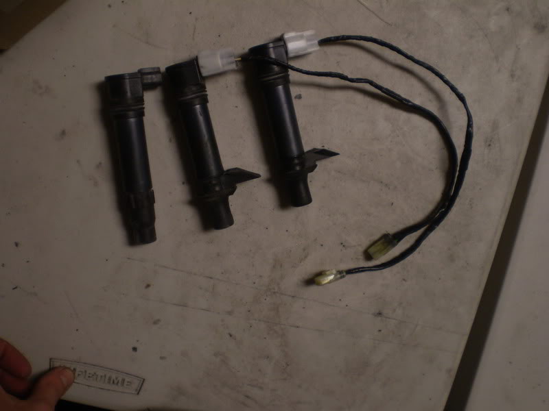

I also got the CBR 600RR coil's in. You can see the original on the left and the modded ones on the right. Chopped the sleeve from the VTR's and wired in the plugs. I'm just adding to the things that can go wrong when I try to start it up

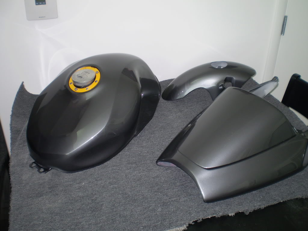

Actually, the last image with the tank and tail in gunmetal looks damned good... I'd say take that, and add a yellow stripe over the tank and tail/cowl and you got yourself a winner...
I'm a fan of anything that shows off the machine rather than tries to overwhelm it, and when I put the frame color on it immediately I knew I was going with that color.
Offroad rider- This forum supported all of my questions and gave me plenty of inspiration so stick around and have fun with it.

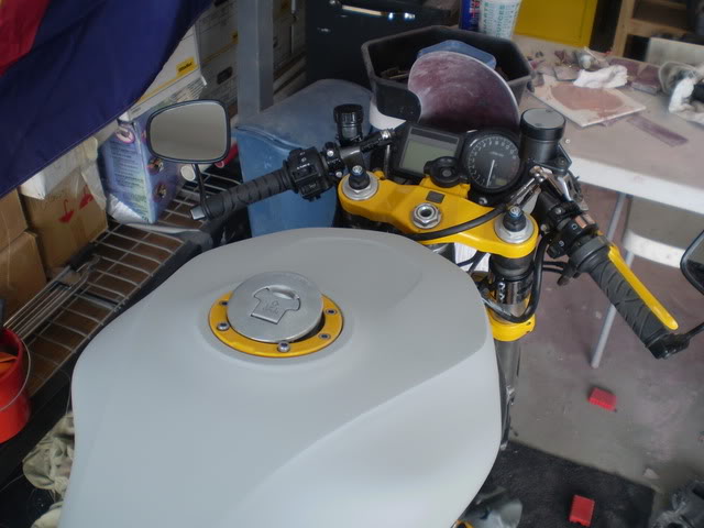

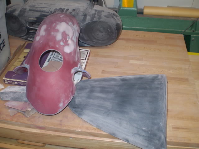

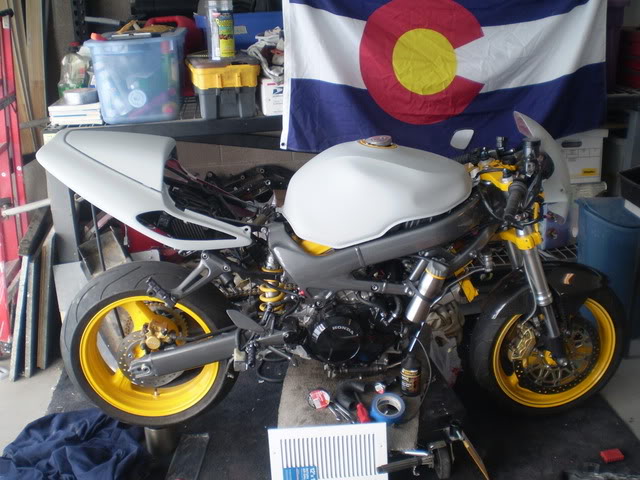

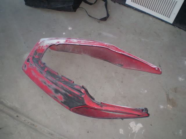

No recent updates because I've been prepping for the paint which is just damn time consuming. I think I'm 40 hours in with just sanding/bondo/primer and minor plastic repairs. I've created a hard line on the top of the tank to bring out some of the cool shapes that the shawk has. Process pics:

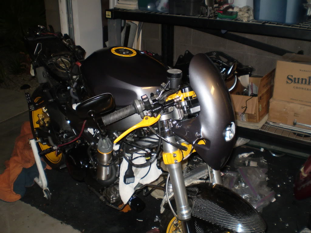

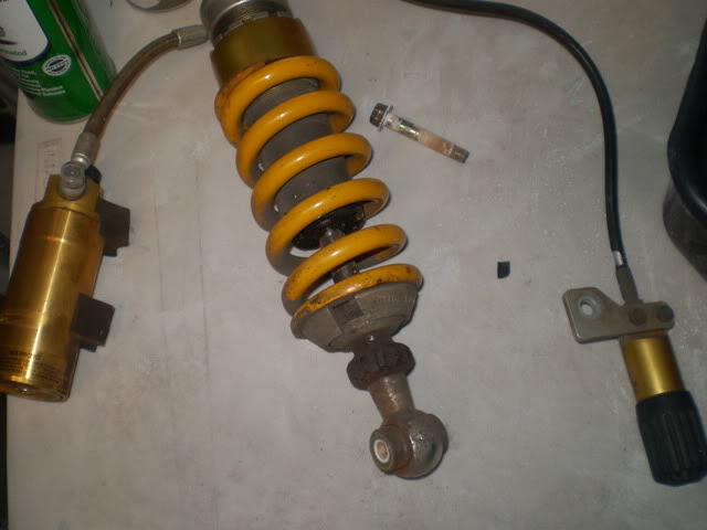

Got the shock, took a pic for a before/after, and got so excited to put it on that I forgot to take an after of the cleaning process. I'll probably get this sprung for my weight at some point and learn how to fine tune my suspension, but for now I'm putting a bike together and it's grounded!
Painting is just around the corner, lots of electrical left and a couple of light mounting issues but hopefully I'l be firing it up soon!

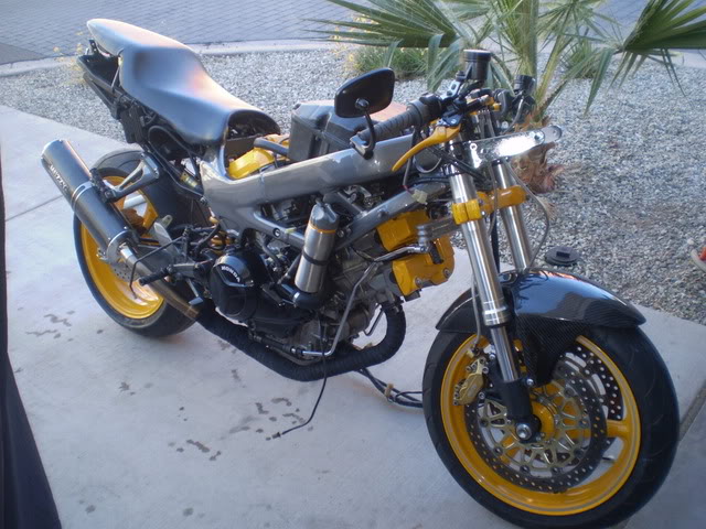

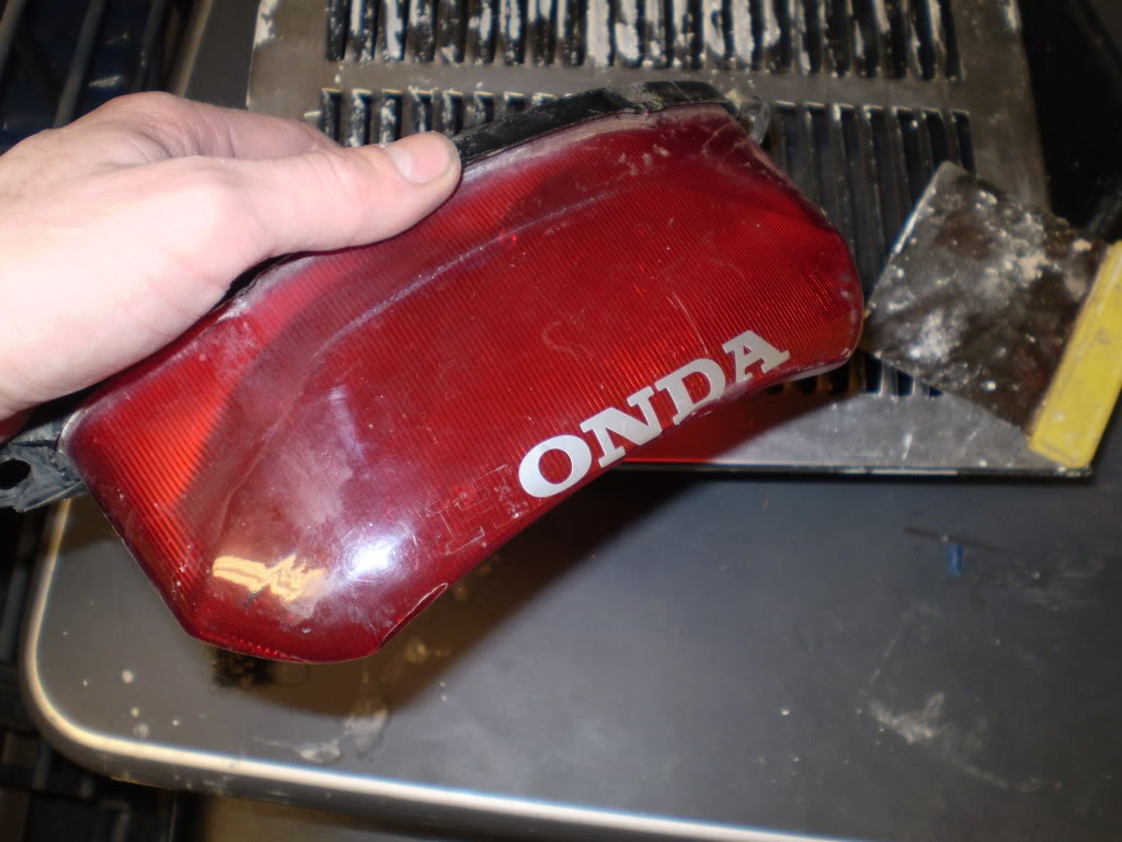

Wiring is almost complete... Just have to figure out how to plug this dern projector in. Carbs are in. Airbox is in. Hoses are 85% figured out... this should get real fun real soon!
Lens coating was shot anyway, so I cleaned this up and put a sealer on it:
Stuck some LED's from a clear alternatives as well so I can get the turn signals

Waiting on the tank still... gotta fill the fluids then I think that I'm ready to test fire this thing!
Is there anything I need to know when starting it after all of this hassle? I haven't wired in the headlights or taillights yet, but I'm pretty sure I can at least get it idling and make sure I don't have any huge changes to make. Possibly try my hand at synching the carbs too...

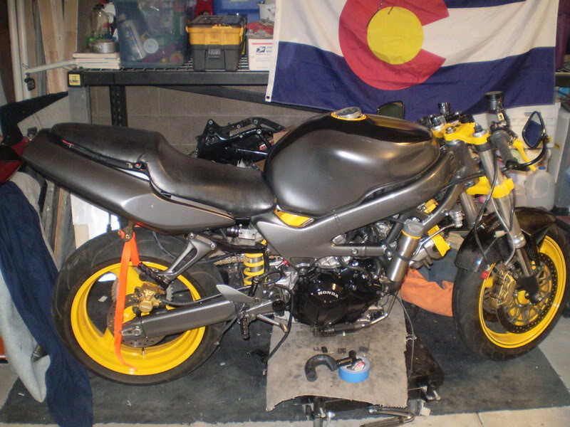

Paint! That is all. I have to go back to work. One day soon I'll have enough free time to assemble.

Old Apr 13, 2011 | 08:02 PM
  #168

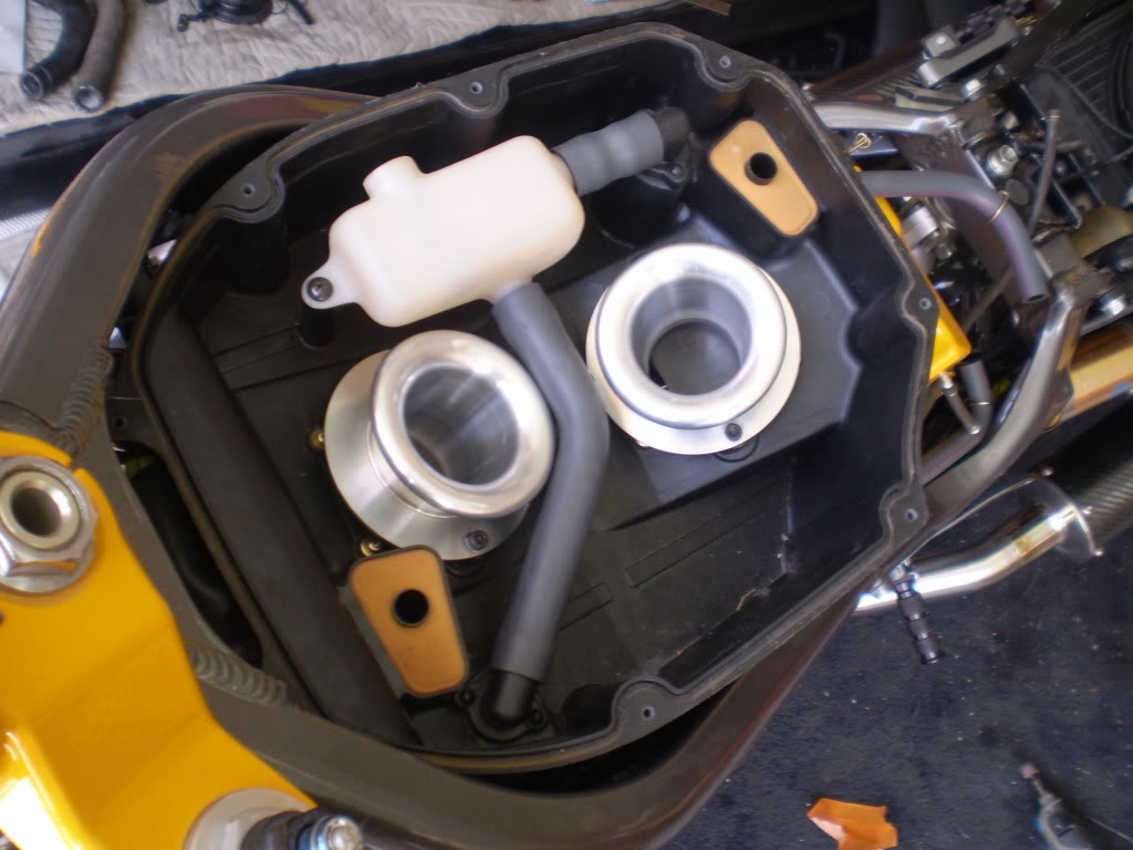

Teasing myself. Remember, there are no motor heads underneath as my valves are getting cleaned, but this is where it's headed. I also have to actually mount the stuff rather than set it on top haha!

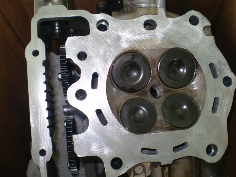

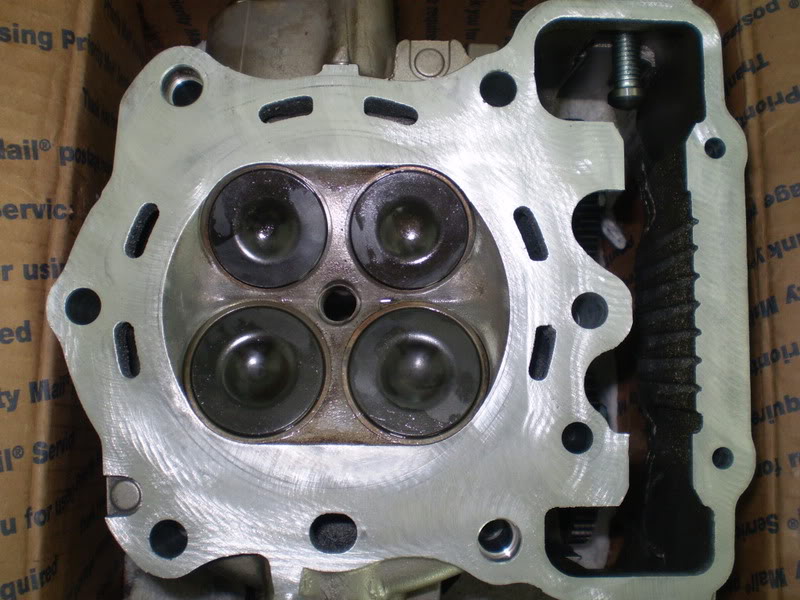

Ok, so these guys are all cleaned up, new valve seals cleaned surfaces, etc. The were all good, nothing needed to be re-ground. Which is good, but bad- I'm still not too sure what was/is causing the low compression in the front cylinder. I'm hoping this did the trick, but it would be a huge bummer if there is an issue with the cylinder rings or something. I'm tentative about bolting these back on in case I need to do more....
Old Apr 19, 2011 | 06:54 PM
  #173
nath981's Avatar
Posts: 2,934
From: altoona, pa
well it seems like if it was using oil or you can see some evidence of blow by, you might otta slap some new rings in there since you're down that far. Then when you get down that far, you might otta balance the crank and install some new bearings.
Old Apr 19, 2011 | 10:25 PM
  #174

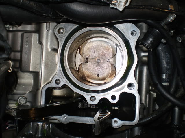

Well, the thing is, as far as I can tell, I have to remove the motor to do this- it's a mental thing at this point... I'm supposed to be rebuilding!
There's a possibility of bad rings or maybe a couple other things- wet compression test said otherwise, but you never know...
I'm going to go with the original diagnosis; valves seating poorly causing low compression. It still seems like this was at least part of the issue, and may be the whole thing. There were signs of a bad gasket as well, although, again, I'm not positive on this. The motor didn't eat oil so not too sure about rings... maybe I'm just talking myself out of getting into the motor more... this could be a project for later and I could try to get this damn thing road worthy!
Wiped the pisons off via 8541Hawk's advice- worked way better than I'd envisioned:
Going to try to bolt the rest together tomorrow and get it running. Crossin my fingers!

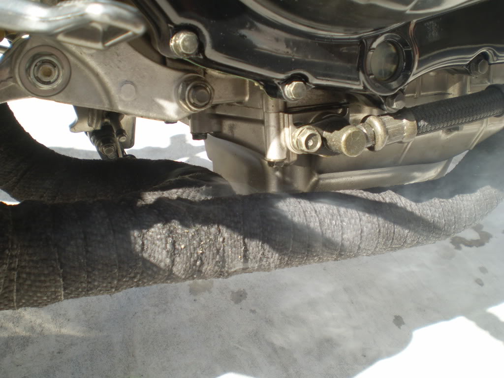

Houston....
We have full compression.
I am so dang excited that I won't use an exclamation point in any part of this post. The sucker just purred... no complaints anywhere. Front exhaust wrap was smoking (as the silicon gets baked- will only do this for the first 30 minutes or so of riding if it's supposed to) Rode it around for 10 minutes to warm it up, did the test and it's at like 162. Couldn't ask for more from it right now... I was already getting worried from how things were leading up to it.
Thanks for the help everyone- many contributors to diagnosing the issue. I still need to make a headlight/fairing mount and several boring but time consuming things, but the rebuild is back on track
