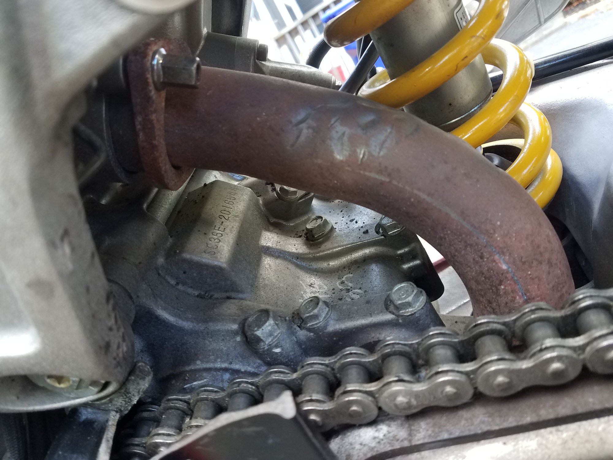

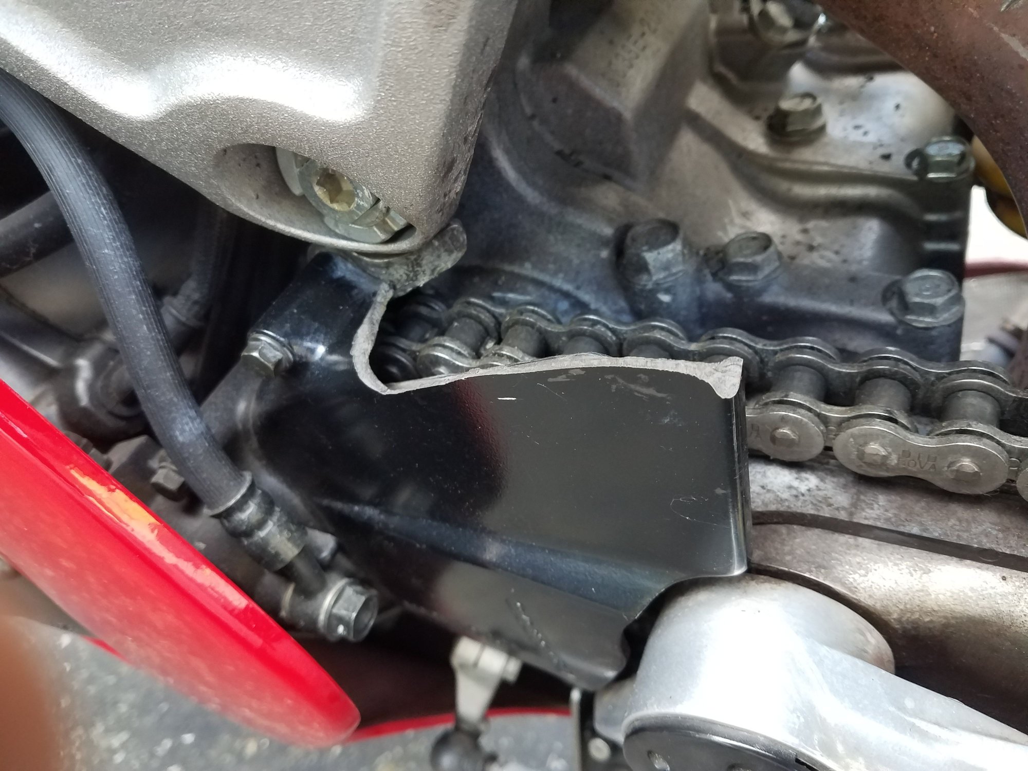

There are some very strange marks on the rear header and the chain guard is snapped in 2. Looks like she threw a drive chain at some point in her life. I'll be looking out for some new headers. The bike has Jardine slip-ons but I would stay with stock headers so I don't have to re-jet.

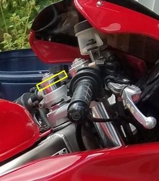

When you get it back on the road you might want to look at how the forks. It looks like the PO has them pulled up quite a bit.
The snap ring (in yellow box) is normally seated directly above the clip on
