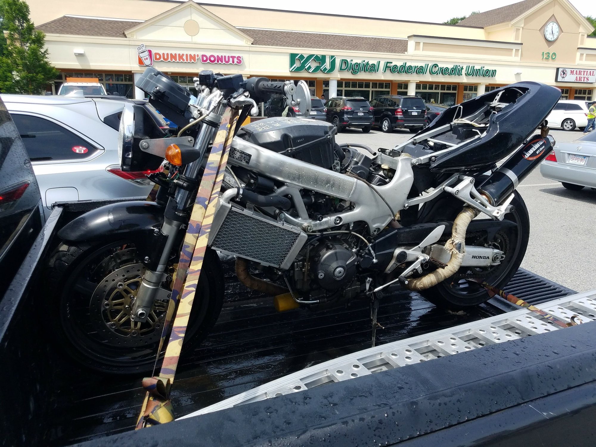

Hi All, Just picked up a new to me 98 VTR that is in need to some work. I bought it off of my boss, he hadn't ridden it since 2010 and so it only has 16k miles.. Thankfully he had drained the carbs, although there was still some fuel still in the tank that is super skunky. The owner before him had turned the bike into a street fighter style, so no fairings, a single round headlight, and a set of renthal bars instead of the clip ons. Also came with a nice corbin seat. It isn't the prettiest bike, but it is somewhat setup for a taller guy like me, and the price was right.
The above was after a quick spray at at the car wash, it was pretty dusty sitting in his garage for the past 8 years. This is my second bike, with my first being an 81 Honda CM400, also a twin, just not a V-Twin. I have more or less finished getting that bike back to being road worthy and looking decent. Here are the two together after getting home:
First order of business is getting the VTR running. I have already drained the coolant and pulled the carbs, maybe after work this week I can get the carbs separated and cleaned up. After the carbs, all the fluids are definitely due to be replaced, and I need to clean out the tank. Does anyone have any recommendations for cleaning out the tank? Are these tanks lined?

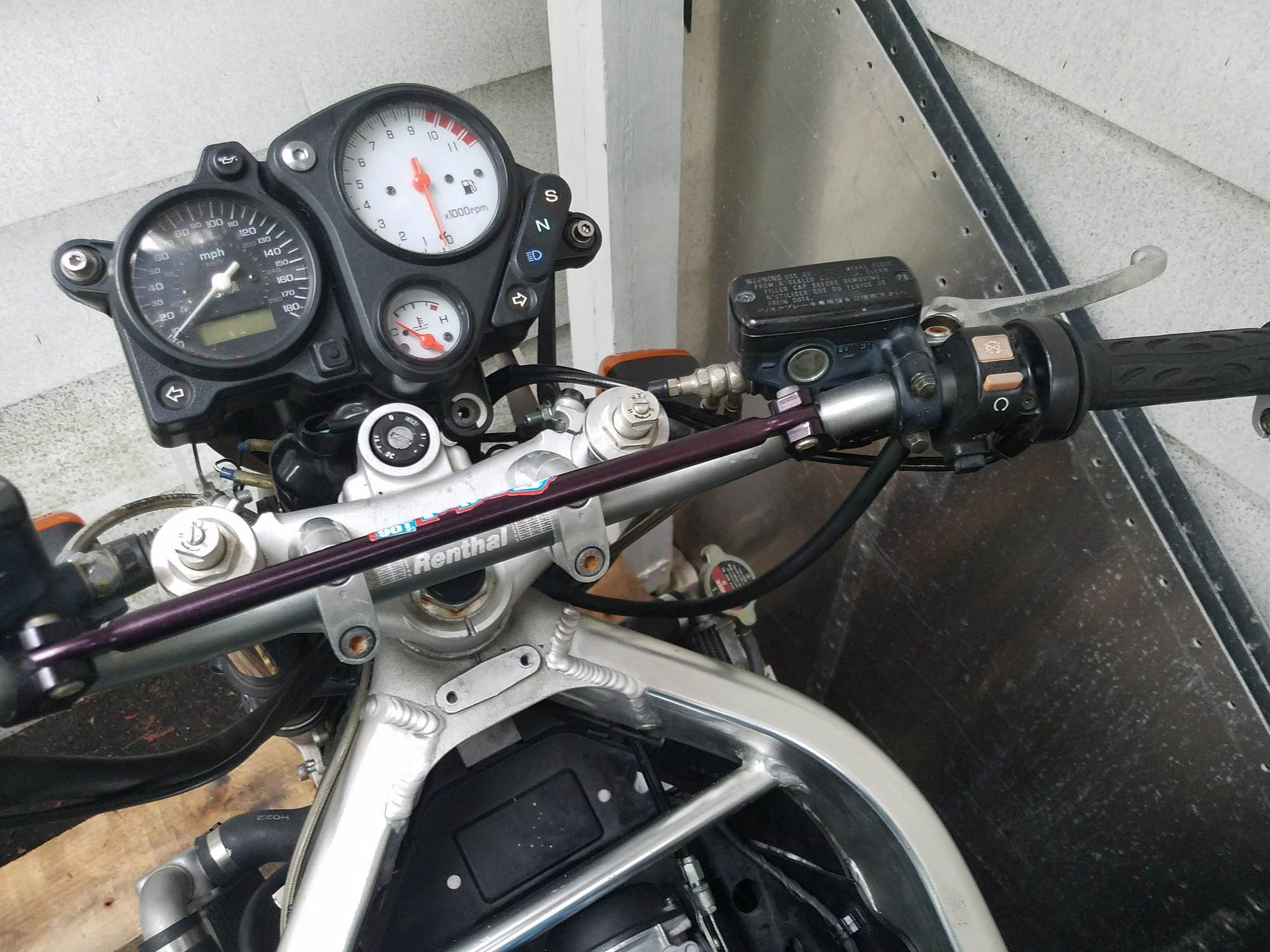

I also had some other questions, can anyone tell me if these have the stopper mod done to them, the previous owner before my boss said they were done? Some places I see say that a set screw needs to be tapped into the side, which I don't have, but most pictures don't show there being a bolt at the back of the CCT like I have?
Also, is there something that is supposed to go on this nipple on what I assume is the thermostat?
And my last question for now, any way to tell if the suspension has been modified without taking apart the forks? I was told there might be something done, but he wasn't sure what.

Welcome! Looks like you have some work to do, but a decent foundation.
Those are the cct's you want to get out asap, and replace with manuals.
No need to separate the carbs to rebuild/clean. Be very careful, I suggest doing one at a time. Jets are different and easy to mix up.
No way to tell if there was work done to the forks unless you pull them apart. Which you should do anyway. I'm sure the fluid in there is toast.

[EDIT] Looking again online, it may have the stopper mod done and nothing is seen on the outside, I guess I will need to check either way.
If and when you pop open the forks, share a pic of the springs and spacer. We can tell if stock.

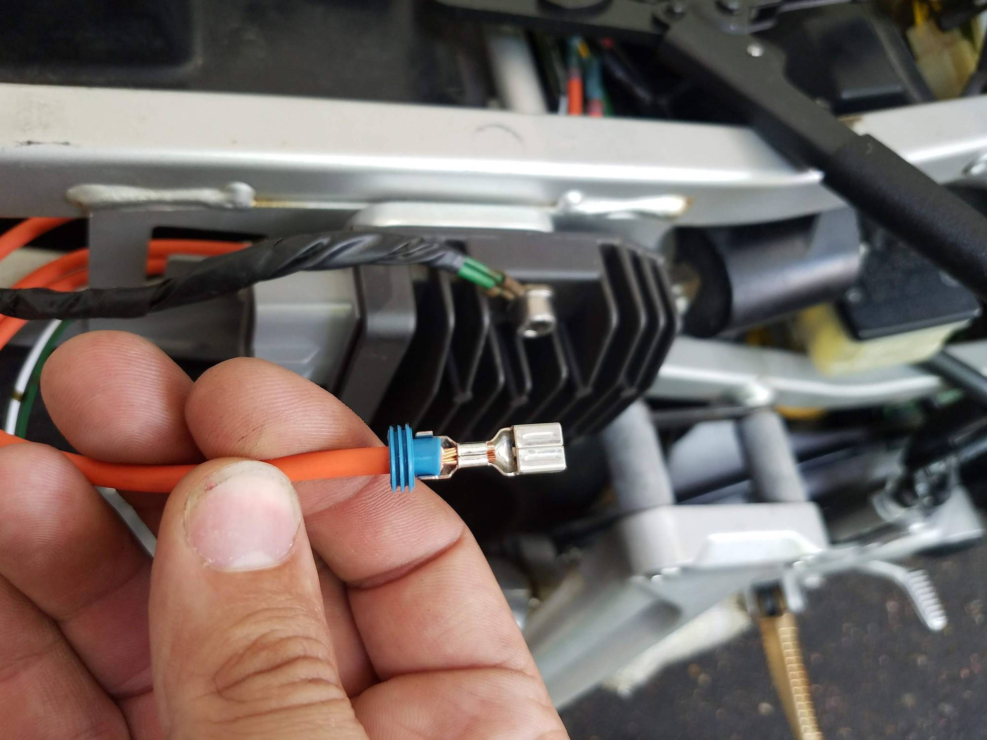

Got all the carb parts on order, bought a FH020 R/R with the connectors and crimps as well. I inspected the gas tank, and while it was mostly just nasty varnish and stale gas, there was a verrry small amount of rust down near the petcock, so I decided to go all the way, and ordered the cleaner, prep and sealer for the tank. Next thing to tackle while waiting for all the parts to come in will be inspecting the brakes, and doing all the fluids.

With the R/R installed, and the carbs and tank straightened out, I was able to get it to fire up. It burned a bit of oil when it first fired up, but cleared up as it warmed up. I am guessing most of that was just due to not having been started in 8 years. Got everything installed tonight, but again forgot to take pics. Hoping to sync the carbs and adjust the idle mixture this weekend and take it out for its first trip in 8 years. Getting excited, it sounds great, although a bit loud, I will see if I end up keeping this exhaust.
