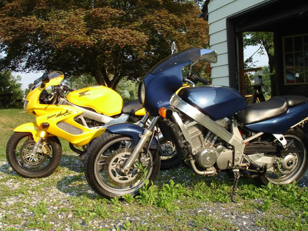

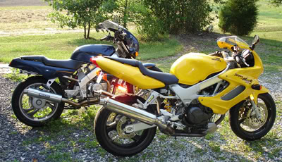

Hello and welcome to the forum bobby! I can relate to your owning the NT. Here's a pic of mine when I first bought the VTR.

One thing you will notice on the long haul (vs. your GT) is the difference in weight. Take some pain relievers along!! That's one helluva ride you have planned. Hope you take some pics along the way so you can share some of your journey.
