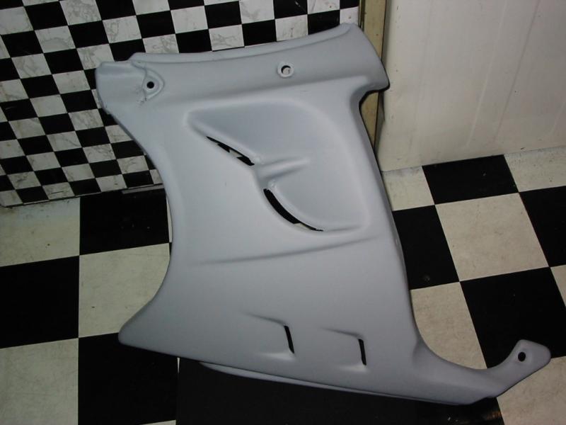

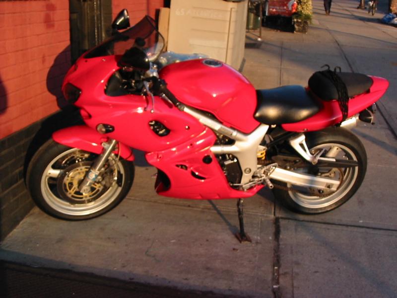

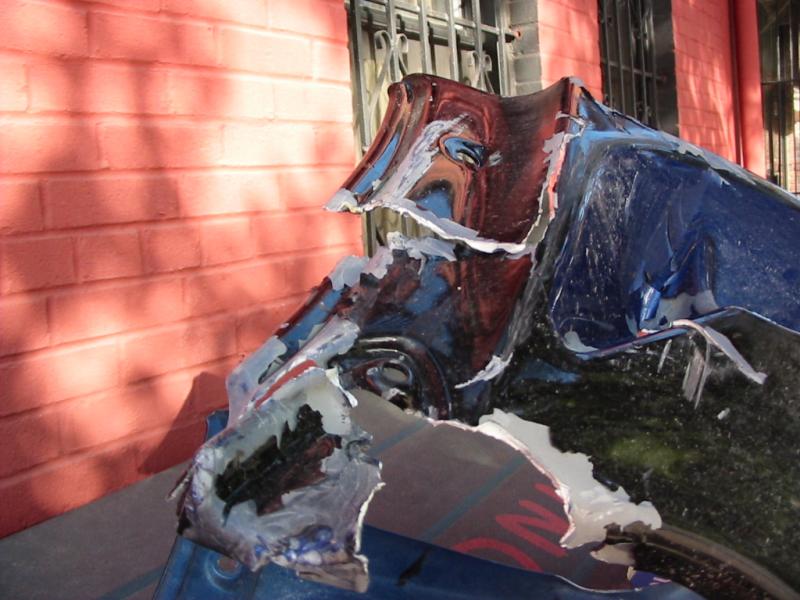

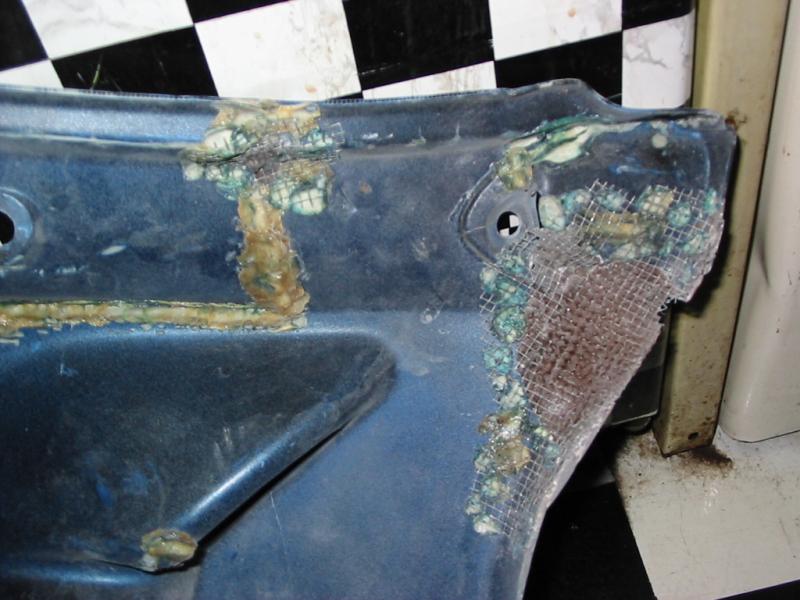

That stuff is interesting but $75 seems like an expensive tab. I have re-built entire bikes with abs weld rod and the whole role cost me like $20 & I have most of it left.
It turns out abs is thermoplastic, so it can be turned molten and back & retain its properties. Look on youtube but a good 100 watt solering iron and some homade "feet" to feed the rod thru and you can rebuild the stuff by melting steel mesh into it and forming abs around it.
I bought the welding rod here http://www.mcmaster.com/#plastic-welding-rods/=bsnvcx
and also fixed very broken givi luggage with the polypropelene rod.

i'm speechless. i'm doing what i thing are real slick repairs and then i see stuff like this. a massive amount of ingenuity and talent on this list. cool. that first picture of complete carnage... i can't quite make out what exactly i'm looking at.
