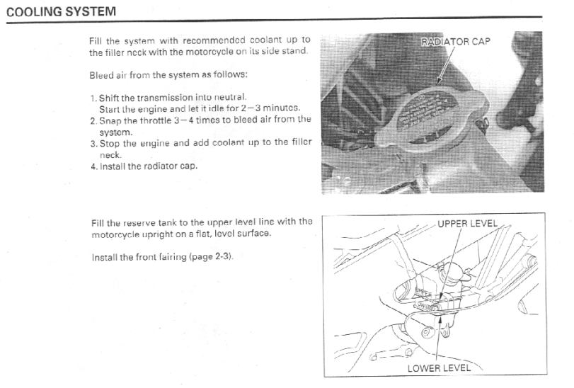

Questions: (because I could not download the manual) How do I know when I've added enough coolant to replace what was lost?

#1 Are you sure it overheated or was the coolant tank too full?
#2 Bust out the multimeter
Yellow S light is the sidestand.
There are two lines on the coolant reserve tank, UPPER and LOWER. Fill until the coolant is in between them.

Check out the second post here, this is how I'd start:
https://www.superhawkforum.com/forum...n-noise-25966/

Awesome, thanks for the diagram. I really don't think the pump or thermostat is broken. I just had it sitting there for too long at idle, no wind, hot humid day. The sensor very well might be broken, in which case I'm just gonna throw a toggle in the loop.
