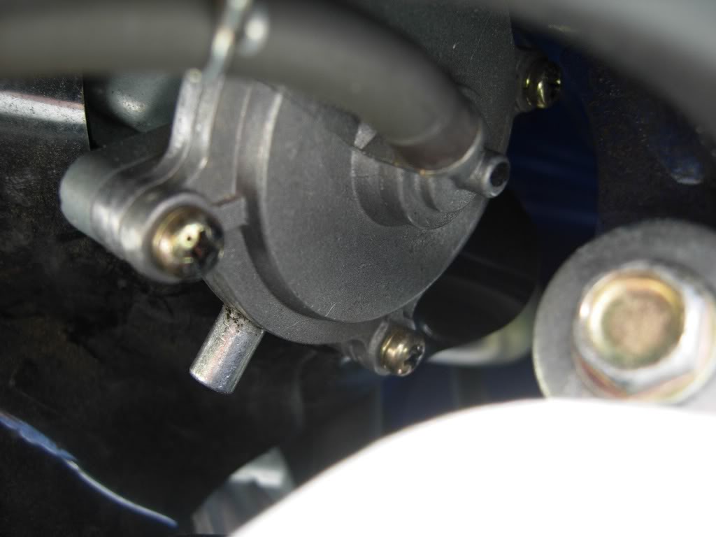

Old Sep 5, 2009 | 05:00 PM
drew_c14's Avatar
Posts: 2,455
From: Williamsburg, VA
the petcock should be hooked up like this, not with the tube on the bottom
Ahhh so the small grey hose goes in the back? And that one pointing downward should be left open to vent? Think that was my problem after reinstalling fuel tank...
Old Mar 27, 2013 | 05:57 AM
See your other thread running for a picture.. But yes, bottom is a vent, back is the vac port for the line.
