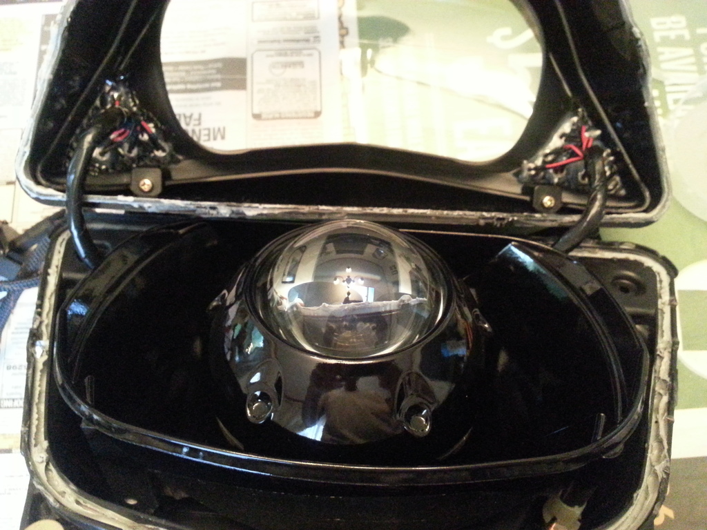

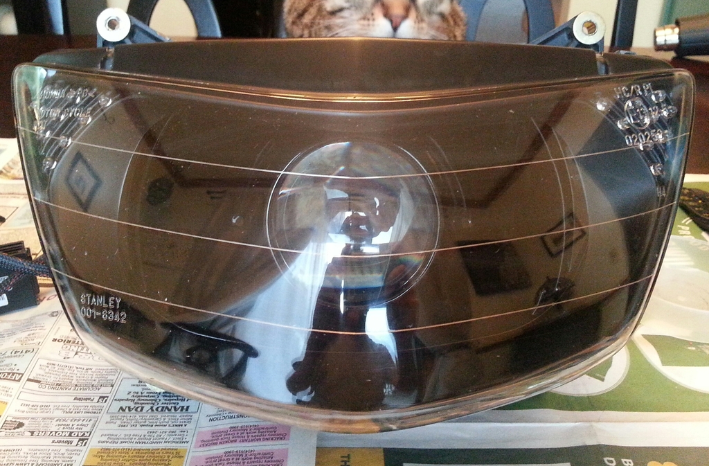

So, your headlight has a projector inside the housing, like this? If not, you just have a HID bulb in a housing that is not made for that type, like you mentioned.
Oh, sorry if that was unclear. Yeah, his conversion is not a full retrofit, it's a bulb conversion, but the ballast is already installed, so maybe that might save me some work if I decided to go that route... Or, it might not.
I honestly don't really know where to start with a full retrofit conversion like this one. I'd need to do a lot more research before taking that leap. Is it street legal?
(...on further thought, I realize the answer to that question may vary state by state.)
