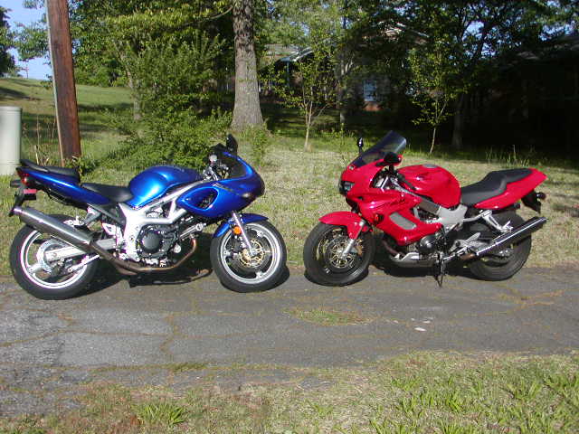

I'm John, I've ridden an SV since '02 but always admired the VTR and knew it would be my next ride. Found a '98 with 4500 miles and gave 3500 clams for it. It looked to be without flaws, and a ride up the street revealed only a late clutch and mushy brakes. I flushed and bled when I got home and problems solved. I discovered while changing the oil that the bike had been bottomed out and the front header was crushed in(the chin spoiler hid this). I took it off and my local muffler shop did an awesome job of pulling it out. Much to my relief as Honda is very proud of this piece of tubing. When changing the oil, I couldn't believe how much oil I was putting in. My SV holds just shy of 3 quarts. After adding 3 quarts and not evening coming to the window, I started dumping in all the partial bottles I had-still low, so I then opened a 4th quart and poured part of it in before I got it right. Does anyone know off hand what the capacity is with the filter change? (bike came w/o manual)
On my first long ride I came out Warwoman road with the fuel light on so I stopped in Clayton to gas up. My *** was clammy so I grabbed a redbull and chilled for 7-10min. When I refired the bike I almost panicked. The bike was making a knocking/pinging sound kinda like a bad lifter on a car motor. It was very noticable and wasn't going away. I thought I'd bought a lemon and the motor was about to let go. I got on 76 and started home. It's a long highway so I rode without slowing for a long stretch. When I arrived in town, the knocking was gone. Since then it's done it a few more times, never on a cold start, just when parking it hot and restarting a few minutes later.....tick-tick-tick-tick-tick. Does anyone know of this? Lastly, and this is kinda embarrasing, how do you adjust the preload and dampning on the forks?
This forum is loaded with great info and will be a huge asset in the near future when the mods begin. Thanks- John

Nice buy
You should be able to find the owner's manual on this site in pdf format to help you with oil and forks, but the noise may be the auto CCT. Do a search for APE Manual CCTs on this site as that may fix your problem...
Good luck bro,
Rick C.
