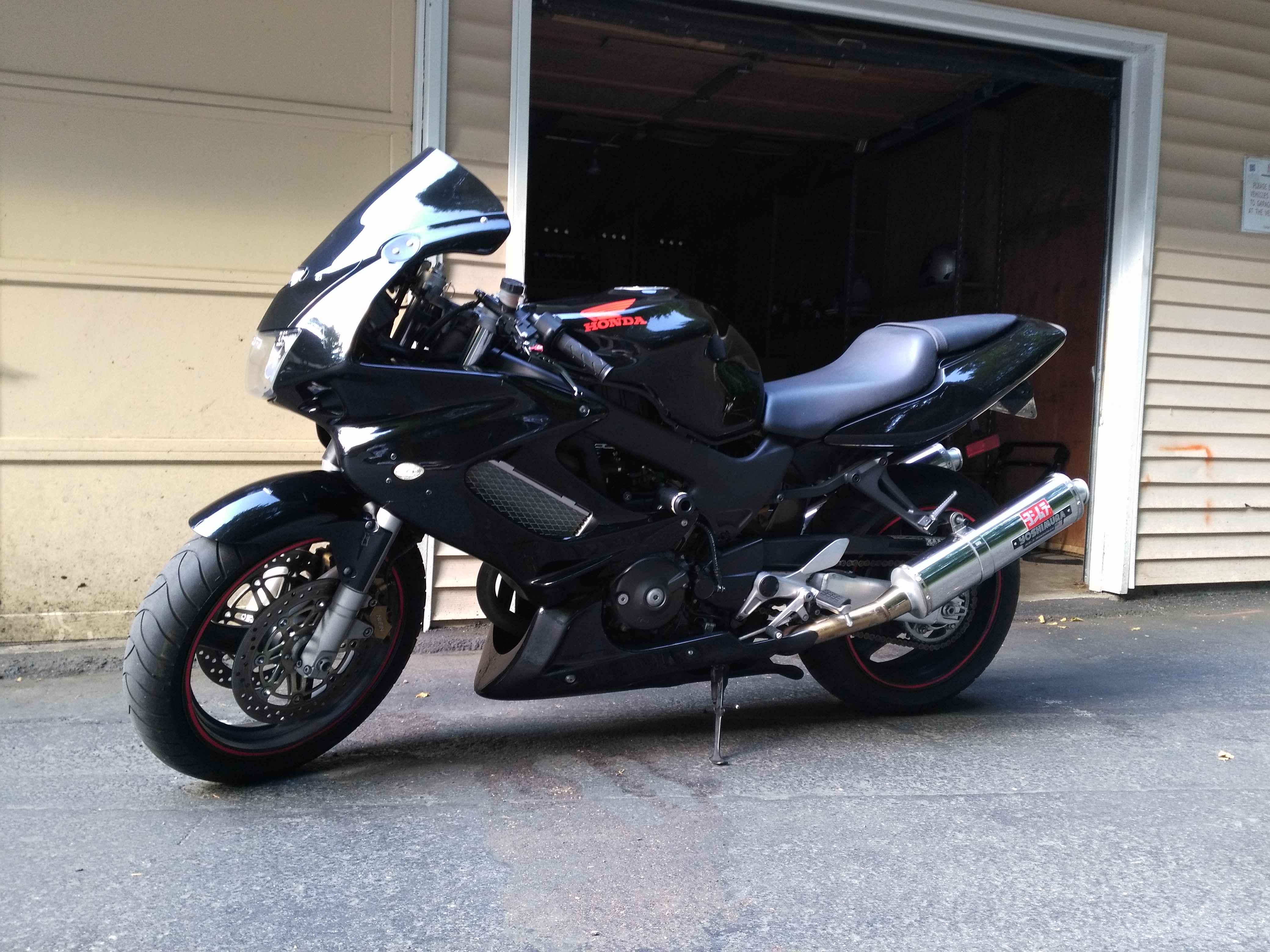

I wanted to make a quick update on this old thread. It turned out that the after everything I did above the bike still didn't run; it would continue to die as it heated up. But, 7 months later, I'm happy to announce that it is officially fixed; for good this time. I had given up and was days away from taking my bike into the shop when I figured out the problem; sort of by accident. My father and I were working on our project bike and looked up how to test a pickup coil. The video we found happened to outline EXACTLY what my problem was: runs fine cold, dies as it heats up. So, I replaced my ignition pulse generator and...well...it was better but not fully fixed. So, sort of a shot in the dark, I decided to replace my front ignition coil and VAULA! It rides like a dream now! I rode over 100 miles today and it never died! I was too busy chasing what I did wrong in my MCCT install that I didn't even consider that it could be something completely different. It was just unfortunate that it decided to crap out right after my MCCT install. So, I hope this helps someone in the future. Here's a tribute photo of my black beauty.
Attached Thumbnails Last ditch effort before taking it to the stealership...-img_20170715_173615.jpg
