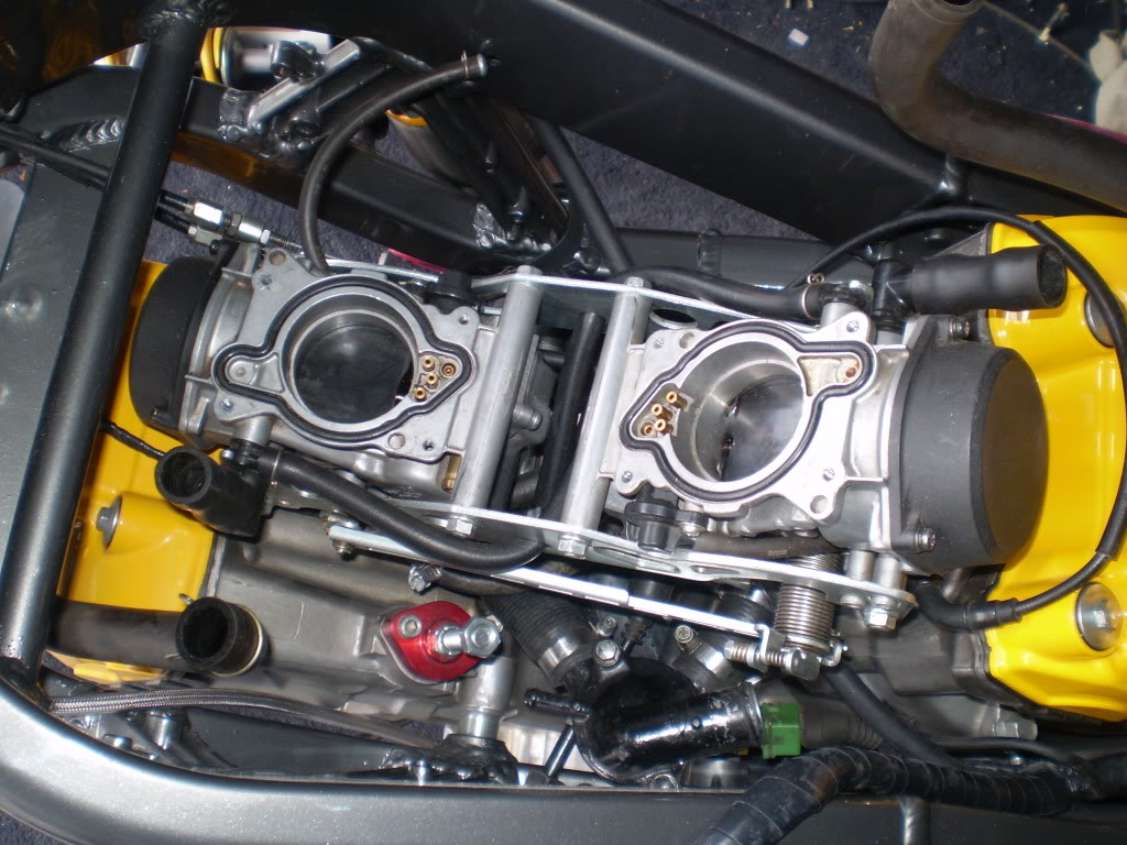

I don't think that it's easy without getting into the carbs. You "may" be able to tell if it's a DynoJet kit by pushing the carb slides back to see how many holes are in the bottom. These are the two black slides that are in the channels that the airbox attaches to. Push the black thing up... Stock carbs have three holes, the middle one has a long needle going through it. A dynojet kit setup will have an extra one drilled in the slide.
You can see the two black slides in the circular holes here (just put your finger in them and slide them back:

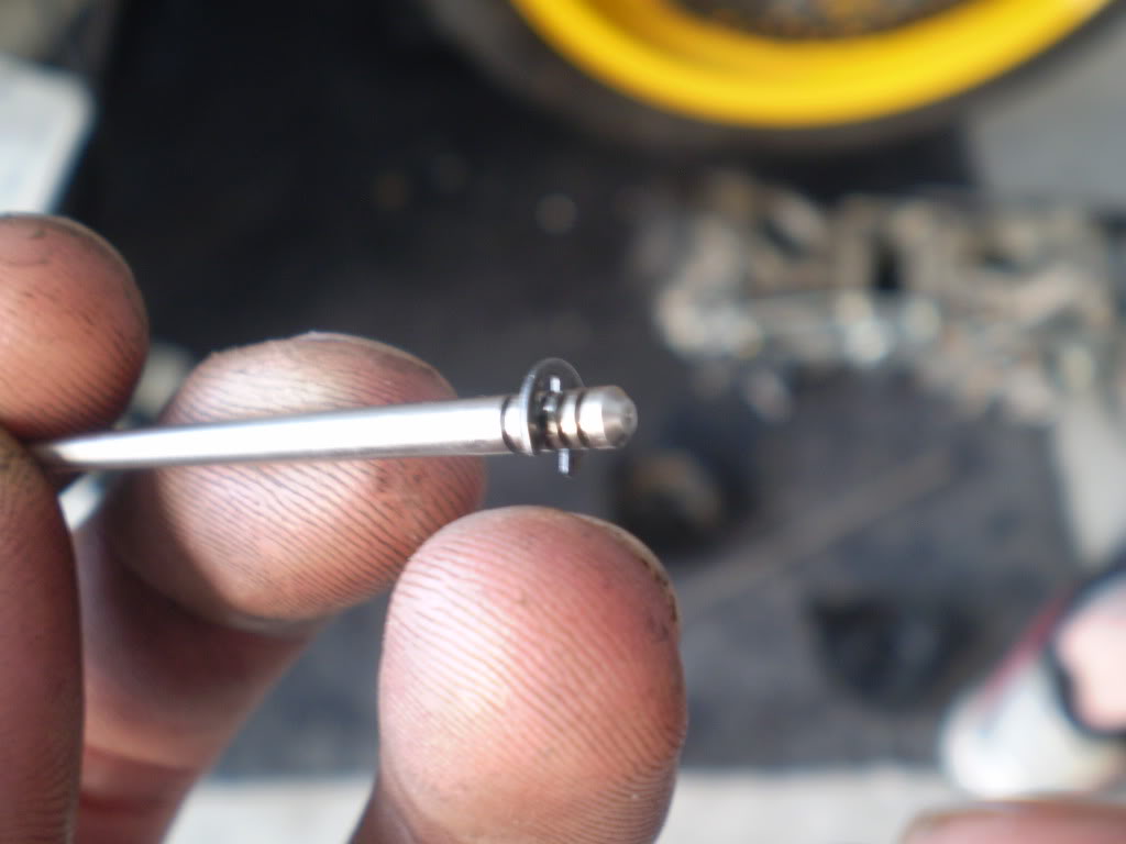

Other than that, you'll have take them apart a little and inspect the needles and slide springs. Jet kits have adjustable needles:

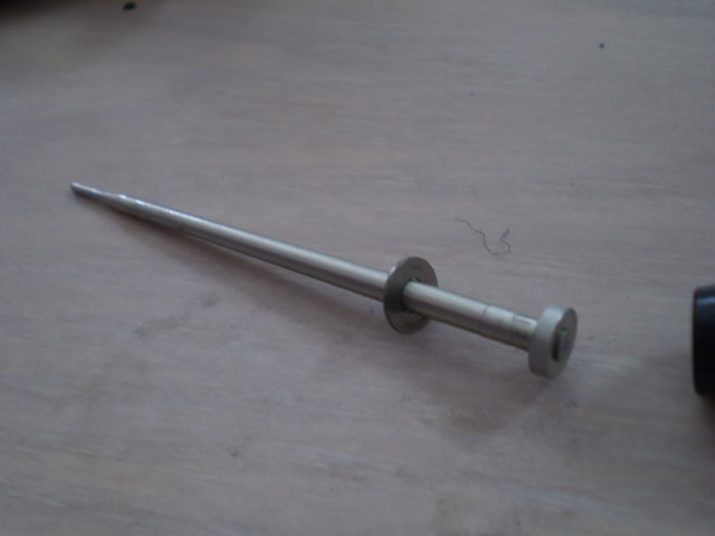

Stock jets use these needles:

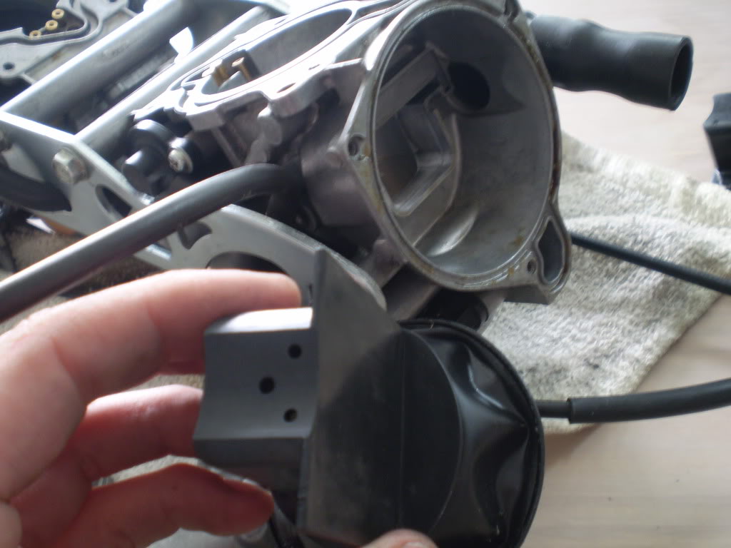

And the slides have 2 holes+one needle hole:
