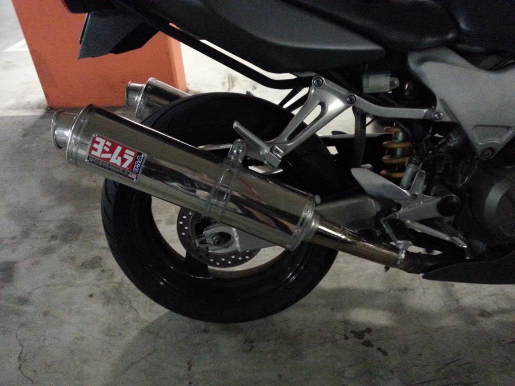

I have aftermarket yoshis on my VTR, but they are much higher pitched than the Kerker exhaust on my old VTR, which i sold to my mate greg.
I was wondering what the trick is to dropping the pitch? Not aiming to make it louder because the yoshis are loud enough.

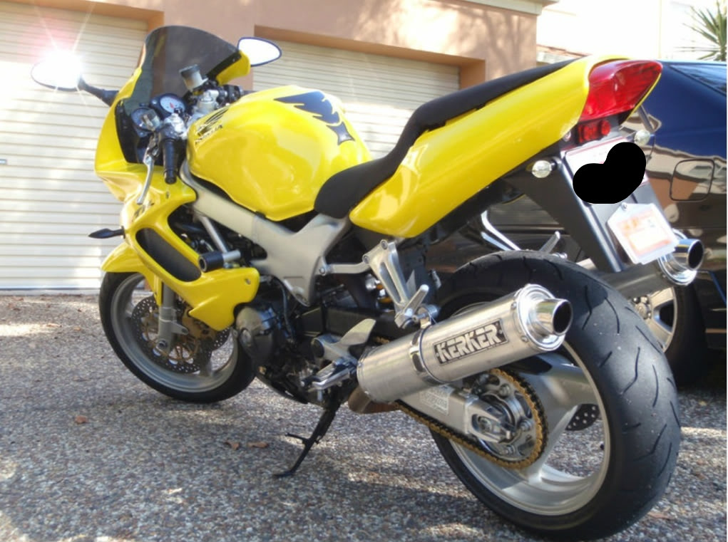

Old bike with kerkers

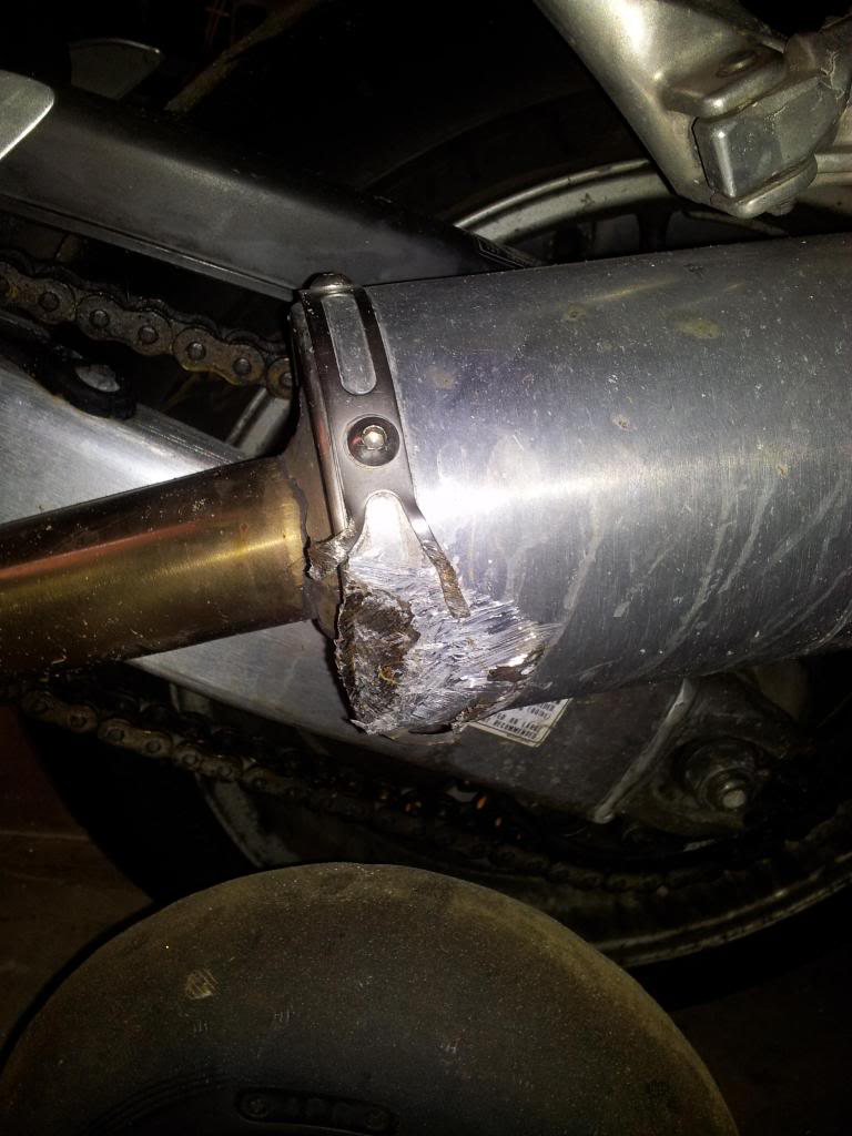

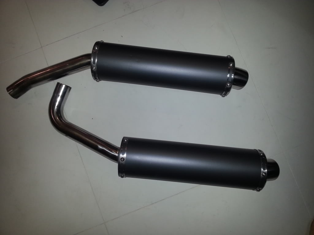

So i got the kerkers back from greg. looked like this...

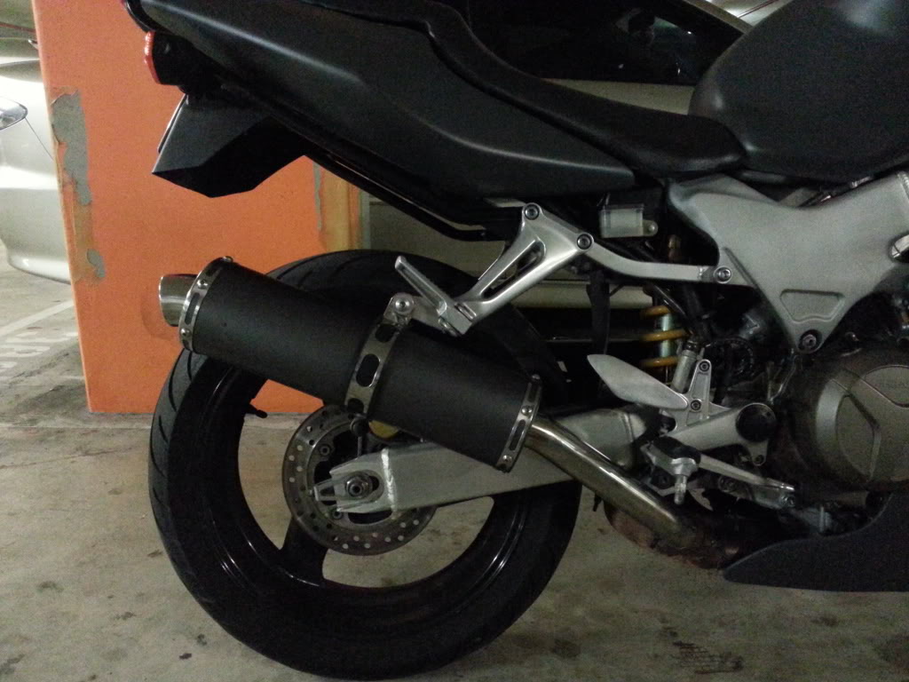

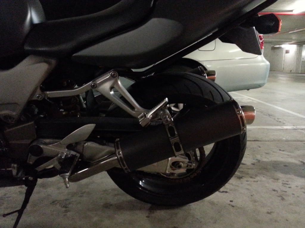

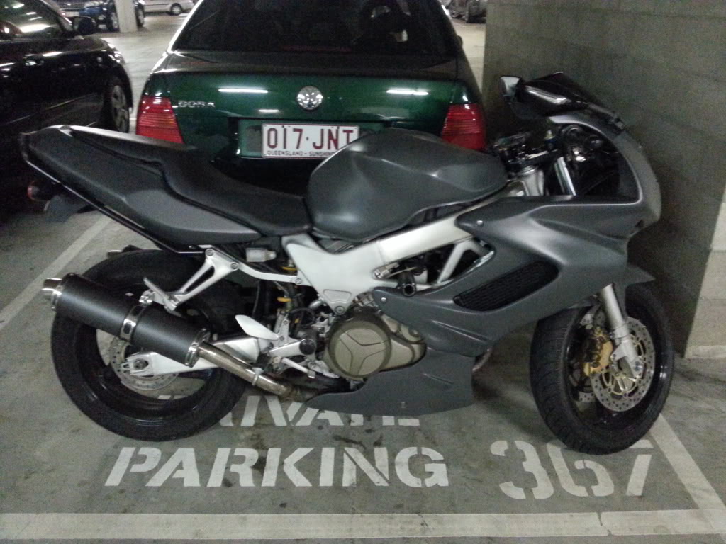

So i shortened by 6cm and painted them hi temp metallic charcoal.
They sound much nicer and bike seems to have more low-rpm power too.
